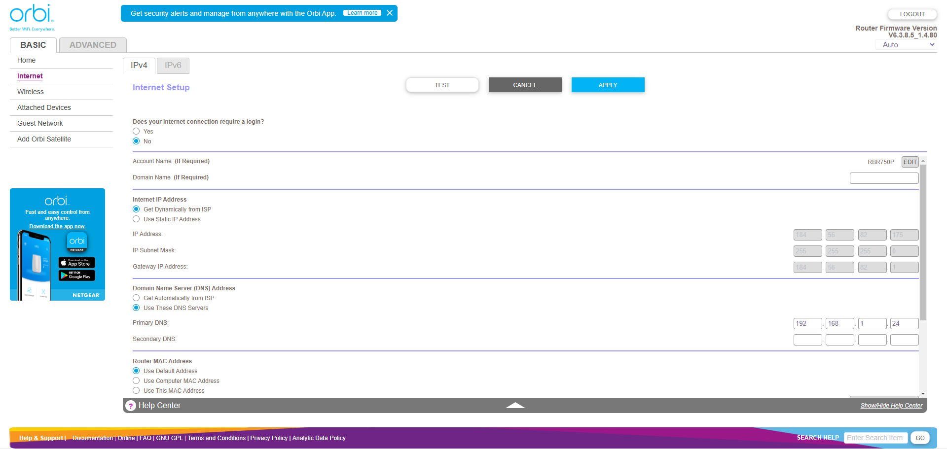

Here ar the settings for that area on my router

In the router setup for DNS address, it says manual assignment.
PRIMARY DNS 192.168.1.24
SECONDARY DNS blank (saw somewhere that I should either do that, or put the 192.168.1.24 in both.

You set the DNS on the WAN/Internet configuration. This is a valid configuration.
The devices will use the router as DNS server and the router will use Pi-hole as upstream DNS server. The only downside is the router will be the only device showing in Pi-hole query log, but some routers doesn't support a different configuration.
