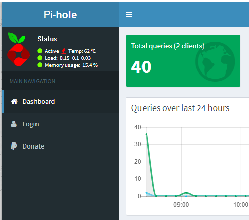

Ah, one last issue. When I reboot the machine running pihole the web admin page says "Failed to connect to API" running sudo service pihole-FTL restart solves the issue, what would case pihole to not start the pihole-FTL service on boot?
When it fails what's the output of sudo systemctl status pihole-FTL.service
Active: inactive (dead)
What are the contents of these log files when it has failed?
/var/log/pihole.log
/var/log/pihole-FTL.log
Looks like Pihole is running fine still see my PC actively being blocked.

[2018-05-16 17:09:58.817] ########## FTL terminated after 45.2 ms! ##########
From the FTL log, something told it to shut down. So somehow it is getting told to shut down about 10 seconds after starting.
