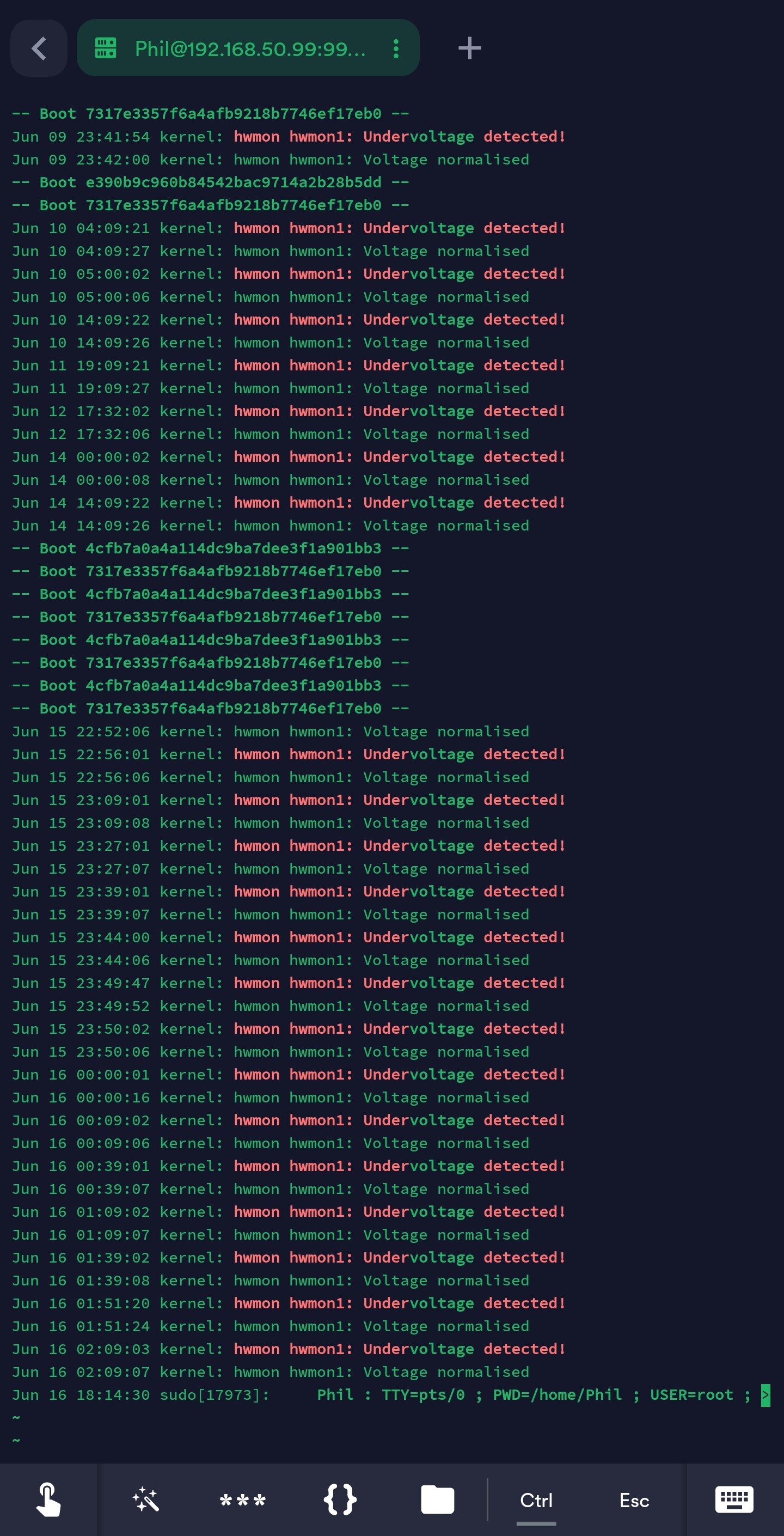

Could search all of the systemd journals with below for "under-voltage" messages:
sudo journalctl --full --no-hostname --pager-end --grep voltage
Hey I'm not sure if pi was accessible during the outage ill be sure to check next time.
I searched for the under voltage msg and found it during those times but also today when I've had no issues. Does this indicate a bad power source? I'll have to double check but I'm pretty sure it's connected to my PSU.
Yes.
Or a bad USB cable for power.
Or too many power hungry USB devices connected.
