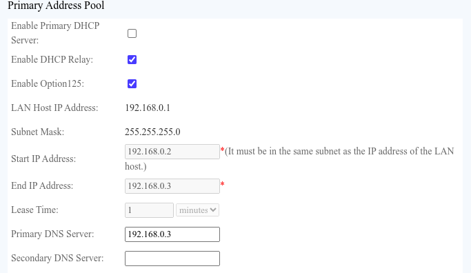

previous dhcp config on router was
not sure if that may introduce the trouble? :thinking:

How did you give Pi-hole its 192.168.0.3 address? In the earlier post I suggested using nmtui to configure it manually as a static IP, and ensure the DHCP pool range doesn't overlap.
In that screenshot you've posted it looks like it was previously done by having the router's own DHCP allocate a single address, and presumably this would be reserved for Pi-hole, and Pi-hole would be configured to use DHCP. And that's why that screenshot looks like that?
If you've configured Pi-hole to have a static IP this time, the router's DHCP is no longer needed and should remain switched off. Pi-hole will always have the address 192.168.0.3 because it's been manually configured, and all the other clients will get an address from Pi-hole's DHCP pool.
the initial aproach was to get the router with dhcp from .2 to .3, where .2 was my laptop and .3 the pihole, so incase internet connection was lost or dhcp still not working, im still able to access the router settings without hard-reset the router. i was algo setting those ip by static ip using device's mac. now that static setting is no longer present, also router's dhcp is no longer active.

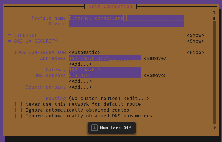

i set the 192.168.0.3 with nmtui as:
Ace, thanks for confirming. That looks perfect. The Pi-hole will keep using that address for itself. I suspect the adlist issue was a coincidence, as everything in your debug log looks great now.
