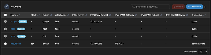

When I try to compile this I'm getting the error: Error response from daemon: Invalid address 172.20.0.7: It does not belong to any of this network's subnets
Help? Please?
