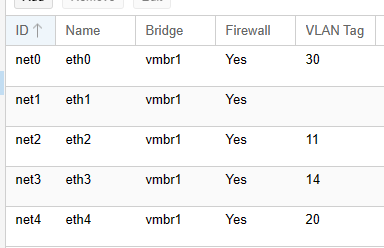

The next container I created was for Pi-Hole. On this container I created a network adapter per VLAN with static address and VLAN tagged. Only one gateway was configured on the "Server" VLAN to keep things simple.

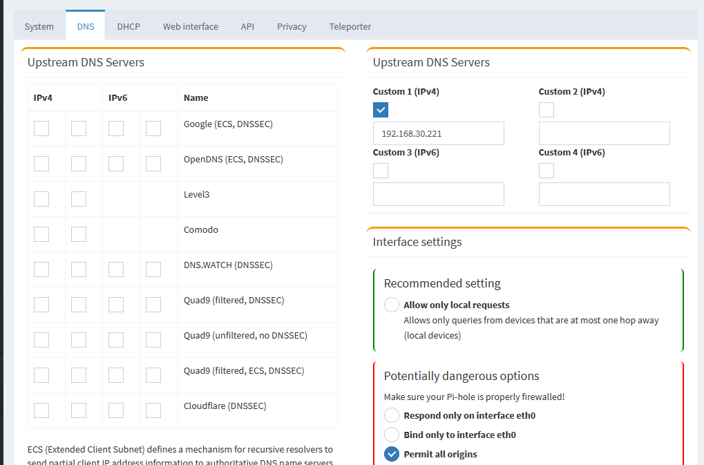

I used the same Debian base image for the container and installed Pi-Hole using the script. I then configured the DNS source of the Pi-Hole to the address of the Unbound network adapter in that container and set listen on all origins. Each network interface in the container ends in 222 (192.168.x.222) that way the DNS address is consistent on all VLAN's.

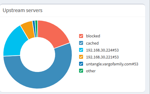

Just wanted to give a updates on the project. I did stand up the DNScrypt proxy as another container on Proxmox. I configured Pi-hole with Custom 1 pointing to Unbound and Custom 2 pointing to DNSCrypt Proxy. After a week it seems to prefer going to DNSCrypt Proxy. As I understand that DNSmasq will will us the response time of the upstream DNS servers and use the one with the lowest latency. That seems to be what I am observing.
192.168.30.221 is Unbound
192.168.30.224 is DNScrypt Proxy in DoH configuration
