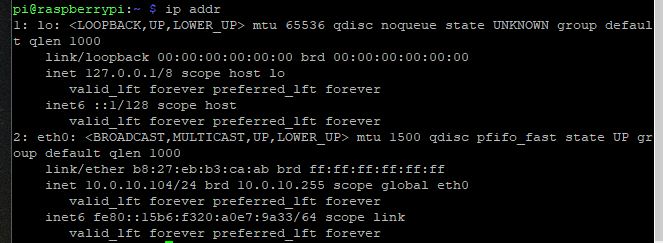

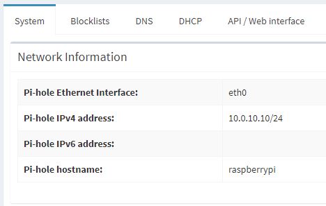

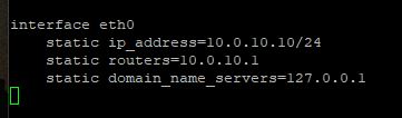

After about a week, Raspbian Lite pulls a DHCP address of 10.0.10.104 (in my DHCP scope). The web gui for Pi-hole shows 10.0.10.10 as the IP address and when I SSH into the Raspberry Pi running Raspbian Lite, and run IP ADDR, it shows 10.0.10.104 as the ETH0 IP! Also, /etc/dhcpcd.conf shows the proper information of 10.0.10.10 for the ETH0 interface.

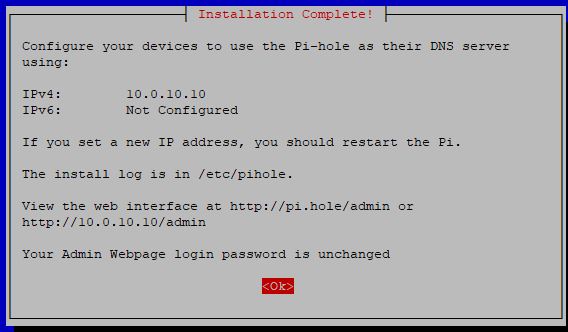

I set the 10.0.10.10 when I run the wizard during the Pi-hole configuration and whenever I do pihole -r reconfigure. It says "do you want to use 10.0.10.104/24" and i say hell no, and I change it to 10.0.10.10/24 and it never sticks!

So here's the Pi-hole GUI, shows .10.10:
But then IP ADDR when I SSH in:

Confirmation page which is clearly a lie:
Then back to /etc/dhcpcd.conf shows .10.10:
BUT IP ADDR STILL SAYS .10.104!
