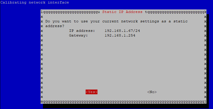

I have a question that probably could fix my problem. What if I change the Gateway address, during pi-hole configuration, and instead of setting 192.168.1.254 (my ISP router) I set 192.168.1.1 (the router I have into my house)? Then I can enable into my router the DHCP. But then how reacts the ISP router with DHCPs? I can't turn it off there because my mom and brother use that router to their home. Also I tried yesterday to turn it off, using only Pi-hole as DHCP, but none of my devices wroked, it looks like the ISP router has to have DHCP on otherwise nothing works.

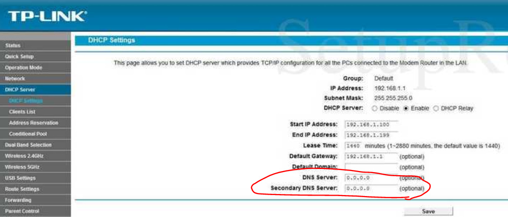

I have no idea how your network topology looks like ... but
both the Technicolor and TP-link routers allow you to configure the DNS server(s) to be pushed via DHCP to the clients:
And you have to make sure when you change any DHCP settings, you'll have to reboot the client PC used for testing, or renew DHCP lease in other way, for these changes to become effective on the client.
