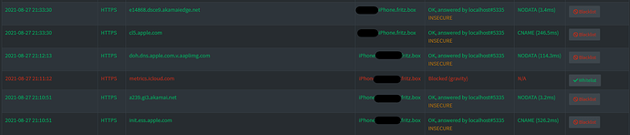

Pi-hole won't cache results if answer doesn't fit known reply types and will always display "N/A (0.0ms)" as Reply in Query Log
Hello,
as the title says, Pi-hole won't cache results for unknown query types, i.e. everything that falls into the OTHER category, plus the new query types HTTPS and SVCB.
edit: Issue extends to unknown reply types instead of unknown query types. See my next comment.
When looking at the Query Log it will also always display the Reply as N/A (0.0ms). I don't know if this is specifically a bug of the beta or if this happens on stable as well, but I'm on the beta version so that's the category I chose.

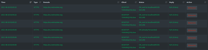

Dig results for both requests. No idea why Windows spawns 3 queries for each.
$ dig TYPE65 https.dns.netmeister.org.
; <<>> DiG 9.16.1-Ubuntu <<>> TYPE65 https.dns.netmeister.org.
;; ->>HEADER<<- opcode: QUERY, status: NOERROR, id: 31647
;; flags: qr rd ra ad; QUERY: 1, ANSWER: 2, AUTHORITY: 0, ADDITIONAL: 1
;https.dns.netmeister.org.      IN      TYPE65
https.dns.netmeister.org. 1252  IN      TYPE65  \# 123 2D6E2031202E20616C706E3D2268332C683222206970763668696E74 3D22323030313A3437303A33303A38343A653237363A363366663A66 6537323A333930302220706F72743D22383038302220656368636F6E 6669673D225A57356A636E6C776447566B49474E7361575675644342 6F5A57787362776F3D220A
https.dns.netmeister.org. 1252  IN      TYPE65  \# 25 2D6E2030207777772E6E65746D6569737465722E6F72672E0A
;; Query time: 150 msec
;; SERVER: 172.18.160.1#53(172.18.160.1)
;; WHEN: Thu Aug 26 02:05:06 CEST 2021
;; MSG SIZE  rcvd: 225
;; ->>HEADER<<- opcode: QUERY, status: NOERROR, id: 52474
https.dns.netmeister.org. 1226  IN      TYPE65  \# 25 2D6E2030207777772E6E65746D6569737465722E6F72672E0A
https.dns.netmeister.org. 1226  IN      TYPE65  \# 123 2D6E2031202E20616C706E3D2268332C683222206970763668696E74 3D22323030313A3437303A33303A38343A653237363A363366663A66 6537323A333930302220706F72743D22383038302220656368636F6E 6669673D225A57356A636E6C776447566B49474E7361575675644342 6F5A57787362776F3D220A
;; Query time: 40 msec
;; WHEN: Thu Aug 26 02:05:32 CEST 2021
As you can see from the dig results, each request was answered with appropriate data and there were another 20 minutes left on the time-to-live (TTL). Despite this, Pi-hole forwarded the second query instead of answering from cache. Additionally, the Reply column shows N/A (0.0ms) even though a valid answer was received and the query most certainly was not processed instantaneously.

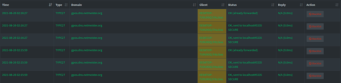

Here is the same behavior with the GPOS query type. Despite almost 40 minutes left on the TTL the second query was not cached.
Dig results. Again, Windows being over-enthusiastic.
$ dig gpos gpos.dns.netmeister.org.
; <<>> DiG 9.16.1-Ubuntu <<>> gpos gpos.dns.netmeister.org.
;; ->>HEADER<<- opcode: QUERY, status: NOERROR, id: 15593
;; flags: qr rd ra ad; QUERY: 1, ANSWER: 1, AUTHORITY: 0, ADDITIONAL: 1
;gpos.dns.netmeister.org.       IN      GPOS
gpos.dns.netmeister.org. 2368   IN      GPOS    "40.731" "-73.9919" "10.0"
;; Query time: 190 msec
;; WHEN: Thu Aug 26 02:15:59 CEST 2021
;; MSG SIZE  rcvd: 85
;; ->>HEADER<<- opcode: QUERY, status: NOERROR, id: 17752
gpos.dns.netmeister.org. 2340   IN      GPOS    "40.731" "-73.9919" "10.0"
;; Query time: 50 msec
;; WHEN: Thu Aug 26 02:16:27 CEST 2021
Granted, you probably won't be seeing these other query types besides HTTPS very often. I chose GPOS here arbitrarily, any query type not known to Pi-hole will show this behavior as well. This site has set up all resource records with definitions of their content for testing:
Maybe a new generic reply type like DATA could be shown for queries of which the format of the answer is not known. (unless its NODATA of course)
And obviously showing the actual response time instead of 0.0 ms would be nice.

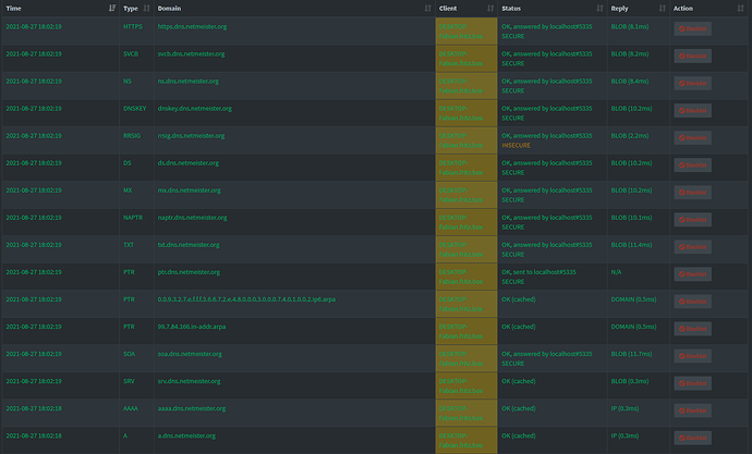

So I've been playing around with this a little and the problem extends to even the known query types. All queries are affected if the answer doesn't fit one of the predefined reply types.
But even the DS and DNSKEY queries don't have DNSSEC as a reply type here for some reason.
There aren't any reply types that would fit any of these queries here, so N/A is better than nothing I guess, but something more descriptive like DATA would be nice just to have any feedback about the result of the query. Also all affected queries were forwarded again instead of being answered from cache. The screenshot doesn't show this but this is the second round of queries (testscript below). The response time is again always 0.0 ms even though the queries were forwarded.

I guess dnsmasq is somehow deciding to not record the reply and, hence, FTL did not see it, either.
This would explain both the N/A (because the reply type is not available at this time and the 0.0 msec (because this is what will be shown if the reply has not yet been received).
Can you show relevant logs from /var/log/pihole.log ?
My guess is that the log will contain lines like (guessing from the very first screenshot in this discussion)
query[HTTPS] https.dns.netmeister.org from <whereever>
forwarded https.dns.netmeister.org to <somewhere>
validation result is SECURE
BUT no corresponding lines like
reply https.dns.netmeister.org is <xyz>
cached https.dns.netmeister.org is <xyz>
If this turns out to be true, this will be a dnsmasq bug which we need to solve over there. I'm not hesitant to trace this down and submit a patch upstream.
Yes, you are right. Except for the TXT query, all other queries without a proper reply type don't have corresponding reply/cached lines.
Aug 26 18:38:13 dnsmasq[24015]: query[A] a.dns.netmeister.org from 192.168.178.20
Aug 26 18:38:14 dnsmasq[24015]: cached a.dns.netmeister.org is 166.84.7.99
Aug 26 18:38:14 dnsmasq[24015]: query[AAAA] aaaa.dns.netmeister.org from 192.168.178.20
Aug 26 18:38:14 dnsmasq[24015]: cached aaaa.dns.netmeister.org is 2001:470:30:84:e276:63ff:fe72:3900
Aug 26 18:38:14 dnsmasq[24015]: query[SRV] srv.dns.netmeister.org from 192.168.178.20
Aug 26 18:38:14 dnsmasq[24015]: cached srv.dns.netmeister.org is <SRV>
Aug 26 18:38:14 dnsmasq[24015]: query[SOA] soa.dns.netmeister.org from 192.168.178.20
Aug 26 18:38:14 dnsmasq[24015]: forwarded soa.dns.netmeister.org to 127.0.0.1
Aug 26 18:38:14 dnsmasq[24015]: validation result is SECURE
Aug 26 18:38:14 dnsmasq[24015]: query[PTR] 99.7.84.166.in-addr.arpa from 192.168.178.20
Aug 26 18:38:14 dnsmasq[24015]: cached 166.84.7.99 is panix.netmeister.org
Aug 26 18:38:14 dnsmasq[24015]: query[PTR] 0.0.9.3.2.7.e.f.f.f.3.6.6.7.2.e.4.8.0.0.0.3.0.0.0.7.4.0.1.0.0.2.ip6.arpa from 192.168.178.20
Aug 26 18:38:14 dnsmasq[24015]: cached 2001:470:30:84:e276:63ff:fe72:3900 is panix.netmeister.org
Aug 26 18:38:14 dnsmasq[24015]: query[PTR] ptr.dns.netmeister.org from 192.168.178.20
Aug 26 18:38:14 dnsmasq[24015]: forwarded ptr.dns.netmeister.org to 127.0.0.1
Aug 26 18:38:14 dnsmasq[24015]: query[TXT] txt.dns.netmeister.org from 192.168.178.20
Aug 26 18:38:14 dnsmasq[24015]: forwarded txt.dns.netmeister.org to 127.0.0.1
Aug 26 18:38:14 dnsmasq[24015]: reply txt.dns.netmeister.org is Format: <text>
Aug 26 18:38:14 dnsmasq[24015]: reply txt.dns.netmeister.org is Descriptive text. Completely overloaded for all sorts of things. RFC1035 (1987)
Aug 26 18:38:14 dnsmasq[24015]: query[NAPTR] naptr.dns.netmeister.org from 192.168.178.20
Aug 26 18:38:14 dnsmasq[24015]: forwarded naptr.dns.netmeister.org to 127.0.0.1
Aug 26 18:38:14 dnsmasq[24015]: query[MX] mx.dns.netmeister.org from 192.168.178.20
Aug 26 18:38:14 dnsmasq[24015]: forwarded mx.dns.netmeister.org to 127.0.0.1
Aug 26 18:38:14 dnsmasq[24015]: query[DS] ds.dns.netmeister.org from 192.168.178.20
Aug 26 18:38:14 dnsmasq[24015]: forwarded ds.dns.netmeister.org to 127.0.0.1
Aug 26 18:38:14 dnsmasq[24015]: query[RRSIG] rrsig.dns.netmeister.org from 192.168.178.20
Aug 26 18:38:14 dnsmasq[24015]: forwarded rrsig.dns.netmeister.org to 127.0.0.1
Aug 26 18:38:14 dnsmasq[24015]: validation result is INSECURE
Aug 26 18:38:14 dnsmasq[24015]: query[DNSKEY] dnskey.dns.netmeister.org from 192.168.178.20
Aug 26 18:38:14 dnsmasq[24015]: forwarded dnskey.dns.netmeister.org to 127.0.0.1
Aug 26 18:38:14 dnsmasq[24015]: query[NS] ns.dns.netmeister.org from 192.168.178.20
Aug 26 18:38:14 dnsmasq[24015]: forwarded ns.dns.netmeister.org to 127.0.0.1
Aug 26 18:38:14 dnsmasq[24015]: query[type=64] svcb.dns.netmeister.org from 192.168.178.20
Aug 26 18:38:14 dnsmasq[24015]: forwarded svcb.dns.netmeister.org to 127.0.0.1
Aug 26 18:38:14 dnsmasq[24015]: query[type=65] https.dns.netmeister.org from 192.168.178.20
Aug 26 18:38:14 dnsmasq[24015]: forwarded https.dns.netmeister.org to 127.0.0.1
I had some time this morning to check the dnsmasq source and now we know what is happening:
dnsmasq can only cache the following types:
  • A
  • AAAA
  • SRV
  • PTR
plus DNSSEC-relevant stuff.
This is not much but surely the majority of things you will see throughout the day.

@Daxtorim It would be great if you could
  1. run your test script on it and get BLOB reply type for all of these
  2. check out some HTTPS queries (I do not have any Apple devices) and see if they are either BLOB or NODATA
edit I just pushed another small update (version vDev-1f18a3e) that fixes a cosmetic issue where the first blocked query after a restart could have been incorrectly shown as allowed. The query was still blocked, only the displayed status was incorrect.
The checkout command is case-sensitive, FTL didn't work, it had to be ftl. Just letting you know.
But trying out the branch, it looks very promising. There are some inconsistencies, however. Maybe they are intentional (you didn't list specific changes).
  1. The reply type of the SRV entry in the Query Log changed from IP to BLOB. But given the actual content of the answer, BLOB is more appropriate anyway.
  2. The log entry for the SRV query says <SRV> where as every other entry uses [SRV] format (different brackets; SRV gets cached as opposed to others; I don't care, but consistency).
  3. The PTR query for ptr.dns.netmeister.org doesn't show a reply type. There was a response (the same as my sample output above) but the log entry is still missing a reply line (log attached below). The response time is also missing, but complete absence instead of 0.0 ms is a good thing in my opinion, if there was never a response in the first place.
  4. The queries for DNSKEY and DS records don't get special treatment with the DNSSEC reply type. I assume that is because they weren't part of actual DNSSEC validation and instead just manual lookups, in which case this is fine by me.
This was the second run of the script again, hence the cached status for some queries.

As for HTTPS queries specifically, NODATA and NXDOMAIN are also working. You saw BLOB in the other screenshot above. I just used dig TYPE65 domain from my PC, but that shouldn't matter (right?). I'll check for genuine queries when the apple devices come home (they are family's).
edit:
Here are queries from actual iPhones. CNAME as a reply type also works and blocking as well. (Blocking wasn't broken in the first place, it just happened to be in the shot)
/edit

Thanks. This reveals something interesting. Blocking is N/A because we respond with REFUSED. This was recommended in the HTTPS draft as reply when the information isn't available. I just checked the most recent draft and this section was removed without replacement. I'll change this to an empty NODATA reply with appropriate logging.
