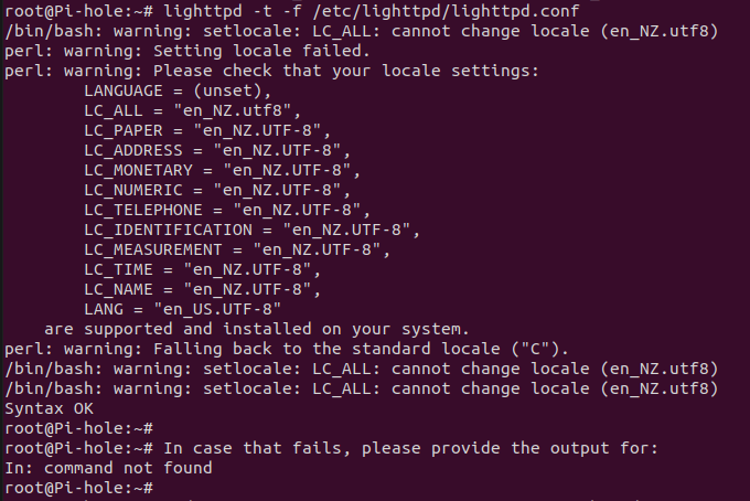

When I ran the first command, I appear to have some errors regarding the inability to change locale. See image below. I know a very long time ago I had problems with that .utf8 setting, though I can't remember what I did to fix it, or whether it's the same problem that's reared it's ugly head. With that said, I never had this problem before, where I am unable to access the webpages.
Run the command:
sudo dpkg-reconfigure locales
And set it to the locale you'd like, let it build the locale files.

I went through your earlier advice, and ran the commands again. This time, when I run:
lighttpd -t -f /etc/lighttpd/lighttpd.conf
I get told: Syntax OK
So far so good. I have also tried restarting the service as instructed, and also a full reboot, but no luck. I still have no webpage being served up
