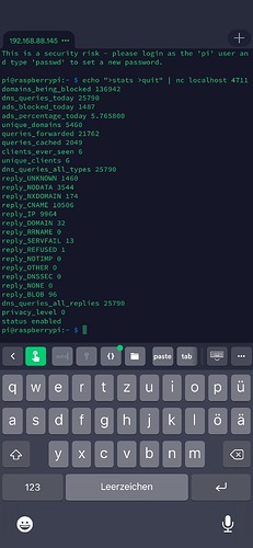

Let's take a look at the traffic volume Pi-hole is processing. Please post the output of this command from the Pi terminal:
This is not particularly high traffic volume, but your debug log shows a few periods when the upstream DNS server has not responded due to a burst of DNS traffic:

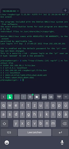

I would take a look at what client is making the volume of requests to hit this limit, and work from there.
echo ">top-clients (15) >quit" | nc localhost 4711
Here is the output, sorry I am really noob in this:
It looks like the majority of your DNS queries are coming from the Fritz Box IP, but they are unlikely to be originating with that device.
I do note that your DHCP server (the Fritz Box) appears to be passing out it's own IP for DNS, and not the IP of the Pi-hole:
