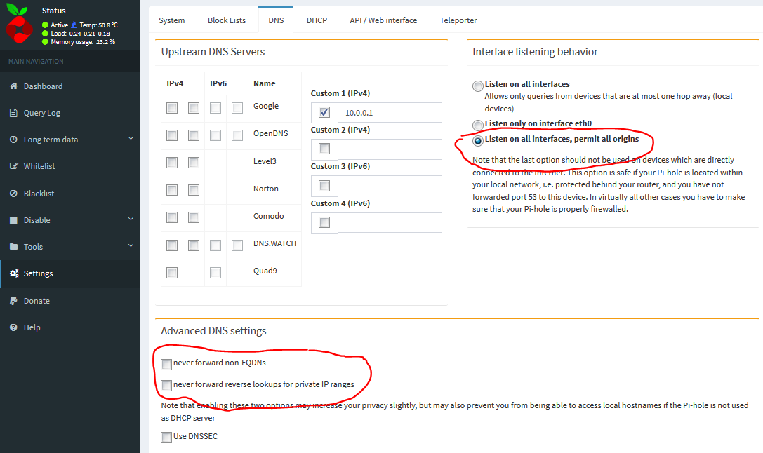

Or better yet, post output for:
sudo grep -v '^#\|^$' -R /etc/dnsmasq*

And maybe that DropBox Link now works...
Only difference compared to my setup are these ones that seem to be lacking on yours:
/etc/dnsmasq.d/01-pihole.conf:bogus-priv
/etc/dnsmasq.d/01-pihole.conf:interface=eth0
And I dont have below one in my config:
/etc/dnsmasq.d/01-pihole.conf:except-interface=nonexisting
On my Pi:
pi@noads:~ $ grep -v '^#\|^$' -R /etc/dnsmasq*
/etc/dnsmasq.conf:conf-dir=/etc/dnsmasq.d
/etc/dnsmasq.d/01-pihole.conf:addn-hosts=/etc/pihole/gravity.list
/etc/dnsmasq.d/01-pihole.conf:addn-hosts=/etc/pihole/black.list
/etc/dnsmasq.d/01-pihole.conf:addn-hosts=/etc/pihole/local.list
/etc/dnsmasq.d/01-pihole.conf:localise-queries
/etc/dnsmasq.d/01-pihole.conf:no-resolv
/etc/dnsmasq.d/01-pihole.conf:cache-size=10000
/etc/dnsmasq.d/01-pihole.conf:log-queries
/etc/dnsmasq.d/01-pihole.conf:log-facility=/var/log/pihole.log
/etc/dnsmasq.d/01-pihole.conf:local-ttl=2
/etc/dnsmasq.d/01-pihole.conf:log-async
/etc/dnsmasq.d/01-pihole.conf:server=10.0.0.1
/etc/dnsmasq.d/01-pihole.conf:domain-needed
But that could be related to different Pi-hole versions and some minor differences in the settings configured on the web GUI.

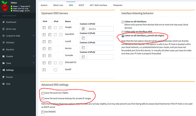

Try opening up entirely by configuring "Listen on all interfaces, permit all origins" and remove the tags for forwarding queries:
