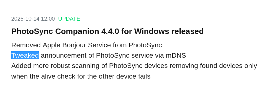

From photosync's page: (News - All - PhotoSync)

When piecing together the information collected in this thread, I'd be tempted to think that your client software announces a *.photosync name via mDNS for the machine it runs on, lacking the standard .local TLD, and your router may then have picked that up as a name and registered a DNS record for it.
