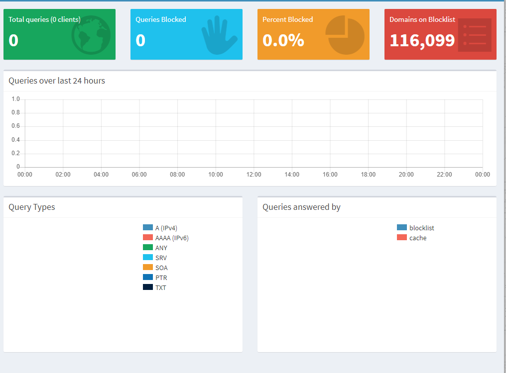

Pi-hole querie/network queries empty

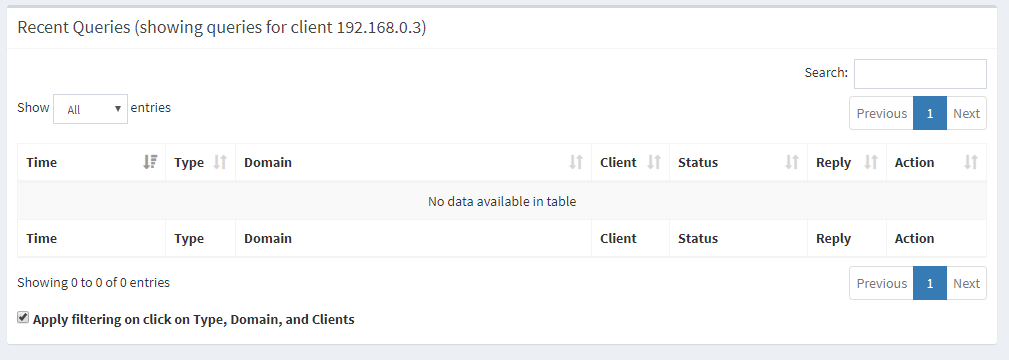

dns requests available in querie list making it possible to block them with the button
querry list is empty
https://tricorder.pi-hole.net/ib207rdwgv
note:
tail on piole.log revels many items
tail on pihole-ftl is empty
blocking is working
setupvars:
DNSMASQ_LISTENING=single
PIHOLE_DNS_3=2001:4860:4860:0:0:0:0:8888
PIHOLE_DNS_4=2001:4860:4860:0:0:0:0:8844
PIHOLE_DNS_5=192.168.0.1#53
DNS_FQDN_REQUIRED=true
DNS_BOGUS_PRIV=true
DNSSEC=false
CONDITIONAL_FORWARDING=false
WEBPASSWORD=285960c0f1fa143c4b2d5d9ce89d7ebae3a5b1c4d8ccbf837849c9d2cde82e7f
PIHOLE_INTERFACE=eth0
IPV4_ADDRESS=192.168.0.2/24
IPV6_ADDRESS=2a02:1812:2c26:2d00:cdb1:d795:36ee:b07d
PIHOLE_DNS_1=8.8.8.8
PIHOLE_DNS_2=8.8.4.4
QUERY_LOGGING=true
INSTALL_WEB_SERVER=true
INSTALL_WEB_INTERFACE=true
LIGHTTPD_ENABLED=true
BLOCKING_ENABLED=true
pihole-FTL.conf:
PRIVACYLEVEL=0

Any data for 192.168.0.3 in the database if run below one ?
sqlite3 /etc/pihole/pihole-FTL.db 'SELECT * FROM queries WHERE client="192.168.0.3"'
If data in dbase but none displayed on web, check live logs when querying via the web:
sudo tailf /var/log/lighttpd/access.log
sudo tailf /var/log/lighttpd/error.log
