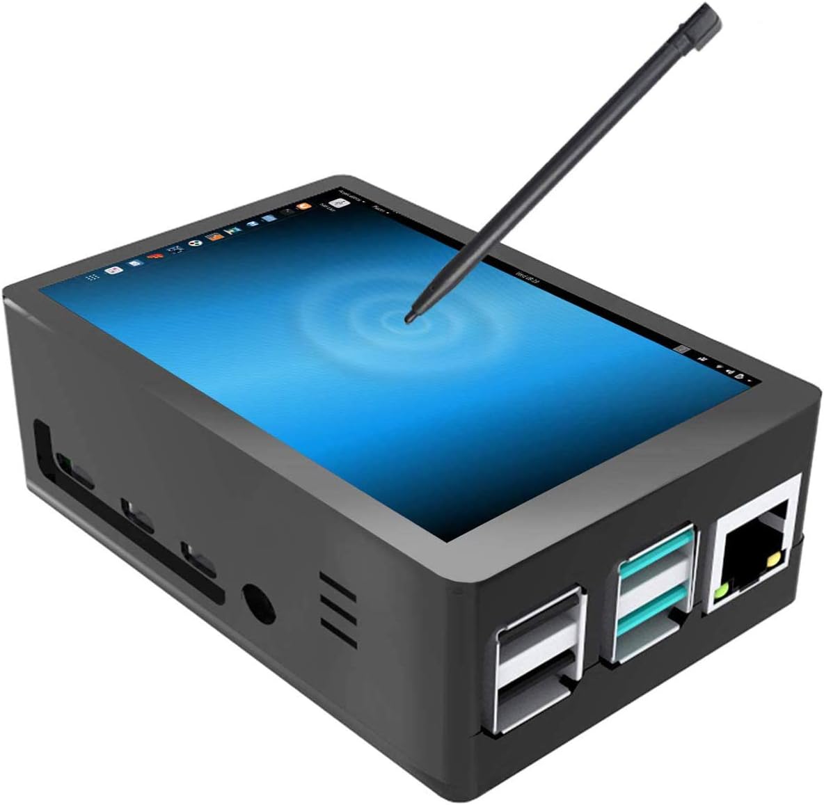

I want to create a pretty nice setup using pi4 + lcd screen:
Questions:
1.) Is this a good setup/do you see any issues with this setup? (I will run in headless UI / terminal mode)
2.) Other similar setup recommendations/tips?

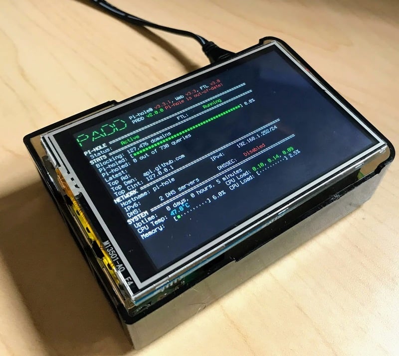

I just setup a Pi4b with this LCD and case from Amazon.
I set the Pi to boot to console from Raspi-Config it didn't seem to want to start PADD at first and I don't remember if i did anything to it to get it working but at one point i looked down at the screen and it was working after looking like it was stuck with a buffer of the OS booting. I could see PADD flickering in the background but now it works every reboot.
Am still wondering how PADD is able to auto start at boot without logging in.
I dont see anything in the PADD readme and the padd.sh script that does.

I used this tutorial on Adafruit.com. But since the screen that I got wasn't one of theirs I just used Raspi-config to boot to console then put in the .bashrc portion to have PADD start.
It's also in the PADD Readme.
https://github.com/jpmck/PADD/blob/master/README.md
Those instuctions dont make your Pi autologin.
But I found instructions on the Wiki:
Set your Pi to automatically log into the console using raspi-config.
https://github.com/jpmck/PADD/wiki/Setup
I did say I used Raspi-config to make the Pi boot to console.
Yeah you did :smiley:
But this is a vital step so should have been more prominent in the instructions :wink:
Well when your using one of the adafruit screens right in the driver install they give you an option to boot to console, but since the screens we have use a different driver we needed to use Raspi-Config.
