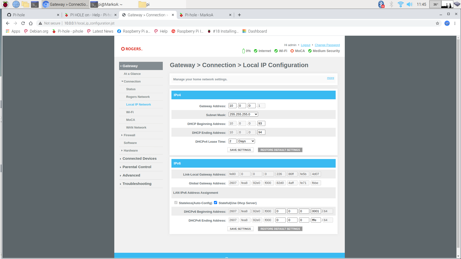

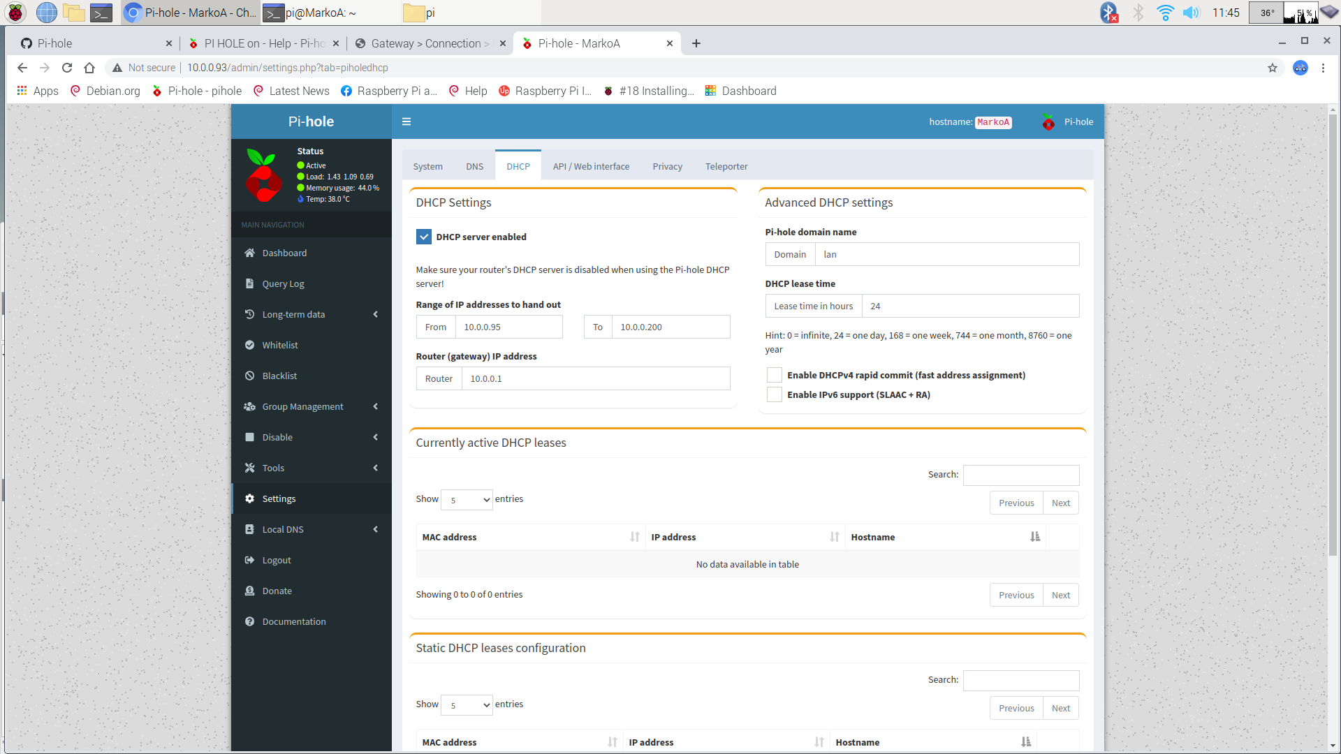

Change the DHCP range on the router to a single IP, and make that the IP of the Pi-hole. Then, set the DHCP range on the Pi-hole to something that doesn't overlap that IP.
Example - Pi-hole at IP 22.
Set router DHCP from 22 to 22.
Set Pi-hole DHCP from 25-200.
Is this what you mean
Yes. Note that the router has a DHCP range of two IP's, so you might have a client other than Pi-hole try to get one of them. Watch for that.
