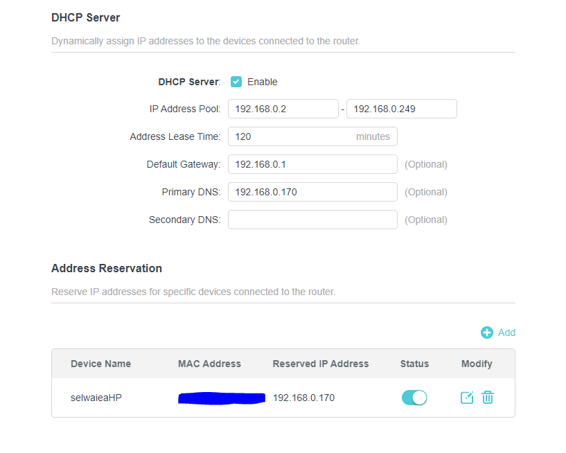

I did manually add the DNS to all of my devices and on top of that I added it to the router so all devices will use it.
The picture below shows the settings on my TP-Link router AX1500:

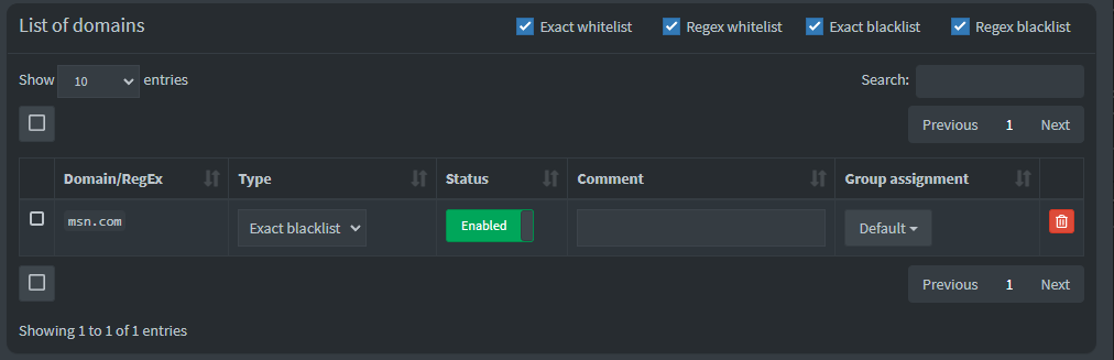

It may be that your browser does see msn.com blocked but then "helpfully" tries www.msn.com which is not blocked by your rule, and the site loads.
Delete the blacklist rule and re-add it but this time also ticking the "Add domain as wildcard" box. That will block not just msn.com but all its subdomains such as www.msn.com.

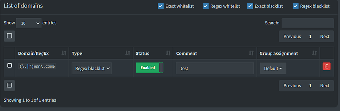

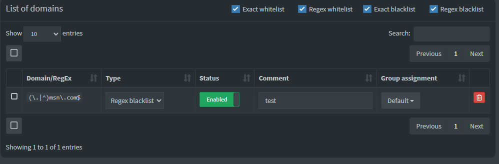

This is how it looks like in pihole:
And yes msn still works.

You should set Pi-hole as secondary DNS as well. Currently, your router advertises itself as DNS server too.
   Timeout: 10 seconds
   * Received 300 bytes from eno1:192.168.0.1
     Offered IP address: 192.168.0.170
     Server IP address: 192.168.0.1
     Relay-agent IP address: N/A
     BOOTP server: (empty)
     BOOTP file: (empty)
     DHCP options:
      Message type: DHCPOFFER (2)
      server-identifier: 192.168.0.1
      lease-time: Infinite
      netmask: 255.255.255.0
      broadcast: 192.168.0.255
      dns-server: 192.168.0.170
      router: 192.168.0.1

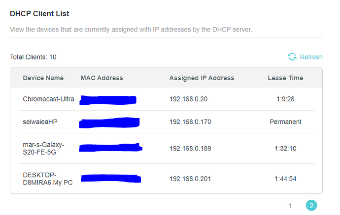

On the same screen (below the items on the image), there should be a section called "DHCP Client List".
Do you see your PC there? do you see all other devices there?

Yes I do see my PC here in the list it is the one that ends with .201

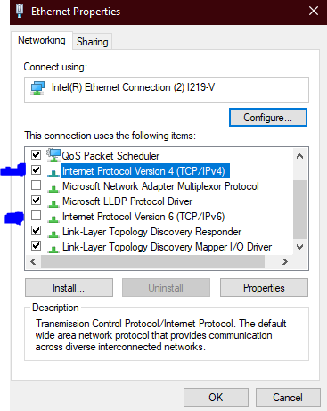

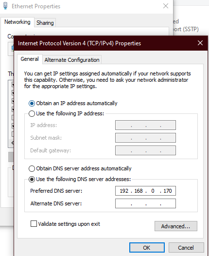

On top of that I did flush my DNS to make sure my PC is using the Pi-hole DNS and I added it in the network:
And I also made sure I am only using IPv4 as you can see in the second picture:
Note: I did make sure the DNS to be set as 192.168.0.170 manually on all my devices just in case the router does not change them.

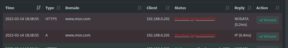

So if you look at your Pihole query logs, do you see queries to msn.com? If so, what are the responses that are logged ("OK," "BLOCKED," etc.)?
Well here is a screenshot of how it looks like from my PC if I am trying to access msn.com.

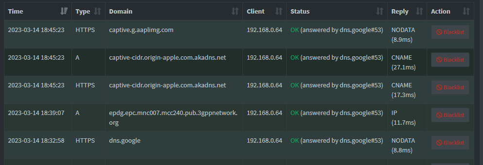

However in the Querey Log I do not see that I accessed msn.com from my mobile here is a picture of the logs, and I did access msn.com at 18:41 and at 18:43. I do not see the logs alot from my phone. Only sometimes do I see logs.
