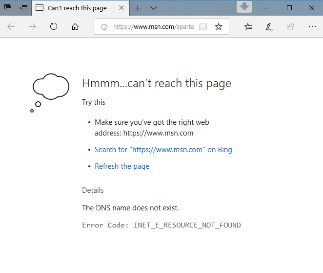

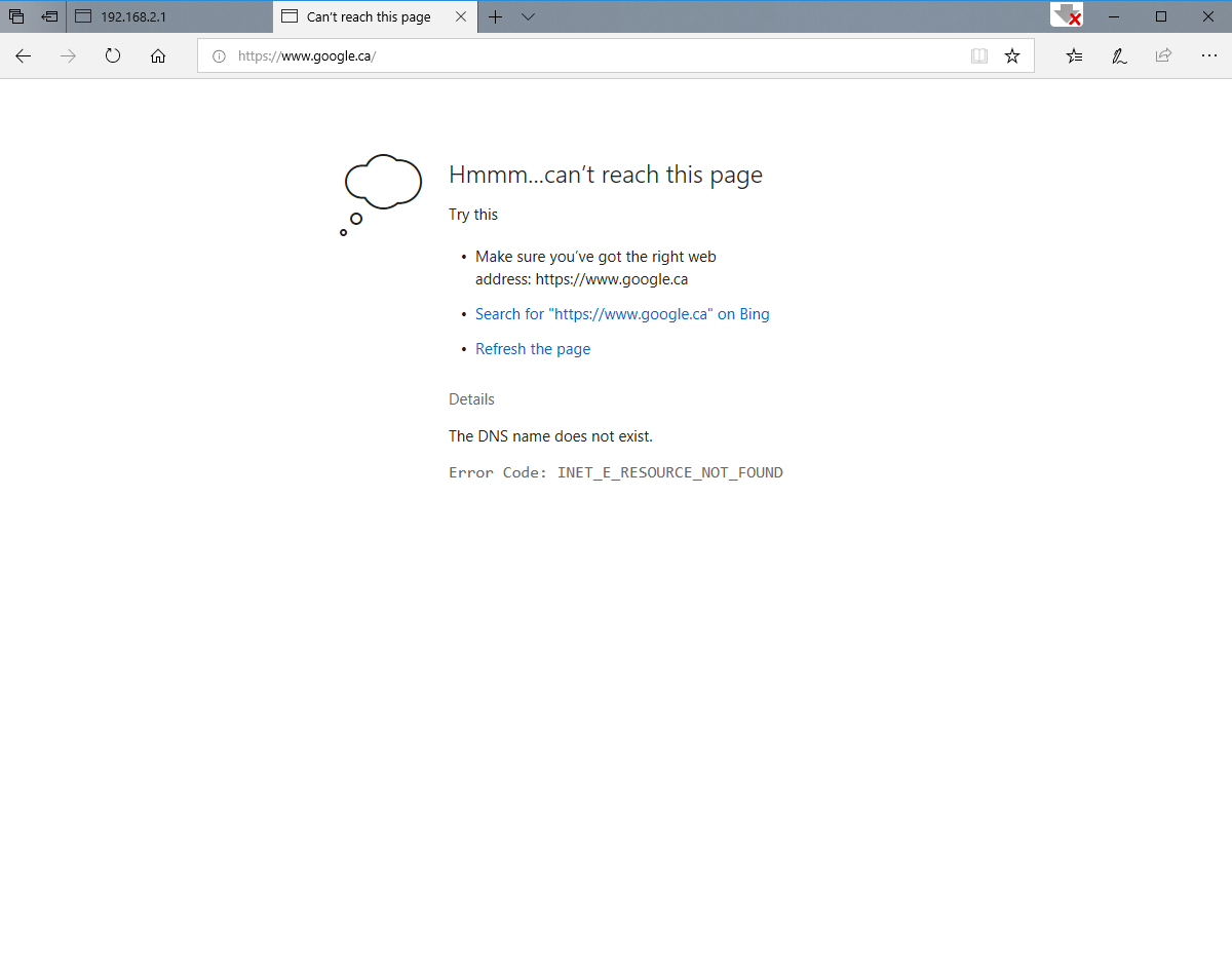

Results: Can not access any internet web page. All local hardware is accessible by IP address.
If I change the router DNS settings back to Open DNS's servers, everything works again, but of course... no filtering.

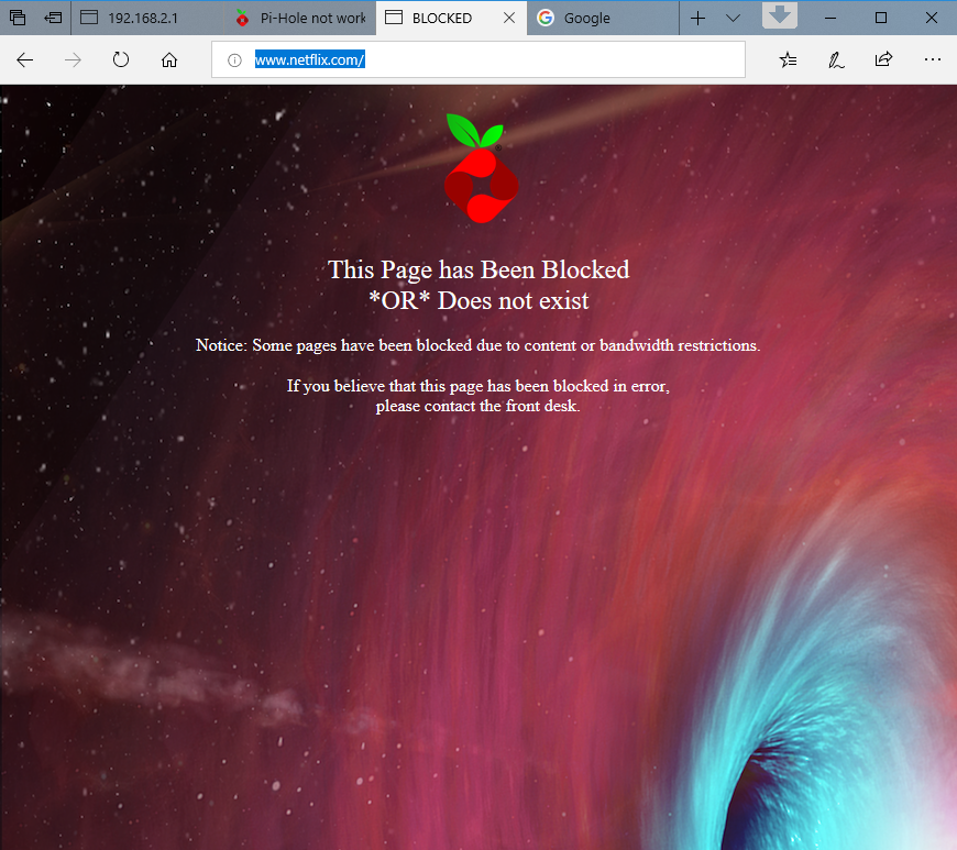

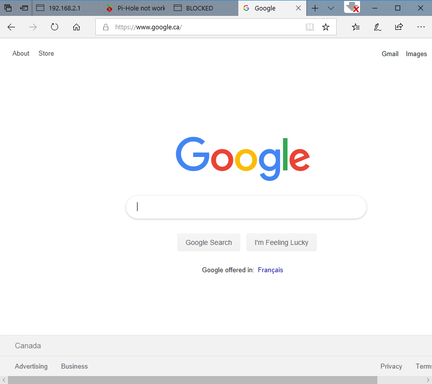

If I manually address the Pi-Hole machine in a computer's DNS settings, it works fine.
