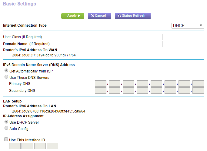

Also of note (and expected based on the nslookup results) when IPv6 is enabled on the WIndows machine, I'm unable to access pi.hole/admin
That would be because your Windows machine is using your ISP as the DNS. To confirm please run ipconfig /all and check the listed DNS servers. There is no such thing as a primary and secondary DNS, every listed DNS server will be used.
I don't know where it would be getting that info from. Prior to using PiHole, I ran DNSMasq. My router has DHCP off, the ISP's router is in bridge mode.

I've got one network card getting IPv6 DNS servers which are out of the blue, and one not getting any.
Those are GUA addresses which means they were assigned to you by the ISP. Double check your router(s) or modem(s) and see. My advice is to disable IPv6 across the entire network unless there is a specific use case that only works with IPv6.
That's everyone's advice, and it doesn't help me learn how to use it. :slight_smile: Need to have it enabled to figure out how to actually use it.

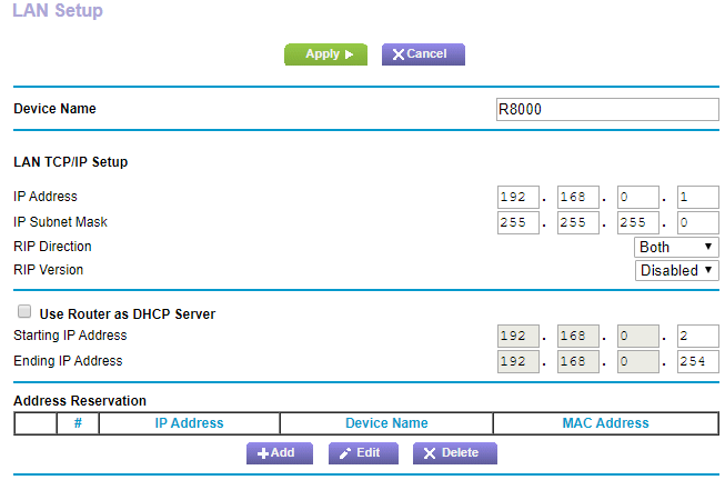

Turns out my router has two sections for DNS servers - one for IPv4 which I have set up properly and then another tucked away in a back corner for IPv6.
What I've gone and done is on the second page settings for my router, I've disabled IPv6 completely - that'll block IPv6 from the internets which will let me focus on getting it working on my LAN. The Pi Hole still isn't handling it correctly though it seems.
