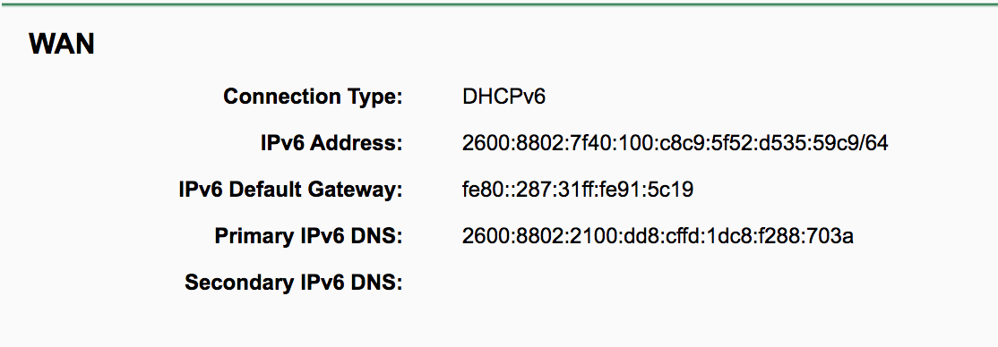

Try to disable anything IPv6 related on the router and disconnect and reconnect the client again to check DNS servers assigned.
EDIT:
EDIT:
Those are IPv6 addresses being assigned to your Mac by your ISP. It appears that you are getting IPv6 service. To "remove" them here, as @deHakkelaar has already mentioned, you will need to do so at your router. That could be in a couple of ways:
One would be to disable IPv6 altogether.
The other would be not allow IPv6 traffic to enter your local network.
Actually, a third way is to reconfigure your Mac to use Link-local only for the IPv6 mode in System Preferences > Network ... and may be the simplest option of all to try.

I will remove IPV6 from my router. I dont know how.. let me figure it out
I believe I fixed the issue.
Sorry @Tesserax and @jfb I went the totally opposite way with this.
instead of disabling the IPV6. I used the IPV6 I got from Pihole /etc/pihole/setupvars.conf and used that in my Router as a IPV6 DNS. I think its working now!
Thank you so much guys for all the trouble. I truly appreciate you helping me!
