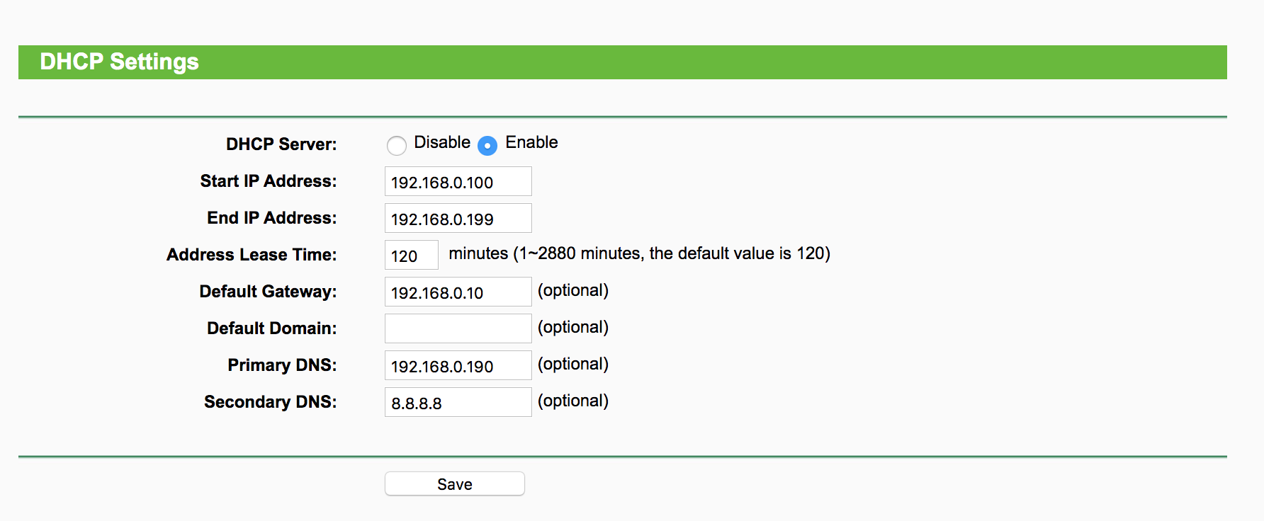

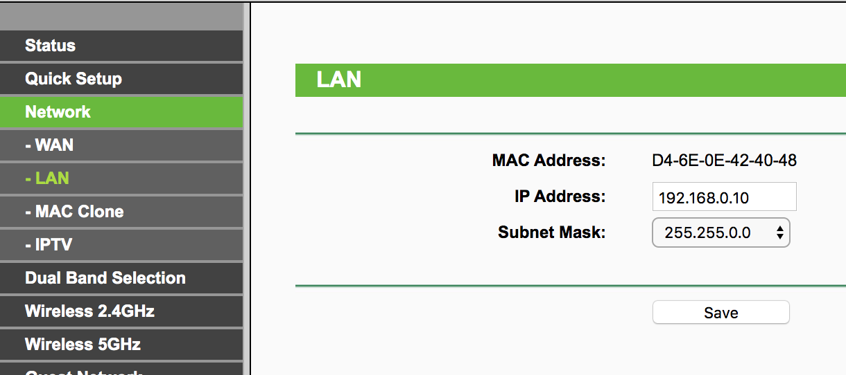

So back to the issue, the gateway not responding.
IP 192.168.0.189 or 192.168.0.10 as a gateway seems a bit odd.
Shouldn't your router IP be the gateway address to get on the internet ?
Router IP is probably 192.168.0.1.
I believe you can reconfigure IP settings with Pi-hole through dhcpcd5 by running below and select reconfigure:

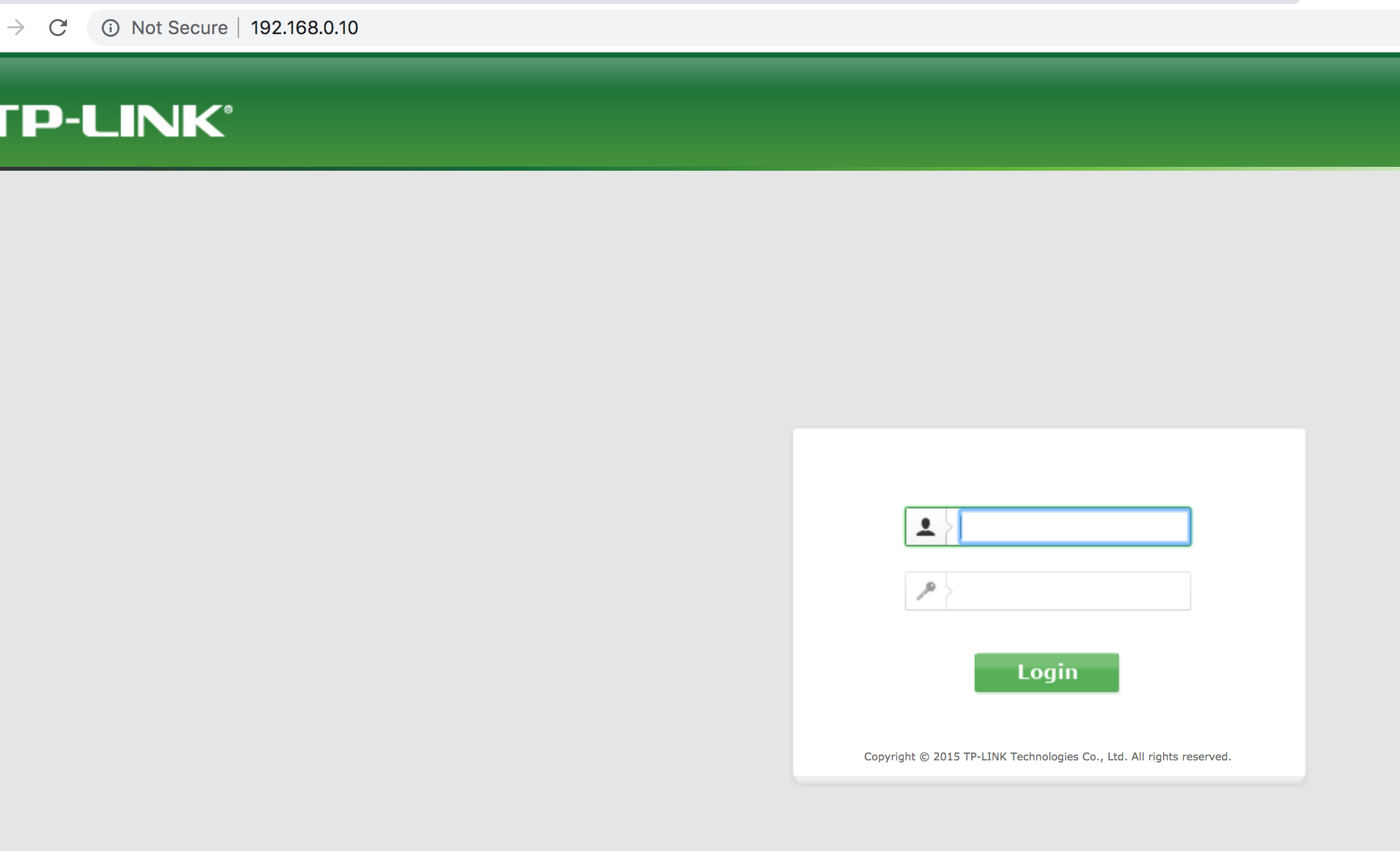

I'm not even sure if my LAN is suppose to be on that IP.. This makes me wants to wipe my router or factory reset it.(probably my last option)

And remove the 8.8.8.8 Secondary DNS address on the router or ads will still leak through!
Ps. if you change DHCP settings, you have to disconnect and reconnect client devices for the new settings to propagate!

Thats probably because of the secondary DNS IP address 8.8.8.8.
I see should I set second DNS as 190.168.0.189?
no worries man, you're helping me a lot! I'm also learning a bunch ![]()
No.
If the router firmware doesnt allow you to leave this field empty, try put in the same IP 192.168.0.190 twice.

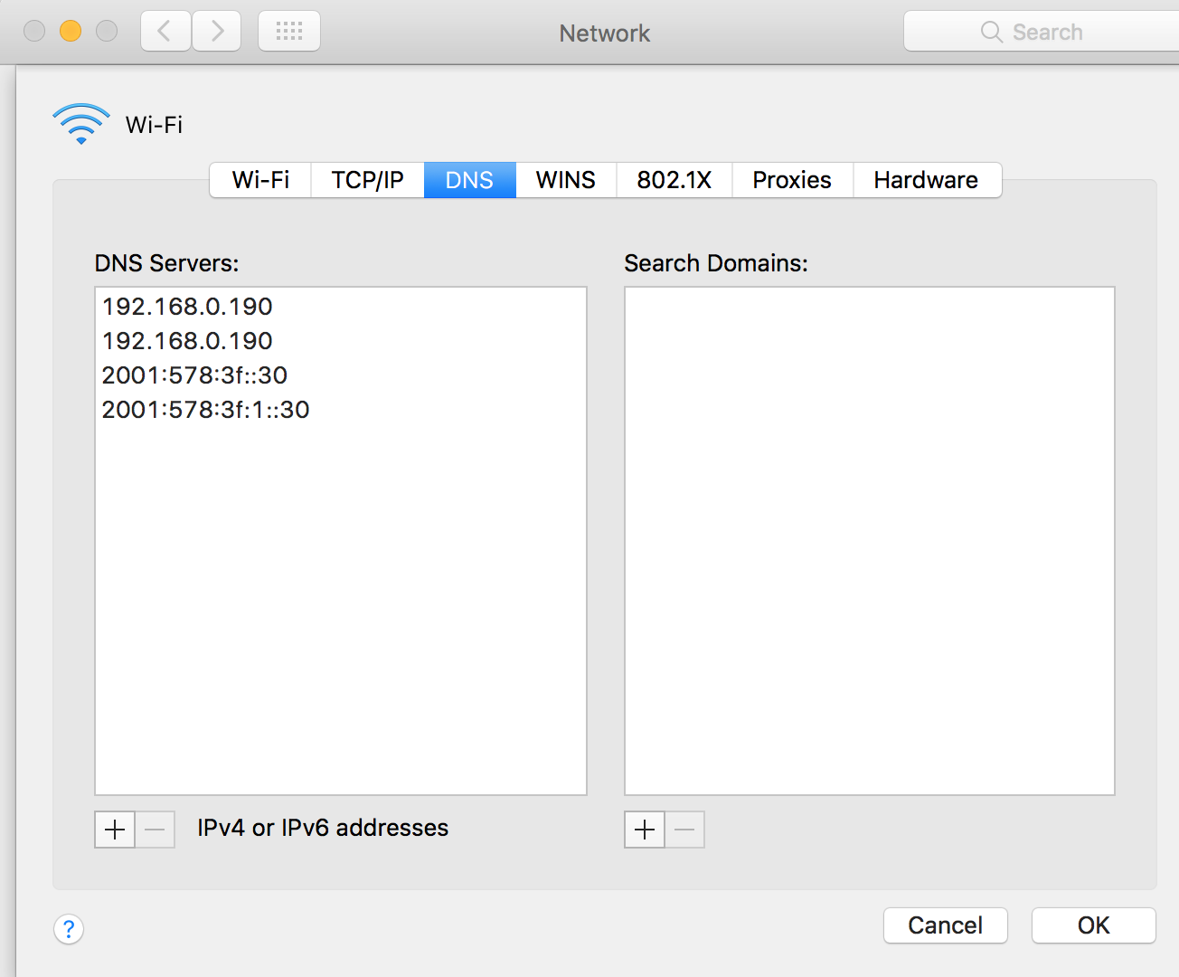

I realized when testing that nslookup flurry.com I had my dns manually set on my mac.
Sorry for the confusion

Locs-MacBook-Pro-2:~ LocNguyen$ nslookup flurry.com
Server: 2001:578:3f::30
Address: 2001:578:3f::30#53

This is my mac DNS settings automatically. I dont know what those two other IP are I really want them out of here...
