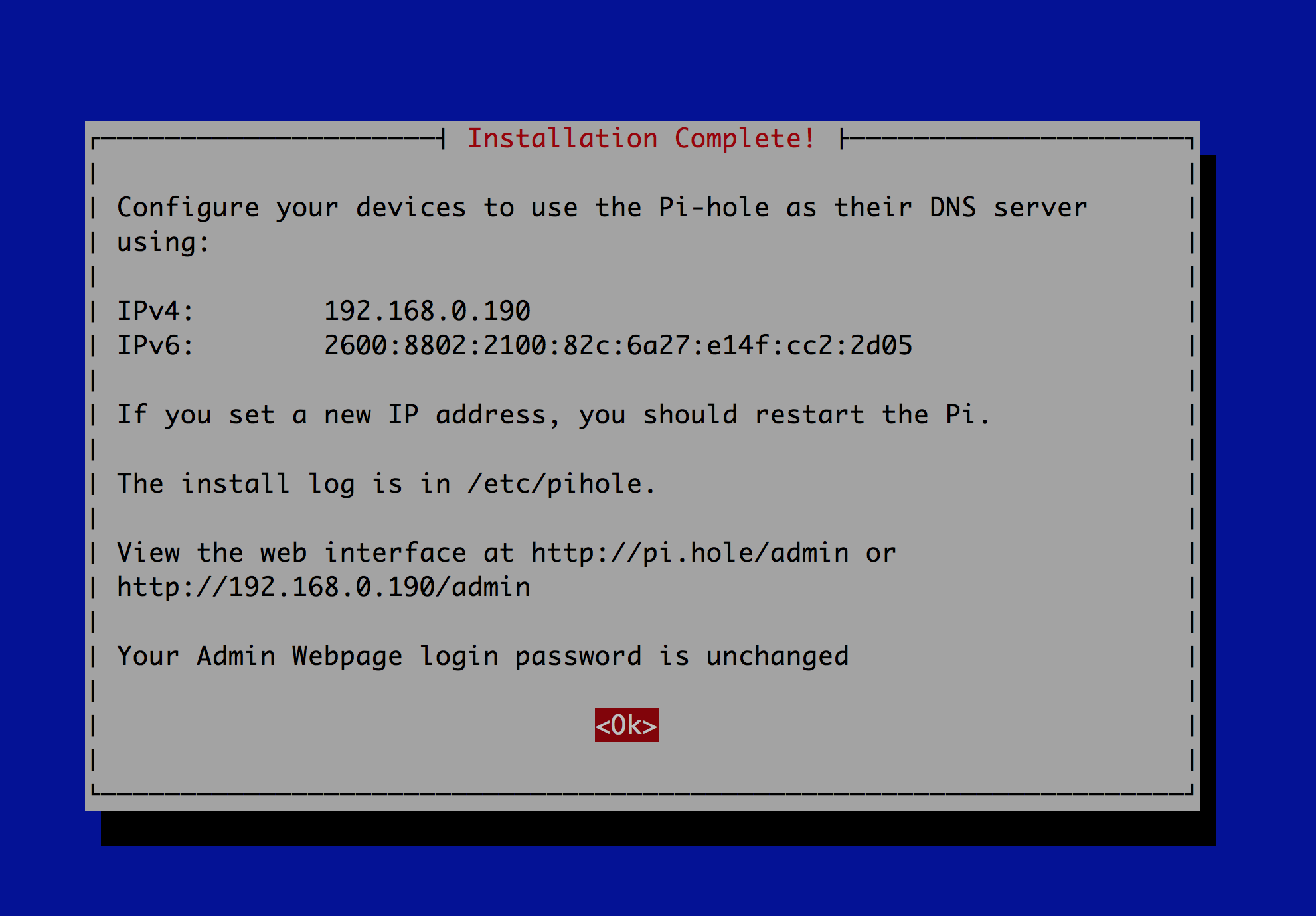

  3. Installed PiHole and used the static IP during setup from step 2 (192.168.0.190)

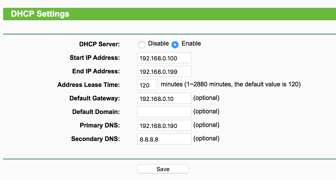

  5. then add IP DNS( generated by pi hole installation) to my router then reboot (192.168.0.190)

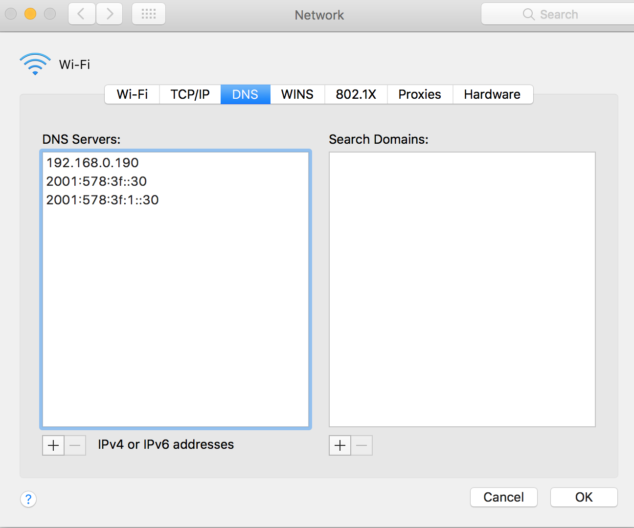

@locnguyen The issue I see right away is the DNS settings in your router. You should have a single address of the Pi-hole there. No other addresses should be used. Once done, your Mac should only see the Pi-hole DNS address of 192.168.1.190.

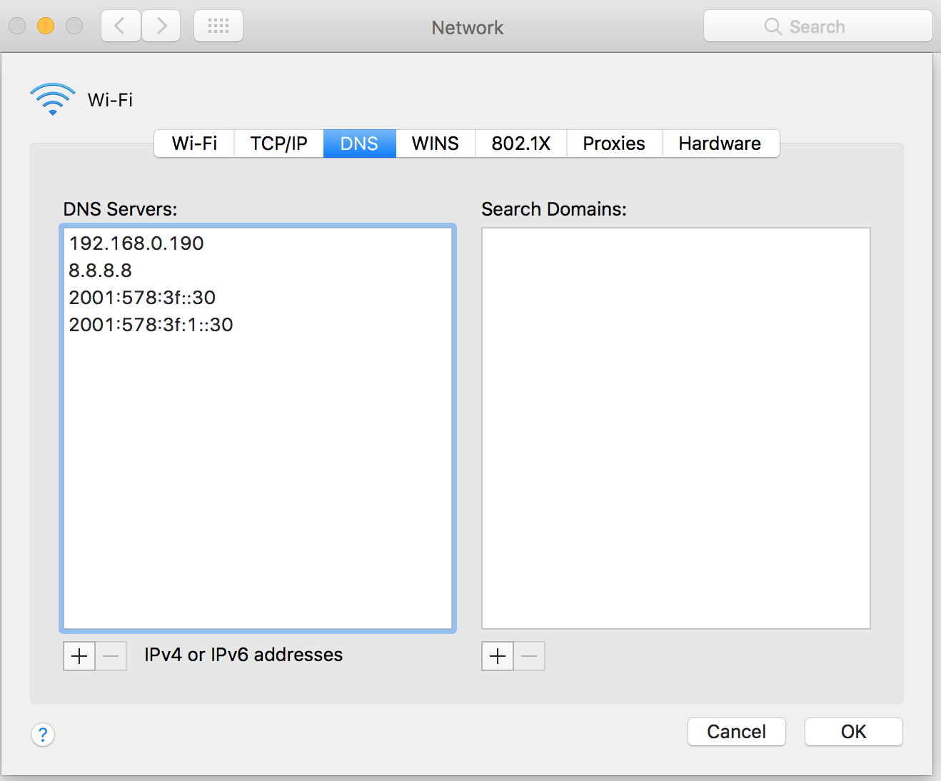

@Tesserax Thanks for the tip! I am not sure how to remove the other ones. I actually cant remove it. within the settings. I want to make sure that this is a network wide appliance.
I've assigned 8.8.8.8 as a secondary DNS.

@locnguyen Remove 8.8.8.8 from your router's settings. You should only have the Primary DNS set to: 192.168.1.190

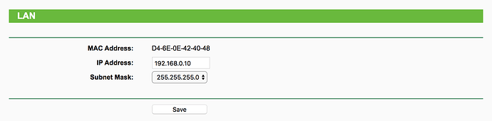

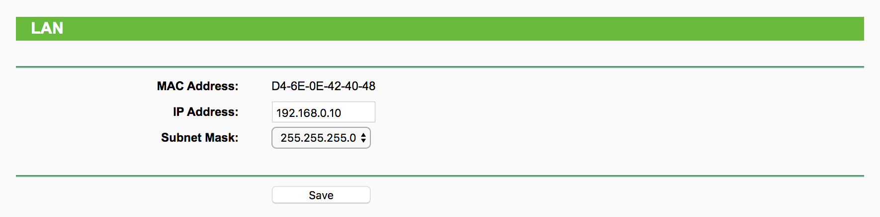

In addition to the un-needed second DNS of Google (8.8.8.8), what have you set up for your gateway when you set up Pi-Hole? Your debug log shows Pi-Hole trying to find a gateway at IP 189, and this does not appear to be the actual gateway IP (the IP of the router).
[i] Default IPv4 gateway: 192.168.0.189
192.168.0.10
   * Pinging 192.168.0.189
192.168.0.10...
[✗] Gateway did not respond.

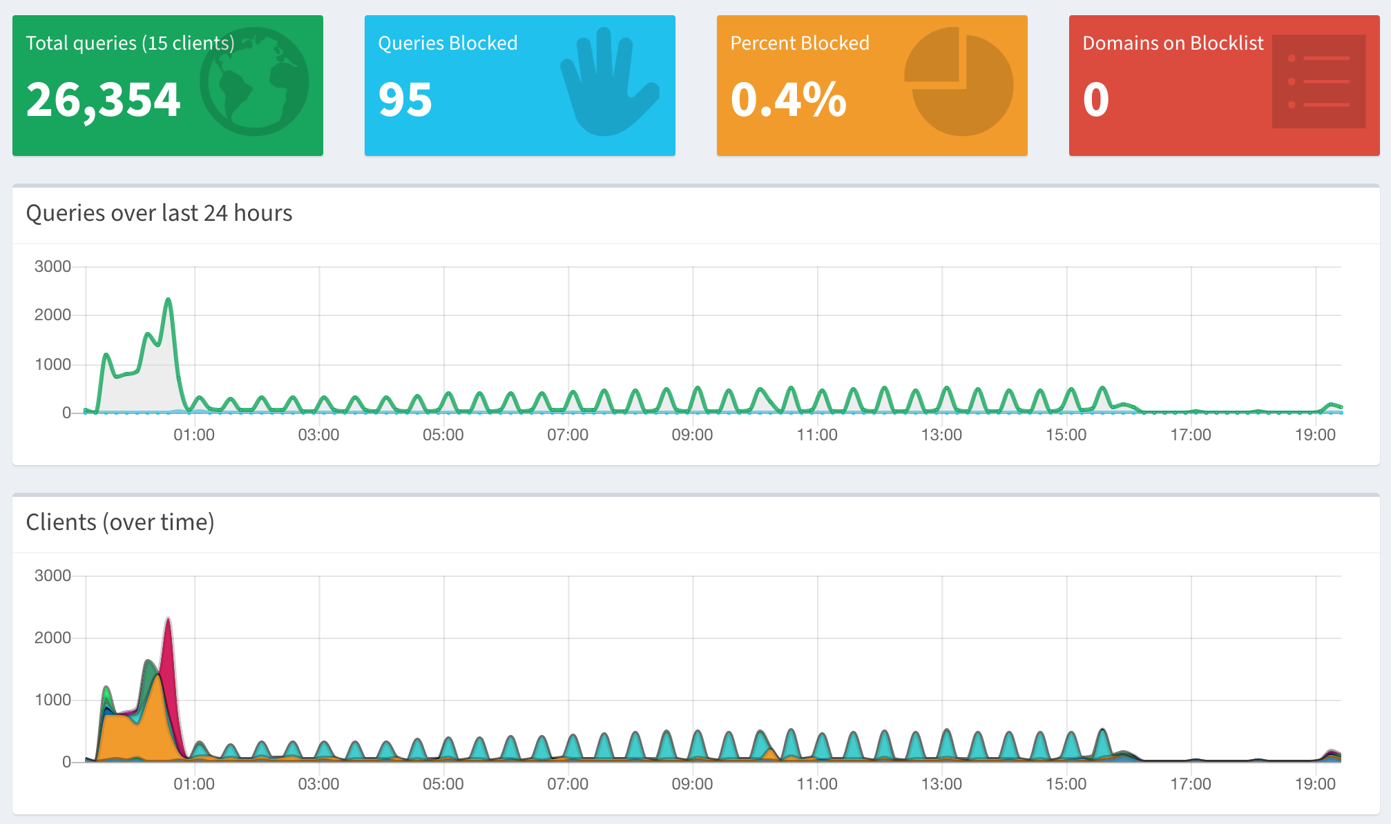

Your gravity list is also empty - this is the master list of domains to block. With this list empty, nothing will be blocked. This is why the "domains on blocklist" on your dashboard shows zero. Fix this by updating gravity via the command line with pihole -g or via the web admin interface.
@Tesserax I've removed the 8.8.8.8 yet it still doesnt work

pi@raspberrypi:~ $ pihole -g
  [i] Target: raw.githubusercontent.com (hosts)
  [✗] Status: Connection Refused
  [✗] List download failed: no cached list available

on you mac select one at a time the dns servers you do not want to use and click the [-] button at the bottom of that window
Connection refused often means a rate limit of some kind. sometimes these can last from an hour to a day depending on the website

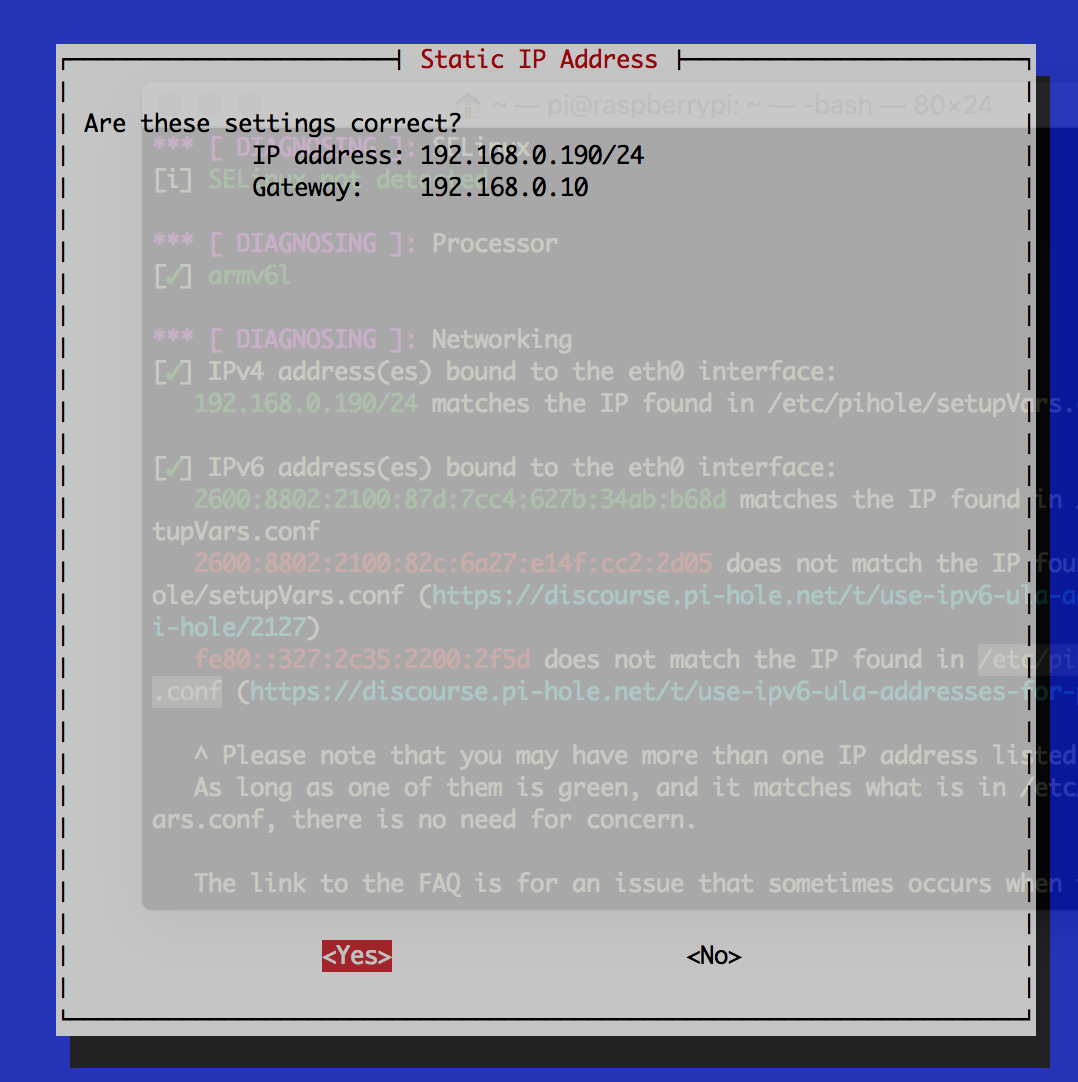

to fix the gateway you would want to pick reconfigure when running pihole -r not repair
Run pihole -r (select reconfigure) again and select the correct interface and gateway.

@technicalpyro unfortunately I cannot click on those. they are not selectable for some reason.
@jfb I just ran pihole -r reconfigure but it seems like it changes back to 192.168.0.189 to the ipv4 gateway
I've also ran pihole -g but i believe my list is still empty.
192.168.0.10
192.168.0.10...
ping: 192.168.0.189
192.168.0.10: Name or service not known
[✗] Gateway did not respond. (https://discourse.pi-hole.net/t/why-is-a-default-gateway-important-for-pi-hole/3546)

If your Mac is configured as a DHCP client (it is by default) then the DNS addresses listed will be grayed out. That is because your router's DHCP server is providing the addresses. Your Mac is also getting IPv6 addresses, most likely because your ISP is providing you with IPv6 service.

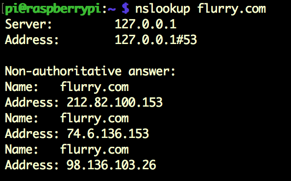

@Tesserax I see, I was wondering what do you get when you run
$ nslookup flurry.com
@locnguyen Are you interested in the results for this command from my Mac or the Pi-hole?
@Tesserax from your pihole. I read that you're suppose to get refused.
I ran pihole -r to reconfigure the IPV4 Gateway but It just wont change it revert back to the wrong one every single time :confused:
@locnguyen Well it gets refused from both locations for me.
@Tesserax got it good to know. Thank you!

@locnguyen Well it appears that you may have some type of network issue that is preventing the Pi-hole from recognizing your network's gateway address. For that, I probably won't be able to help you as my network is based on Ubiquiti UniFi hardware.
You may need to go back to "square one" and re-install Raspbian on your RPi, then see if it can communicate with the Internet. Once verified, try installing Pi-hole again. Good luck! ... and, Happy New Year!
