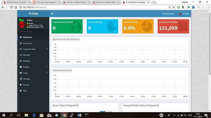

hi itried to install pi hole on a synology nas using following manual:
i got the webinterface running and both tried installing dns of my nas to router and manually in windows but it does not work. seems like a port error of something . i do not have port 80 in use by any other app on the synology . i ran the debug log : token 51b1w38nuk
and will copy the log also under my queston . I know there is a docker solution too but i am so close it must be something simple :slight_smile: any help ? thanks in advance.
Michael

Did you read the whole topic ? Did you follow all the steps ?
Reading your log shows that pihole is not running. (it is quite obvious).
From chroot execute:
service lighttpd restart
service dnsmasq restart
If it doesn't work, leave everything as is and reinstall pihole (and change the webserver port again).
after that execute:
yes it restarts ok also reinstalled it same problem :frowning: pihole -r gives ok

Pi hole is working but admin console doesnt show data load button is red .
I once got it it to work (really dont know how :slight_smile: ) but because of the may errors in debug log i clean installed .
new debug token 9vsomcj8ng
i tested the pi hole with the pages on the pi hole website and it works only nothing in the web interface see picture. tried googling and reading articles here and else but no solution. thanks in advance
