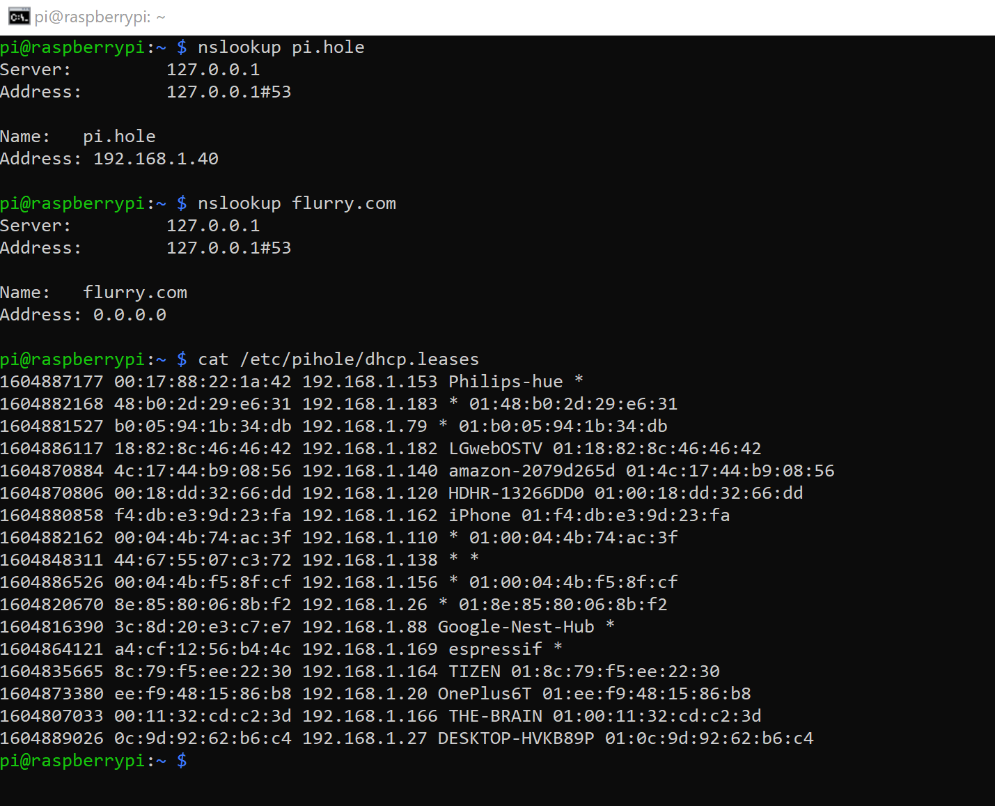

Whats the output of
cat /etc/pihole/dhcp.leases
From a client please run
nslookup pi.hole
nslookup flurry.com

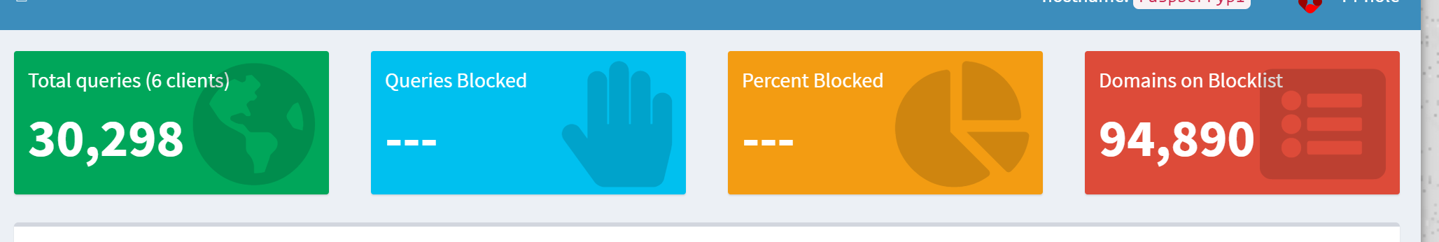

Your debug log shows they are. The empty boxes on the web admin dashboard are frequently due to a browser ad blocker. If you have these in operation, disable them for the dashboard.

Blockquote From a client please run nslookup pi.hole nslookup flurry.com
I will test this when I get home this evening...
The point I am addressing is the incorrect information on your dashboard. The debug log shows Blocked DNS queries: 7051 , but the dashboard does not show this. The blank lines for queries blocked and percent blocked are most commonly caused by an adblocker on the browser preventing these boxes from loading.
Turning off the adblocker for the Pi-hole web admin page typically fixes this problem.
hope this helps...sorry it took so long.

You're right, sorry disabling brave browser blocking allows Pi-hole to show my stats. I can confirm ty wired clients are blocking some ads, they pass the canyoublockit simple test, fail the extreme test miserably. My wireless clients are not blocking any ads. Very strange...
