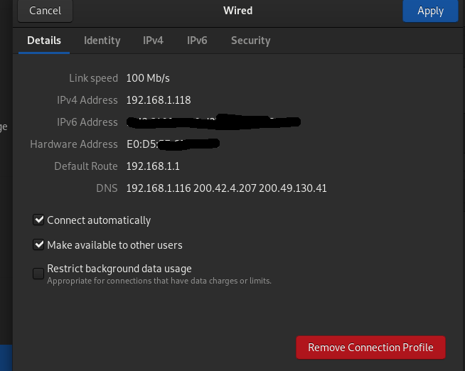

I change my PC's ip (192.168.1.118) and my pi-hole's ip is 192.168.116.
I change my PC's ip using DHCP reservation (router setup). On the screen you can see my new ip and the first DNS (pihole's ip).
Pihole doesn't work :frowning:

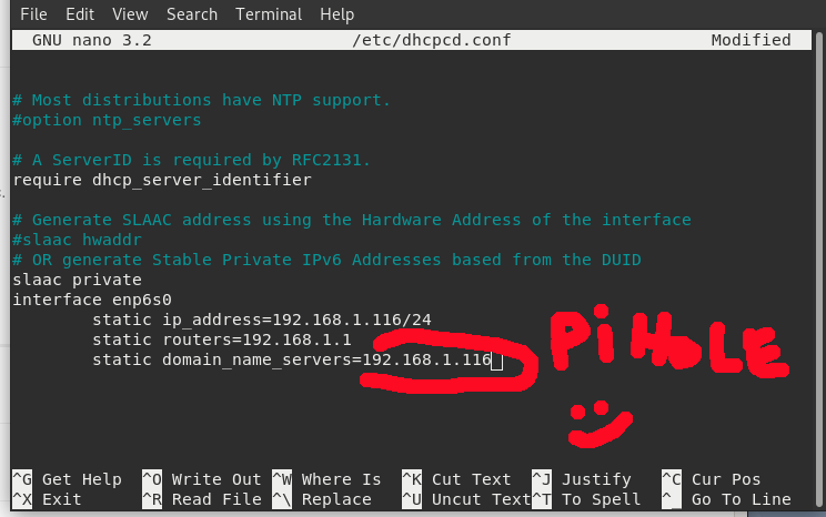

Edit the file /etc/dhcpcd.conf on your Linux PC and change the nameserver for the active network interface to the Pi-hole IP.
Its work! Its work!
THANKS TO EVERYONE!!! :slight_smile:
I reboot my pc and PiHole keeps working!
