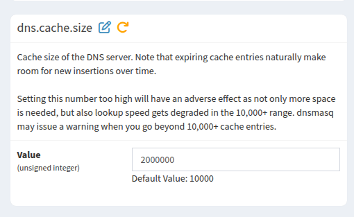

Try Setting DNS cache size.
I run my piholes at 2 Million.

I don't see how increasing the cache to that huge value would help here.

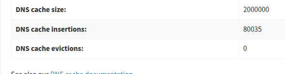

Why?
When evictions tick over my pihole runs slower.

You are not helping your Pi-hole performance with a cache size of 2M.
Cache size of the DNS server. Note that expiring cache entries naturally make room
# for new insertions over time.
#Setting this number too high will have an adverse effect as not only more space is
# needed, but also lookup speed gets degraded in the 10,000+ range. dnsmasq may issue
# a warning when you go beyond 10,000+ cache entries.

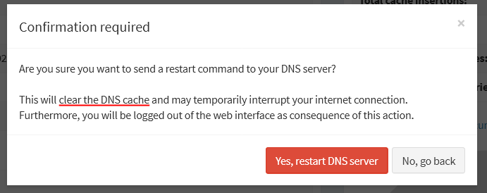

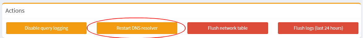

Did you try this button, on the web interface?
I’d rather not break DNS during operating hours, haha.
