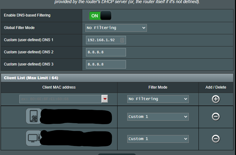

I am new to Pi-Hole. I just installed it on a Raspberry Pi with all of the default settings. I went into my routers configuration and added two of my devices to use Pi-Hole dns, see the included picture.

  3. The "top clients" list in the dashboard shows only my router and localhost. I would expect to see the two devices that I added in my router to use the Pi-Hole as their dns server there. Is it possible to see statistics on a device basis?

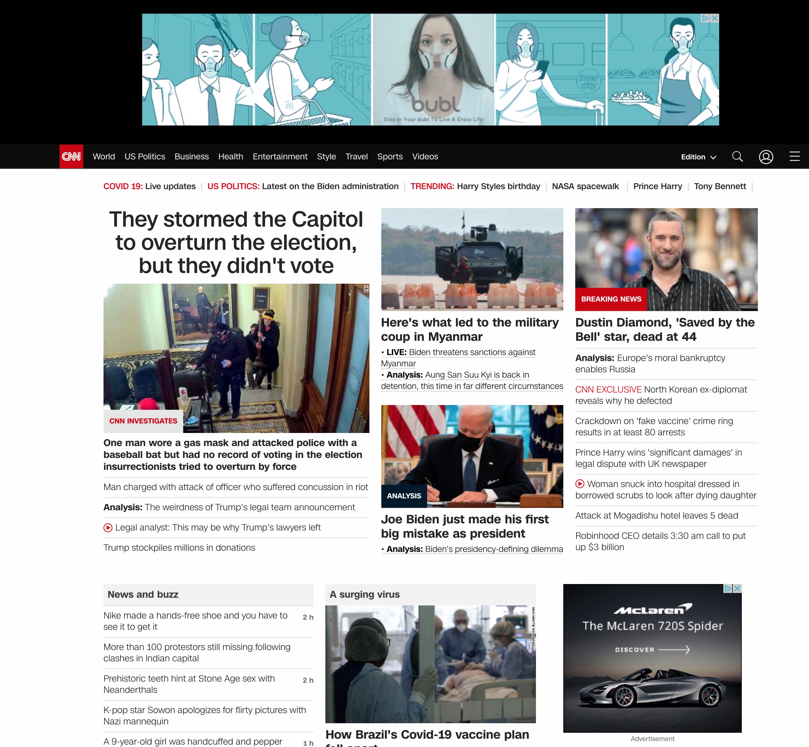

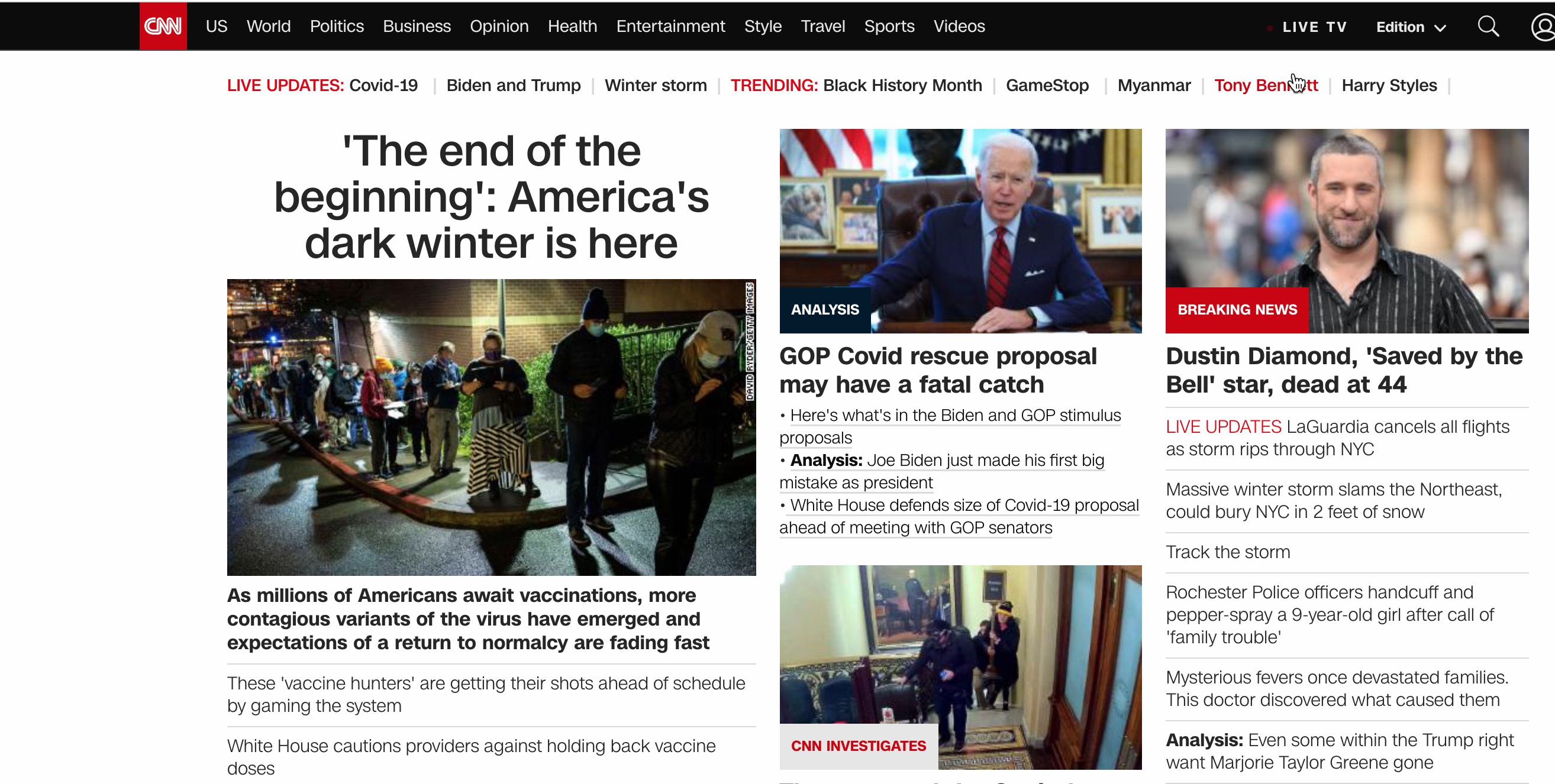

A good website to use to test ad-blocking is cnn.com. Without an ad-blocker, you will see many ads. With Pi-hole active, you should see none.
With Pi-hole:
Without Pi-hole:

  3. That link helped me. Thanks.
