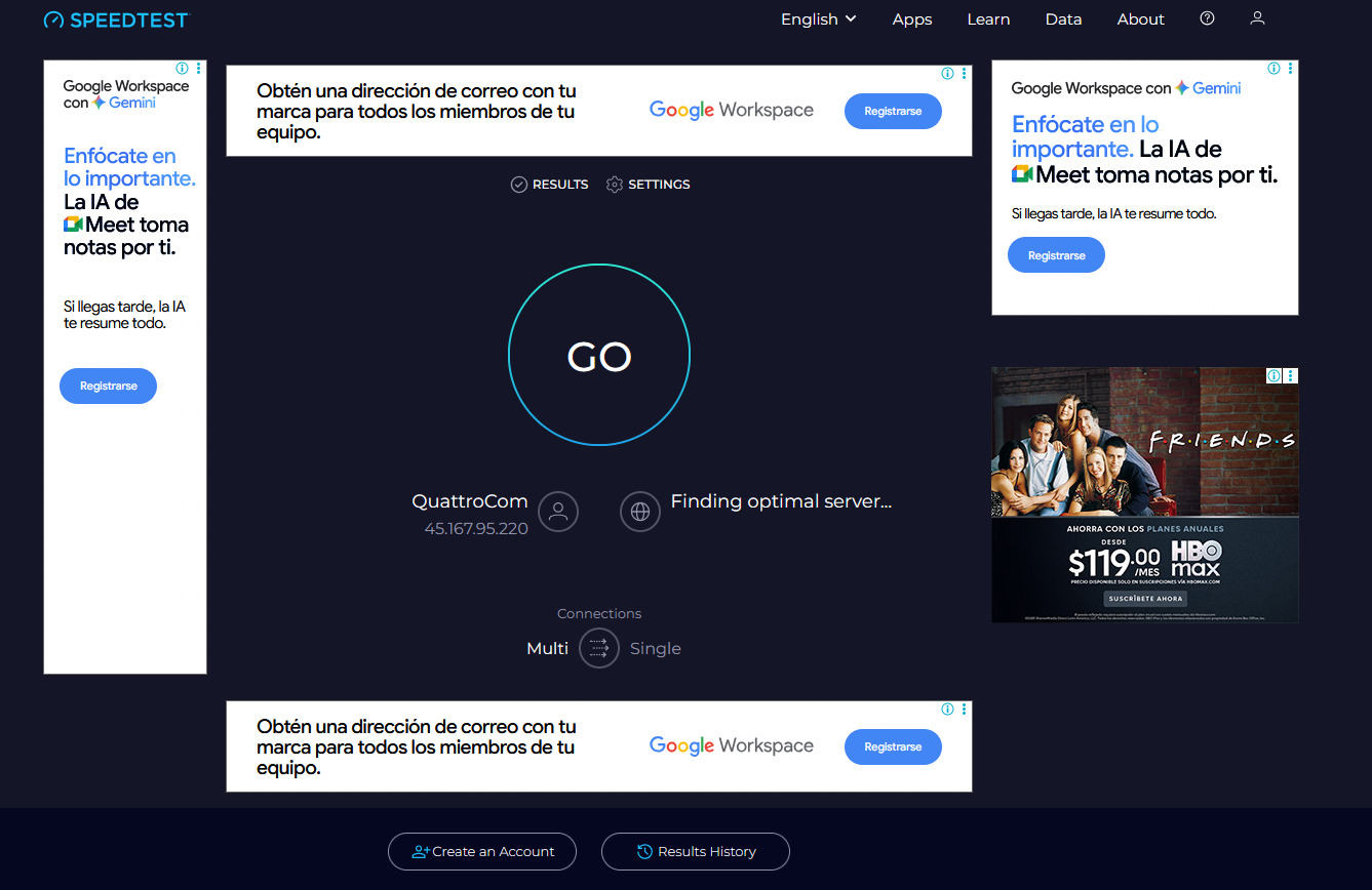

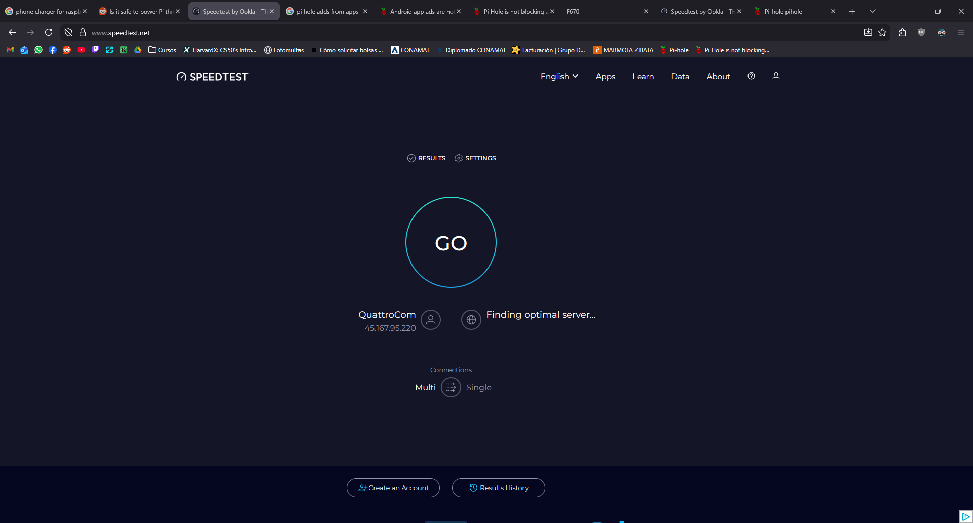

PiHole should block ads from sites like https://www.speedtest.net/
I installed pi hole in a raspberry pi zero 2w
PiHole is not blocking ads from https://www.speedtest.net/ even if i block the specific domain of those ads

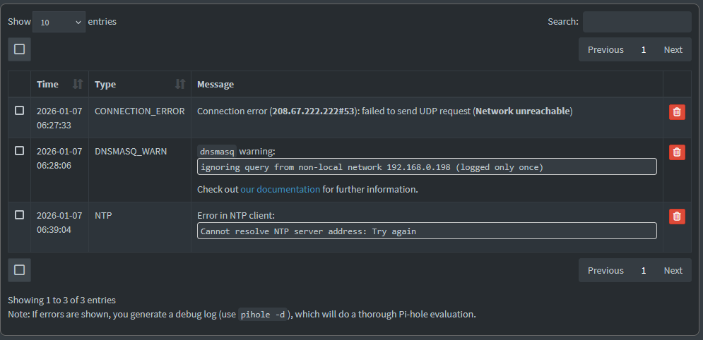

Also is giving 3 errors

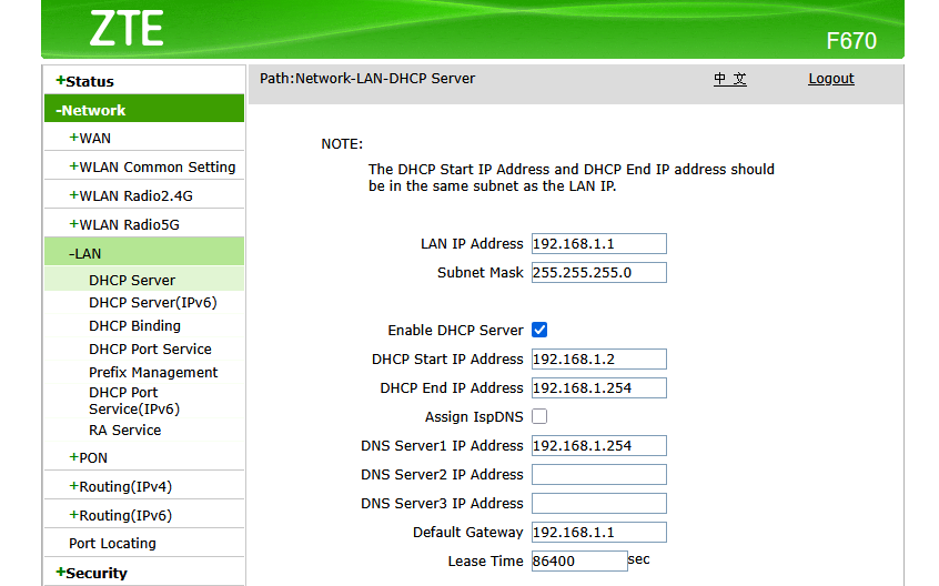

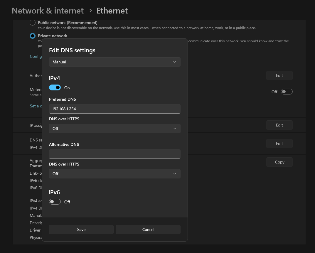

I have set the dns in windows manually and in the router

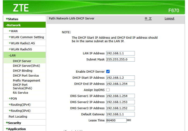

As you can see, the router is advertising itself as DNS server.
You could try to fill the 3 DNS fields with Pi-hole IP. If the router doesn't allow using the same IP for all fields, try 0.0.0.0 or a unused IP.
Using 0.0.0.0 and repeating the pi hole ip returns an error in the router. I have to put two unused ip but the nothing changes with the ads
I also restarted the router and flush dns cache but that didnt help

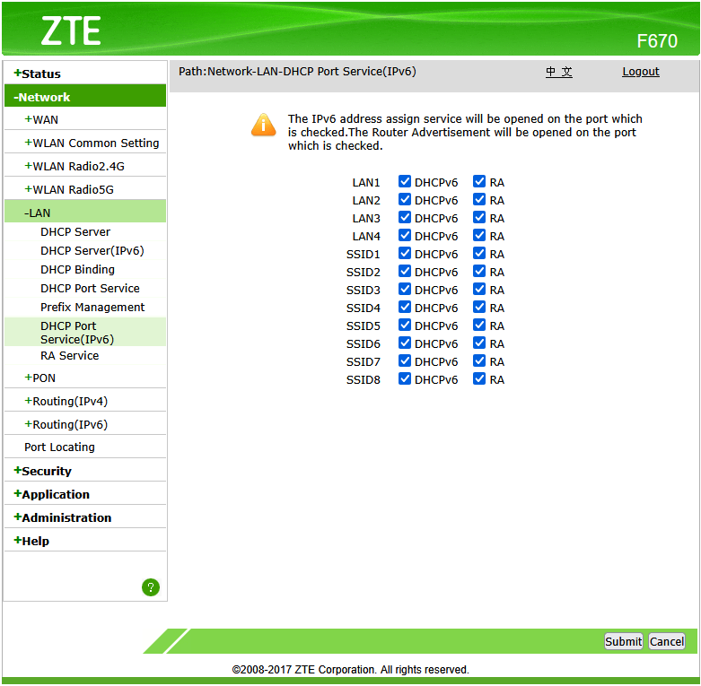

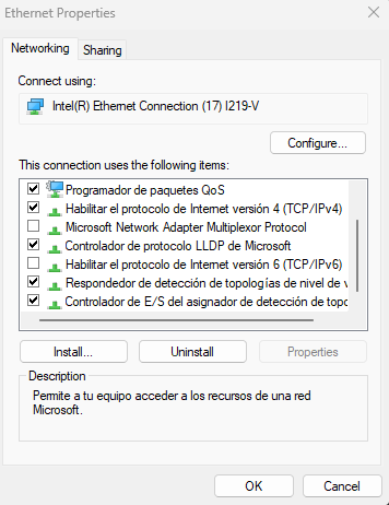

Windows is using the IPv6 (fe80::1) as DNS server.

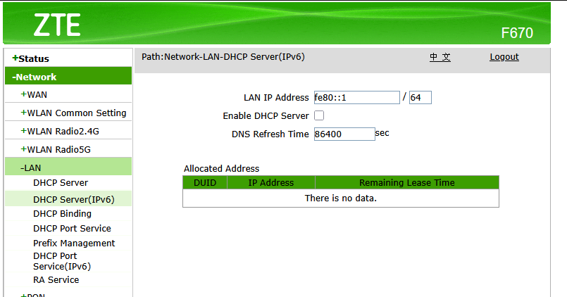

The router shows a "DHCP server (IPv6)" page. Maybe you can change (or disable) the IPv6 DNS server on that page.
Nothing changes
I also disabled ipv6 there

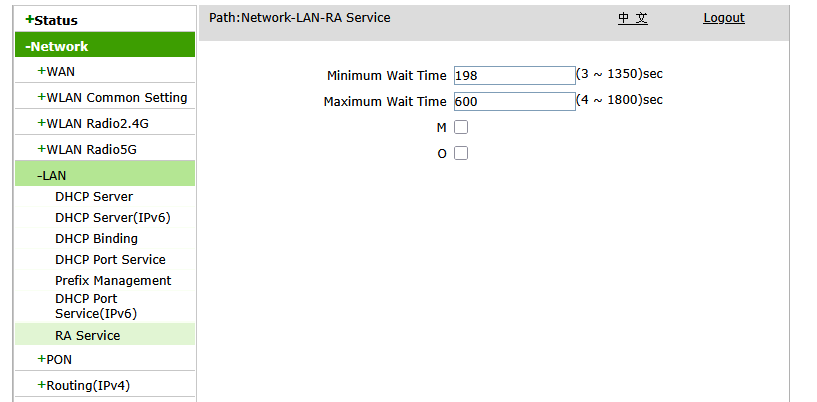

rdwebdesign , doesnt that fe80::1 IP show up in the debug log dhcp-discover output as an RDNSS?
If it does, I think you have to poke in the ZTE router > LAN > RA service settings.
Some hints for another ZTE model below (the bottom paragraph):

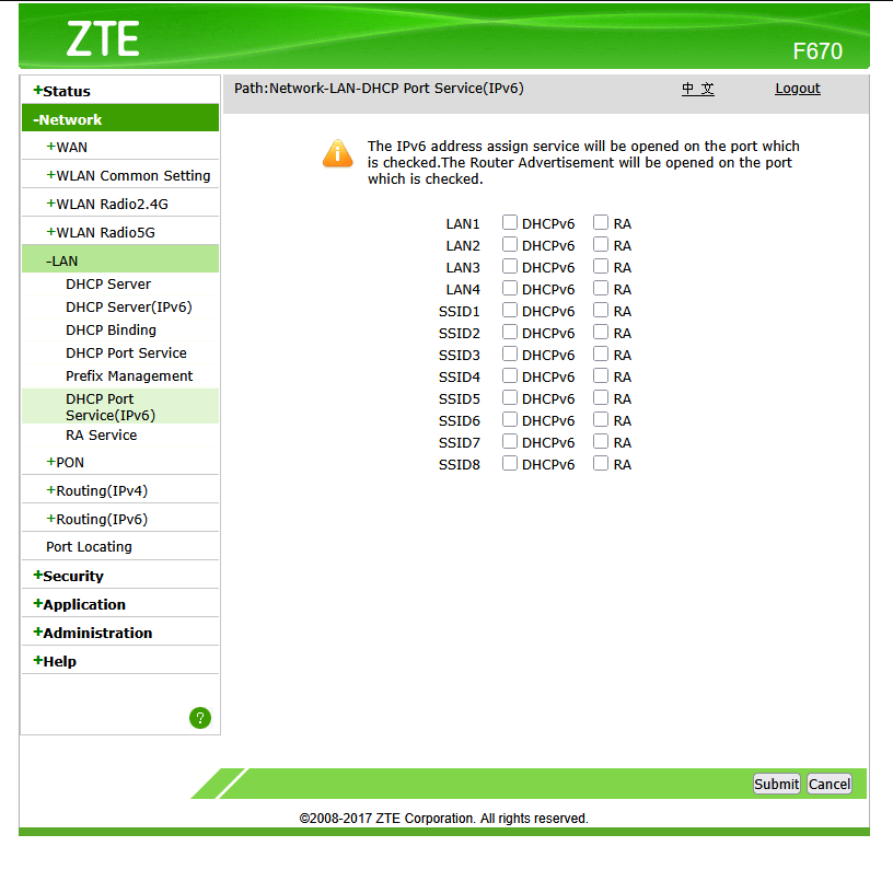

I tried disabling the M and O from RA
And unchecked every box in this too

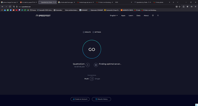

After restarting the router the ads dissapeared in my pc and phone

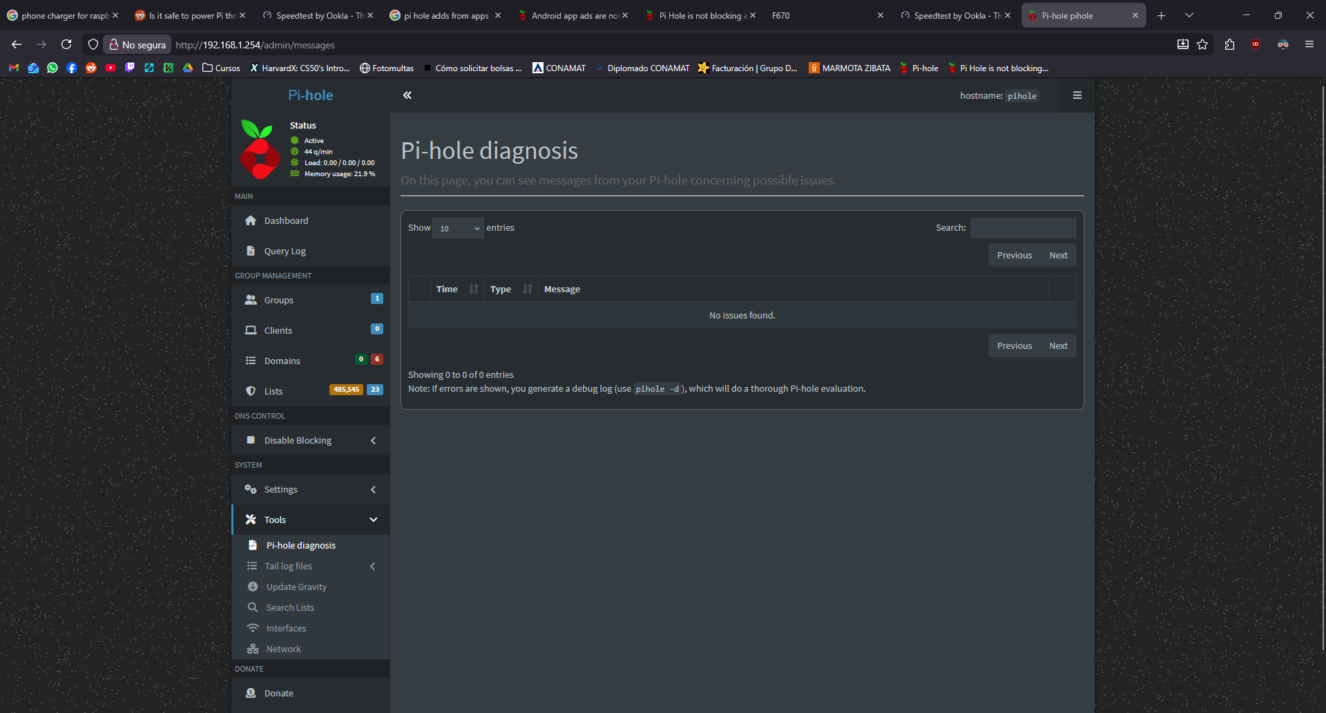

Also the warnings and errors from the diagnosis are gone
Thanks, i was getting a little frustrated haha

Can you restore above boxes and run below one for rdwebdesign to check for any RDNSS (Recursive DNS Server)?
sudo pihole-FTL dhcp-discover | pihole tricorder
Post the resulting token URL pls?
EDIT: Oh you can check too by running only below:
Dont post full output for above one here for privacy!
Look for any lines that start with "Recursive DNS Server"?

I dont see any lines like the ones you say
I think you killed IPv6 entirely
What also comes with those IPv6 RA's, besides DNS servers, is an IPv6 prefix for the clients to construct their own IPv6 addresses (a GUA + maybe a ULA prefix ) via SLAAC .
Now your clients can only talk IPv4.
Ps, whats weird is below DHCP lease time being Infinite :
Alberto_Hdez:
lease-time: Infinite
While on below screenshot is says 86400 seconds:
Alberto_Hdez:
Or you disabled or broke IPv6 somehow on the Pi?
Do the ads appear again with those boxes restored?
EDIT: Oh and what does below output now when run on the Windows box?
netsh interface ipv6 show dnsservers
