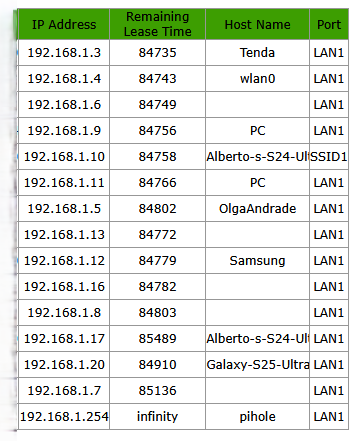

Pi Hole is not blocking ads
Thats because the ip of the pi hole is static
Yes

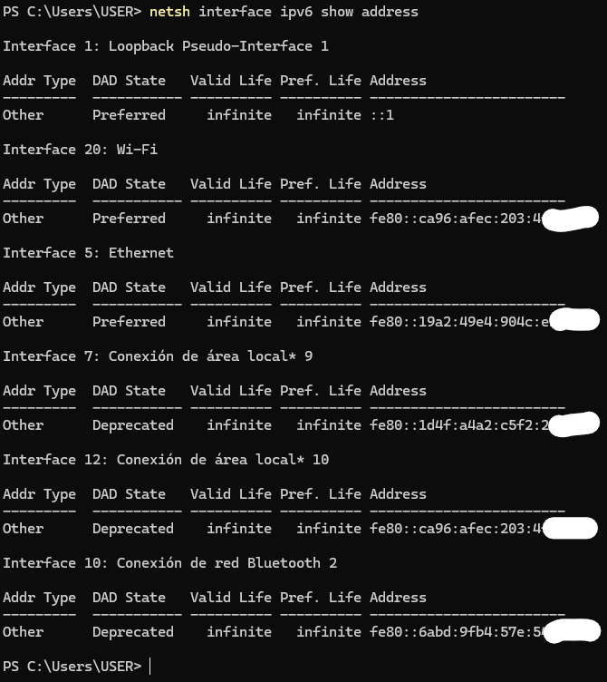

But as the Pi appears to have troubles with IPv6, does that Windows box still have IPv6 connectivity?
What does below output on that Windows machine after you untagged those boxes again?
netsh interface ipv6 show address
Redact the latter part of IPv6 addresses if any are displayed for privacy!!
This is with the dhcp port service ipv6 and RA service boxes ticked

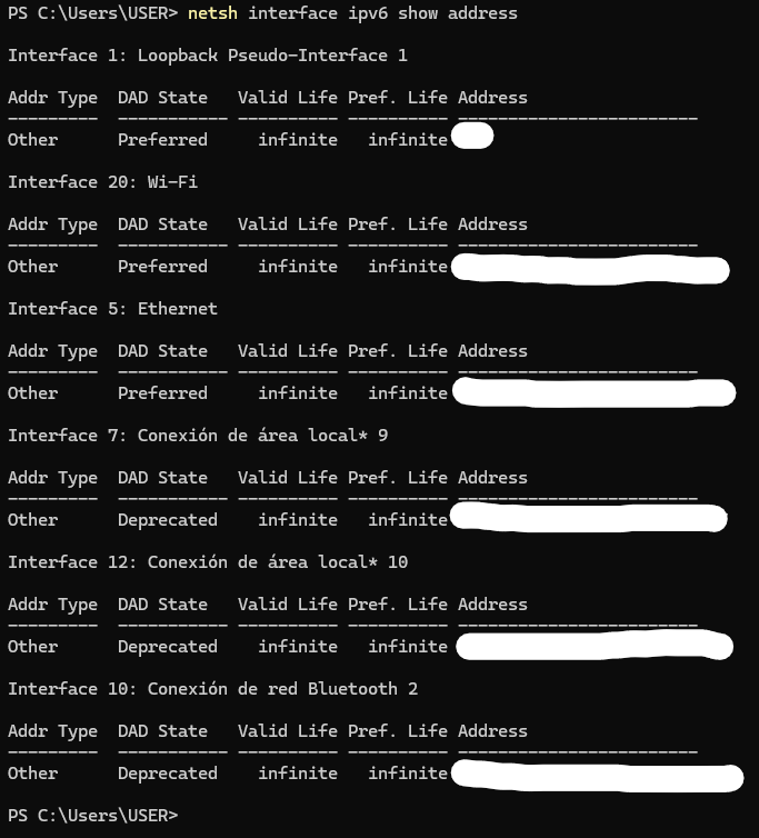

Ahaha I didnt meant for you to redact the full addresses.
Only the latter part eg:
2006:XXXX
That will tell me if if the MS box still has a GUA (Global Unicast Address) to talk to anything on the Internet via IPv6.
Ok that would mean ads would leak in via above fe80::1 address (which is an LLA by the way).

That last screenshot confirms you killed of IPv6 connectivity to the Internet entirely.
For that MS box to connect via IPv6 to the Internet, it needs a GUA address (constructed from the prefix advertised via IPv6 RA).
One that starts with 2XXX: like in below example:
