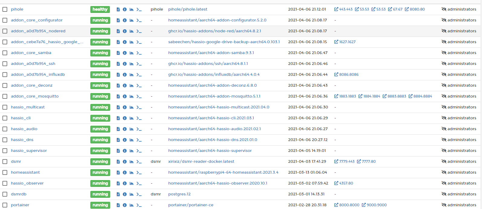

When I generate a docker debug log I do see some errors - But I also read somewhere that debug mode wasn't written voor docker and some errors could be ignored.
Deleted all pihole container and image and started from scratch.

I'm just using a docker setup with a plain install of pihole. Something in my setup a long with pihole or docker or something else is causing this issue that I'm experiencing.
When it happens I do notice that the other applications on the pihole stop responding. I can't access them via the browser anymore. At that moment my network/internet is still working but within a couple secs to a minute my LAN connection also drops (No IP). It's like something is flooding the network and adds up like a snowball until everything stops working.
