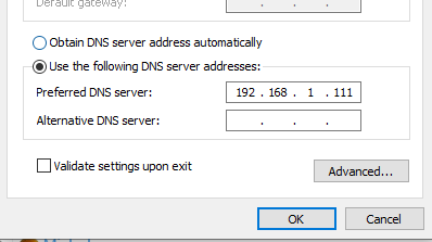

Now that I see this there was a time I filled in the alt. DNS server also google 8.8.8.8. In case my rpi went down or was rebooting I still had internet on my PC. Could that be an issue?

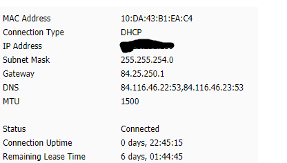

Router is using my ISP DNS settings for the moment.

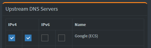

I use Google a upstream DNS

I'm not sure how Windows uses the fallback, but I don't see a way how it could cause an issue.

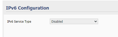

Do you have IPv6 enabled in your home network/router? I have no suspicion about it but it's advertisement-based function sometimes causes unexpected issues, and since it usually does not serve any purpose in LANs, it should be save to disable and see if that changes things. I don't mean to disable IPv4 on the clients, just in the router so that it does not send out router advertisements (simplified the IPv6 variant of DHCP).
No, ipv6 is turned off on my router

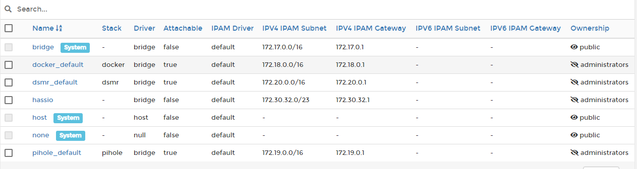

So far my suspicion that it was related to my debian/docker/pihole setup is being confirmed. Although I have no explanation why, seeing that I used the docker-compose file that is on the pihole docker instruction page. And the docker container itself is pre-made and I haven't altered it any way. But this was all the reason for me to post this in the docker section and request help from here.
Perhaps there is a conflict in my docker network although I don't see why. Pihole was on his own subnet.
