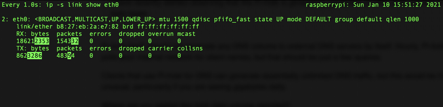

Despite the suspicion that the ASUS Router is giving false information, there is one thing that still bothers me. The screenshot I posted yesterday clearly shows that the Pi-hole downloaded 18 MB which is not a lot but it still is about 20 times higher than jfb's estimation. I am, however, not sure if this traffic includes the "apt get update & upgrade" before installing Pi-hole or not, so I will keep an eye on it.
Pi-hole updates gravity every Sunday morning between 0300 and 0500 your local time. That process downloads domains from your subscribed adlists. This is not DNS traffic, it's a bit of data.
