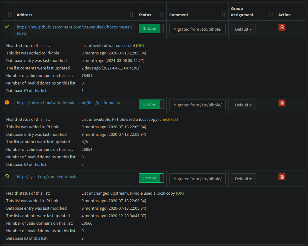

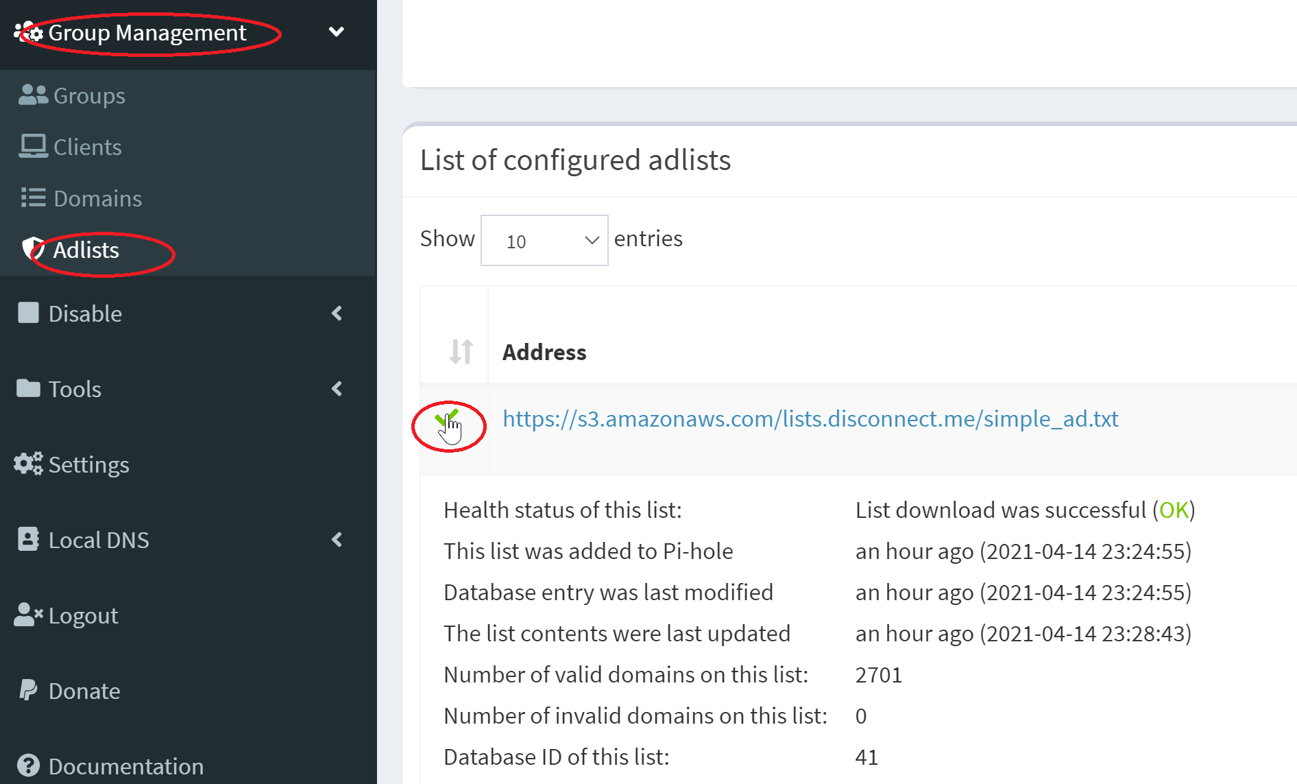

More details for your adlists
The web dashboard does now provide health-status and statistics about downloaded and processed adlists. You can see when they were last downloaded, when they were last changed and it they work at all or contain invalid domains. This aims at simplifying using additional lists.

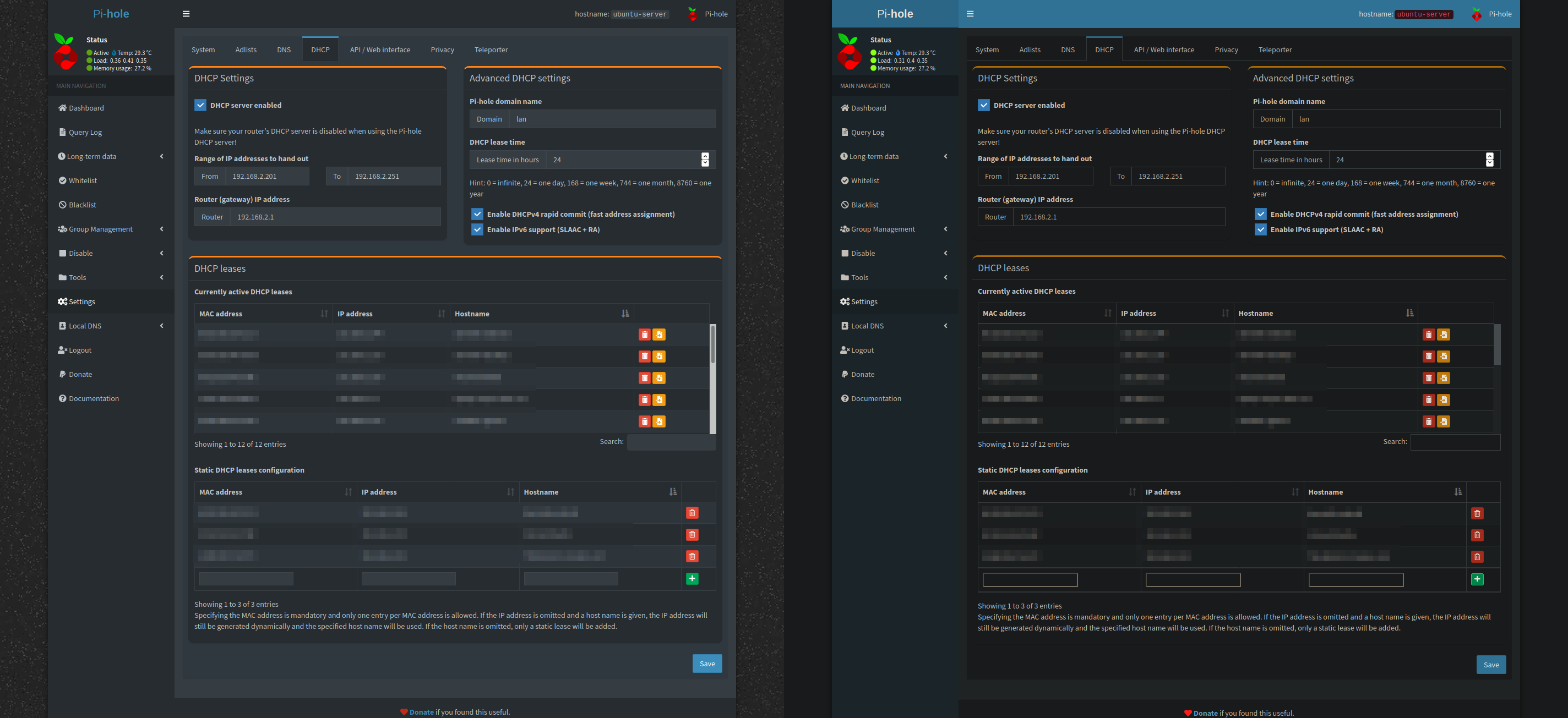

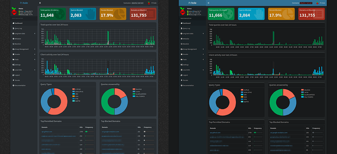

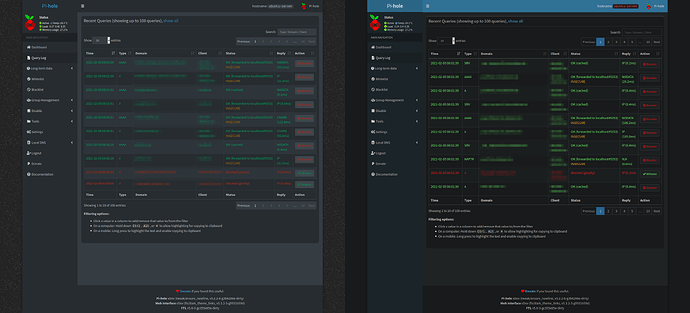

Add Pi-hole darker theme
This PR adds a third default theme, an even `darker` variant of the dark one. It also fixes an issues with the existing `dark` theme where links in box headers (like the Query Log’s “show all”) were completely invisible.
Comparison between the existing dark (on the left) and the new darker (on the right):

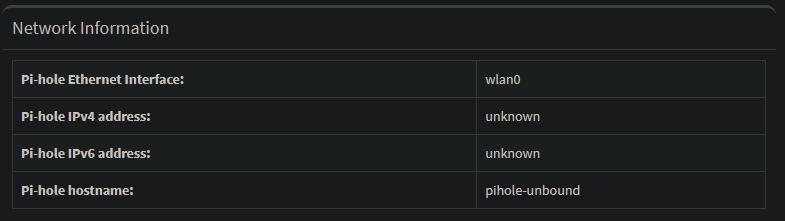

The settings page still relies on those values; without them it just displays unknown:
pihole -d will also still check if the interface's addresses match the values in setupVars.conf.
Thanks for checking. Something we will need to keep in mind for the work on the development-v6 branch

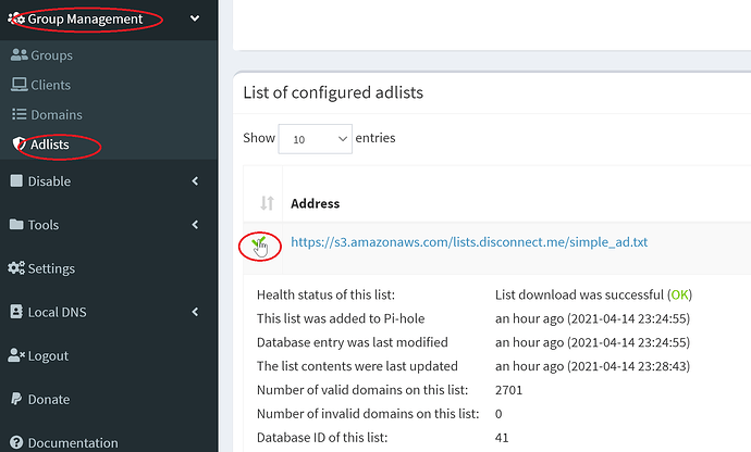

Greetings-
I just updated and I don't see the new adlist feature. Am I looking in the wrong place or do I need to activate something?
click on the icon before the url to expand
Greetings-
Thank you!
