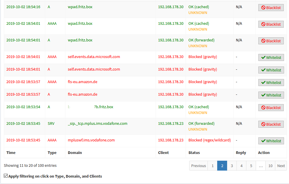

I checked the pi-holes Dashboard. The thing was up and running. Then I checked the query log. I saw countless connections from a connected iPhone to something.ims.vodafone.com. So I tried to block this connections.

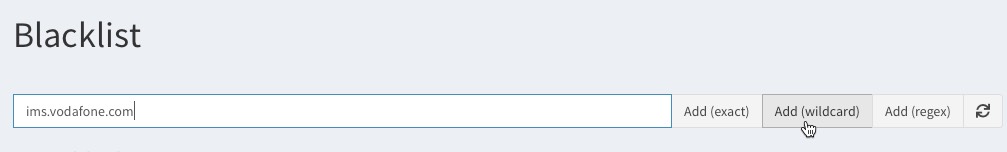

I opened the blacklist on the web-frontend and added ims.vodafone.com with a click on "Add (exact)". It doesn't work, as I could see on the query log. So maybe I should add ims.vodafone.com with "Add (wildcard)"? Sounds good for me - but it didn't work either.

From your debug log, you were including the wildcard characters, which is incorrect. Enter the domain only and then "add wildcard".
   2019-10-02 07:59:15: *.ims.vodafone.de is not a valid domain
   2019-10-02 07:59:18: *.ims.vodafone.de is not a valid domain

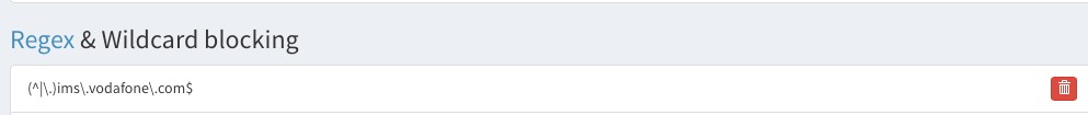

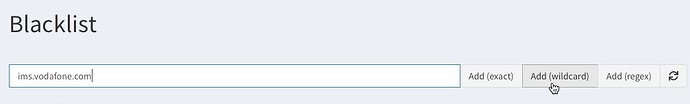

Adding the domain as *.ims.vodafone.com with the wildcard-button was one thing I tried after everything else failed. So yes, it doesn't work, but it has nothing to do with the problem. There is no *.ims.vodafone.com in the blacklist.
You would not expect there to be. When you type in ims.vodafone.com into the blacklist entry window, then select "Add (wildcard)", this entry should go into the regex & wildcard blocking section of that page and the actual line entry would be in file /etc/pihole/regex.list
sudo grep vodafone /etc/pihole/regex.list
(^|\.)ims\.vodafone\.com$

What is the output of the following:
cat /etc/pihole/regex.list
(^|\.)lithium\.com$
(^|\.)ims\.vodafone\.de$
Take a look in your pihole log and let's see what is happening with these domain requests:
sudo grep ims.vodafone /var/log/pihole.log | tail -n30
sudo grep golem /var/log.pihole.log | tail -n30

But I still have the problem that I cannot block something.ims.vodafone.com for some reason. I can only block parts of it:
That is a SRV request, not an IP request (A or AAAA).

sudo grep ims.vodafone.com /var/log/pihole.log | -tail -n30
Oct  2 19:11:10 dnsmasq[3399]: query[AAAA] mplusps.ims.vodafone.com from 192.168.178.23
Oct  2 19:11:10 dnsmasq[3399]: /etc/pihole/regex.list mplusps.ims.vodafone.com is 0.0.0.0
Oct  2 19:11:10 dnsmasq[3399]: query[SRV] _sip._udp.mplus.ims.vodafone.com from 192.168.178.23
Oct  2 19:11:10 dnsmasq[3399]: forwarded _sip._udp.mplus.ims.vodafone.com to 2606:4700:4700::1001
Oct  2 19:11:10 dnsmasq[3399]: query[SRV] _sips._tcp.mplus.ims.vodafone.com from 192.168.178.23

Neither the SRV or NAPTR requests will be blocked by Pi-Hole.
I would look at the software on the iPhone and see what is driving the requests.

Oh, that is easy. It's my landlords wife smartphone. Vodafone is her provider). I might take a look at it. I believe it's a "use wifi for calls"-setting or something like that.
Well.... it sounds like it is not possible to handle them like all other blacklisted requests? I'm a bit puzzled why pi-hole is answering the requests, but maybe I get the concept wrong. I thought, if I set a name on the blacklist it would be blocked no matter if its a name record or mx or whatever.

The domains I talked about are actually blocked. But the request type (SRV) is not blocked by pi-hole.
