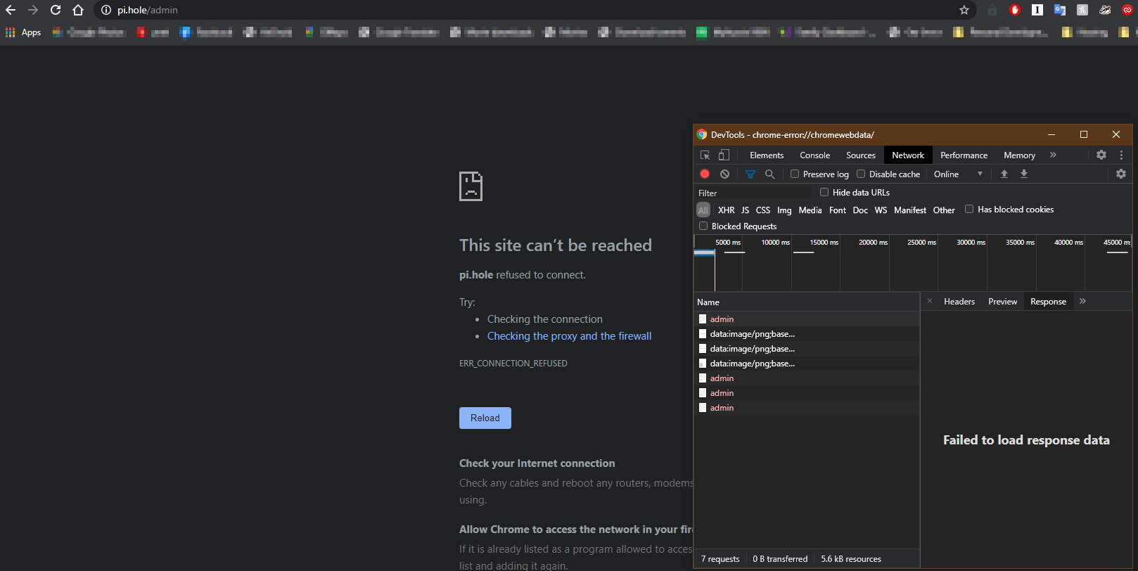

But now I cannot access the web ui via http://pi.hole/admin. I get "site can't be reached" error.

If a client cannot connect to the URL http://pi.hole/admin, this is typically because the client's DNS server cannot resolve the domain name pi.hole. The only DNS server that can resolve this domain name to the correct IP is Pi-hole itself, since this name is mapped internally to Pi-hole. In your case, if the client from which you are running the browser is not using Pi-hole for DNS, this is the expected result. If you change the URL to use the IP instead of the Pi-hole domain name, and the client can load the page, that's your problem. Example URL below (substitute your Pi-hole IP):
http://192.168.0.100/admin

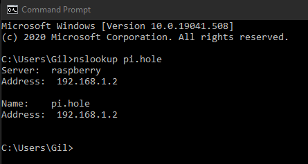

Please share whether nslookup would still return your router as DNS server.
here's the screenshot of that:
Looking good so far: Your Windows machine is using Pi-hole as DNS server, at least for that request.

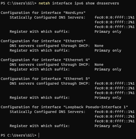

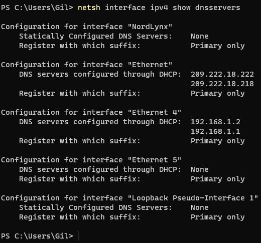

And let's have a closer look at all DNS servers that your Windows knows about:
netsh interface ipv4 show dnsservers
netsh interface ipv6 show dnsservers
doesn't look good. new debug token at the bottom.

Your IPv6 DNS servers look ok.
fec0:0:0:ffff::1 to ::3 are site-local anycast addresses for DNS servers - long deprecated, but Windows still statically defines them in absence of any other DNS severs.
This would be in line with your network not having IPv6 connectivity, as indicated by your debug log (by link-local fe80 address only, no IPv6 gateway). (And you don't need IPv6 to access the Internet at all.)
In short: Nothing to worry about.
For IPv4 however, there are indeed 3 additional DNS servers: Your router at 192.168.1.1 on your "Ethernet 4" interface, and two public ones on your "Ethernet" interface.
While the latter probably stems from a VPN setup presumably using PIA (privateinternetaccess) as a VPN provider, the former is proving that your router is configured to distribute itself alongside Pi-hole as DNS server.
You should get rid of that router entry in your router's DNS settings, or any client will bypass Pi-hole over time as a client sees fit.
Any contact established via the presumed VPN connection will also not being filtered through Pi-hole.
You'd have to consult your VPN provider if and how you can inject a custom DNS server into your VPN connection.
And finally, you should also heed jfb's above advice on verifying your group management in Pi-hole.
