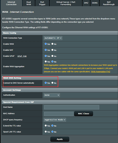

In my WAN settings, I have the following as in the screenshot. The reason is, I thought the router gets the DNS from the Pi Hole.
Should I select No and add the IP of Pi-Hole?

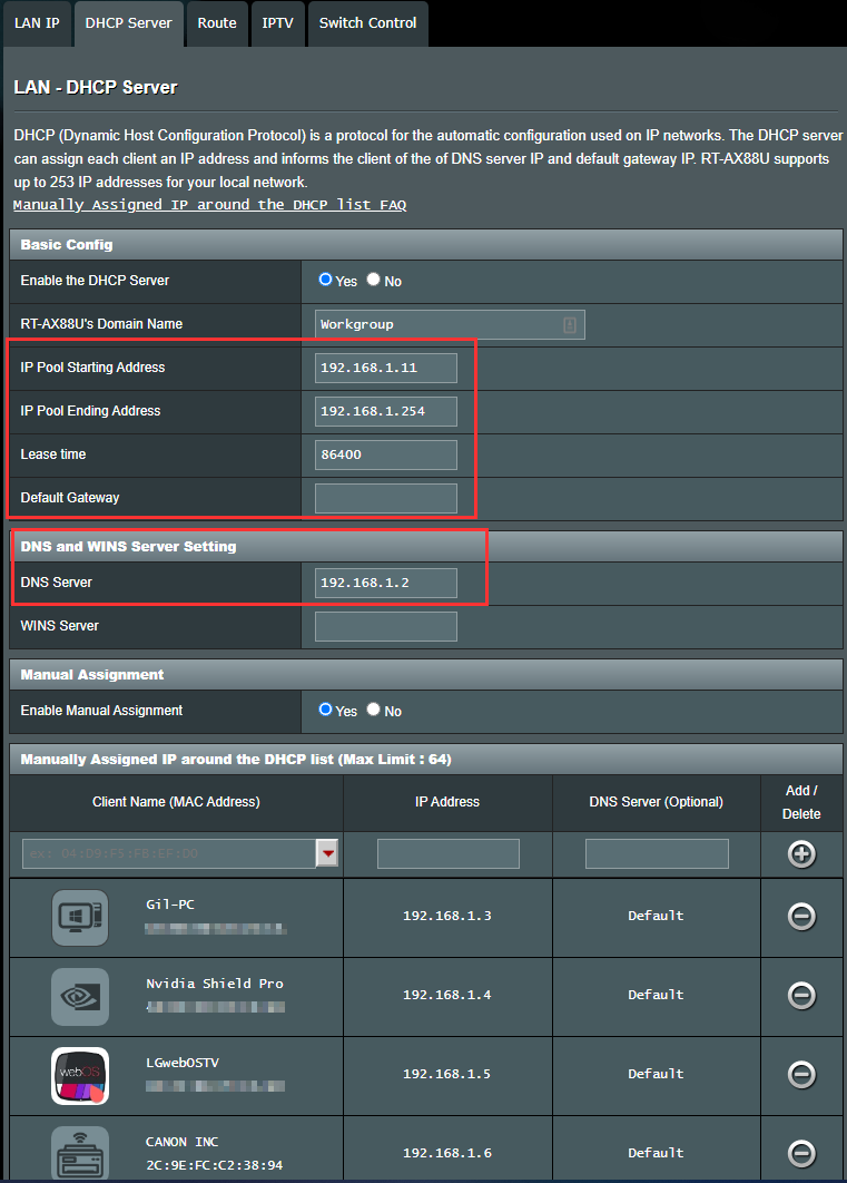

My LAN-DHCP Settings as seen in the screenshot. Is this set correctly?

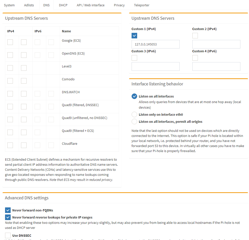

Additionally, I have the Pi's DNS set up as seen in the screenshot below. Is this OK?

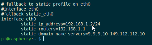

Before you do that, make sure that Pi-hole has a static IP assignment in place.
Take a look at /etc/dhcpcd.conf:
grep -v '^#\|^$' /etc/dhcpcd.conf
As far as I understand from what I read, it simply gets the DNS from my ISP.
If I set it to NO, then it opens two fields, DNS1 and DNS2 for me to enter manually.
The only reason it was set to YES (obtain from ISP) was that I thought it would pick up the Pi-Hole's DNS.
The confusion is what the hell is the DNS under LAN settings do?
Here's my assumption:
DNS under LAN settings tell all the clients in my LAN to use the local DNS if I chose to.
WAN DNS tell all the clients that request internet access which DNS to use.
If this is a correct assumption, then the LAN DNS should remain empty, because I don't care about local requests, and set the WAN DNS to use Pi-Hole instead of my ISP.

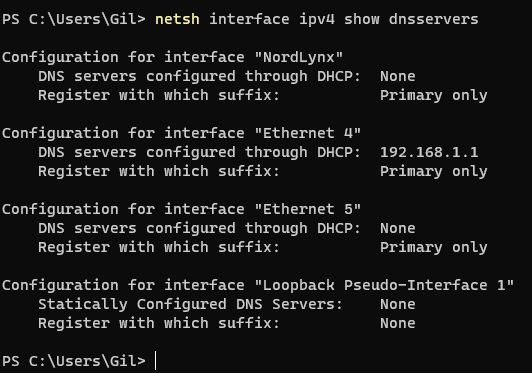

Running netsh interface ipv4 show dnsservers
Ethernet 4 is the port I use for wiring my PC.
This is the critical path for using the right DNS.
After flushing the DNS and restarting the router and making sure the Ethernet 4 is obtaining DNS automatically, it is still showing 192.168.1.1, instead of 192.168.1.2.
How do I overcome this besides setting it manually?

Lastly, did I set the Pi's DNS correctly?

Your router does not allow for 1.), as your netsh for IPv4 DNS has proven that it distributes itself alongside Pi-hole, despite you having only defined Pi-hole as DNS via your router's DHCP settings.
To mitigate this, you can either have Pi-hole act as your DHCP server, or go for option 2.).

When you are back online and if no answer is given by then, can you please confirm if the pi-hole's DNS settings are configured correctly?

And since your latest netsh interface ipv4 show dnsservers shows only your router 192.168.1.1 as local DNS, it would seem that you already removed Pi-hole from your router's DHCP.

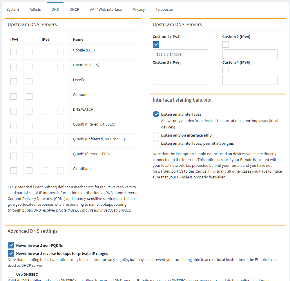

You've configured Pi-hole to use some local upstream resolver on the same machine at 127.0.0.1#5053. Is that cloudflared?

Yes.
I followed the DNS over HTTPS guide here: Redirecting...
BUT, DoH while claiming it is secure still depends on normal DNS over port 53 to locate the DoH server so is not, secure. I might try Stubby DoT Implementing DNS-Over-TLS - #8 by bbunge

If your dhcpcd.conf is still looking as posted by you above, and your Pi-hole machine is connected via Ethernet (eth0), then you can switch off your router's DHCP server and enable it on your Pi-hole via Settings | DHCP.

Your choice of upstream DNS would depend on your personal preferences.
If you are worried about third-party eaves-dropping, you may opt for DoH or DoT.
While this is an area of concern for nomadic devices (e.g. a laptop in a public WLAN cafe), this is hardly an issue when at home, and you should also be aware that any DoH or DoT DNS service provider would still have your complete personal DNS history in any case.
If you are concerned about privacy, consider unbound instead:
DNS queries are resolved recursively starting with the root servers, so no single DNS server will ever have your full DNS history.

I hope it shows it. I'm also still using cloudflared DoH.
