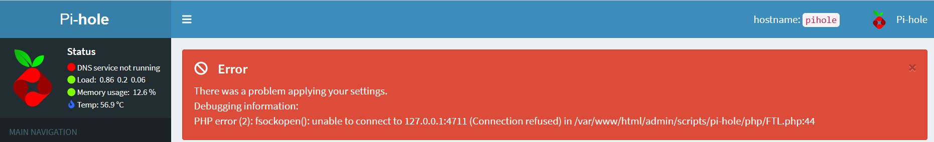

One in a while PiHole drops off-line as can be seen in the clip below. This is what I saw when I started work this morning. This happens every couple of weeks. Debilitating as we rely on it. I "restart system" command from the PiHole menu did not help but a reboot command issued via Remote Desktop did -- for now.
I am running the current versions.
Any solution?
