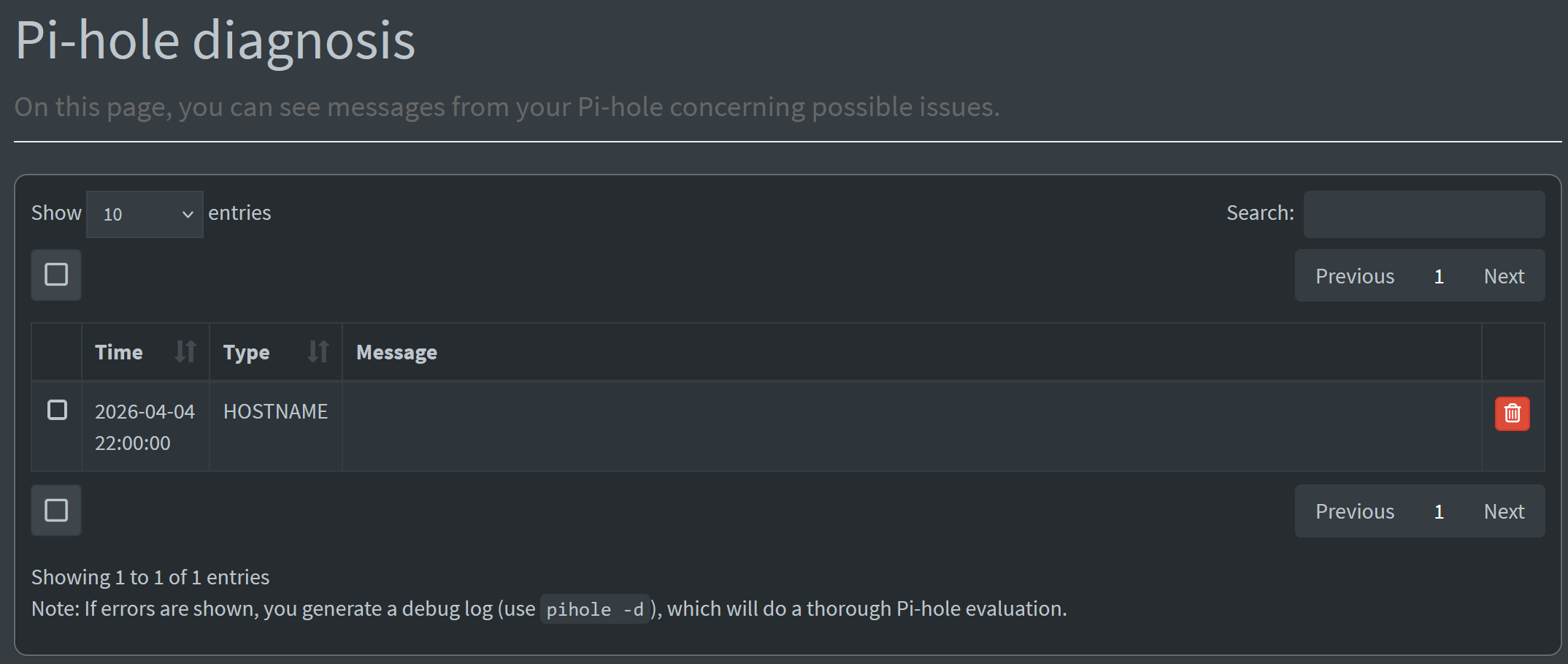

Pi-hole diagnosis: HOSTNAME (empty message)
No diagnosis entry at all in the first place. But when there is one at https://pi.hole/admin/messages, I'd like to have it an actual content.
Nothing in message.
FTL.log contains:
2026-04-04 22:00:00.687 ERROR DNS compression pointer out of bounds: 932
2026-04-04 22:00:00.687 ERROR Trying to copy a NULL (R) string in ngethostbyname() (/app/src/resolve.c:452)
2026-04-04 22:00:00.687 WARNING Resolved PTR "DDD.CCC.BBB.AAA.in-addr.arpa" on 127.0.0.1#53 (UDP) with status NoError (0): answer 0 (PTR "DDD.CCC.BBB.AAA.in-addr.arpa" => "(null)") is invalid
2026-04-04 22:00:00.687 WARNING Host name of client "AAA.BBB.CCC.DDD" => (null) contains (at least) one invalid character at position 0
2026-04-04 22:00:00.688 WARNING Trying to free NULL pointer in ngethostbyname() (/app/src/resolve.c:474)
2026-04-04 22:21:38.995 INFO Received 8/8 valid NTP replies from fritz.box
2026-04-04 22:21:38.996 INFO NTP time offset: 1.639026e+00 ms (excluded 1 outliers)
2026-04-04 22:21:38.996 INFO NTP round-trip delay: 3.329686e-01 ms (excluded 1 outliers)
Interestingly, this
exists every hour. Therefore not sure why
  1. this is logged now only (assuming this log entry is the reason for the entry on the diagnosis page)
  2. the diagnosis page shows nothing (so one could actually 100 % be sure what's wrong)
Following https://pi.hole/admin/network I find
AAA.BBB.CCC.DDD (shelly-another-word-ofthehostname-powerzaehler.fritz.box)
No idea what's wrong. If the "zaehler" would be a "zähler" I could partly understand this but... hmm.

In fact there are many other clients with a hostname containing German umlauts (ä / ö / ü). Always have been, for years. No idea why at all (probably since some Pi-hole update a few months ago, maybe even since v6 which I upgraded to very late) and why only for that one single hostname/client Pi-hole is complaining.
Gave option 2 a try over at https://pi.hole/admin/settings/dnsrecords, guess I will now need to wait for the next full hour and check FTL log...

Anyway, since the local record no more hourly FTL log entries related to this anymore.

Now diagnosis page is showing the empty HOSTNAME issue again. According to FTL log this time for another client, also containing an umlaut (ö in this case). Same story, every hour. I can't edit the hostnames in the router and setting all of them up in https://pi.hole/admin/settings/dnsrecords would be crazy. --> Workaround after spending a lot of time: created local DNS records.
I'm wondering why
  1. does the diagnosis page show an empty message column
  2. does FTL discover only one "problematic" (in my opinion handling an umlaut should not be one) one by one
  3. is FTL bringing this up now when it did not in the past (some umlaut hostnames are older than Pi-Hole in my network)
Edit: some truth on those questions (explicitly at least/only 3) seem to be found at Pi-Hole reports wrong name for local network devices (specifically Pi-Hole host itself defined in /etc/hosts). Unfortunately that topic is locked meanwhile.
  • The router provides several (partly also historic) hostnames, which certainly is one (the) root cause.
  • The way Pi-hole is handling this (questions 1 and 2) still is not perfect yet.

Did not see the diagnosis page entry or something related in FTL.log anymore since creating local DNS records for problematic hostnames.
I think the FRITZ! router basically handles that transformation quite well. But I fear during the years even though (or maybe because of?) regularly updating the FRITZ!OS, some kind of trash has been collected for several (potentially older) hostnames. One user mentioned there's a "fix" (workaround?) to do a factory reset (hardest way) or creating a backup, doing a factory reset and restoring the previously manually checked and cleaned backup file. Quite hacky and honestly I expect FRITZ! to take care of consistent IP and hostname tables. In fact, the things presented in the UI is not the reality under the hood. And for me and others that causes or supports several issues, ending up e. g. in this topic.
