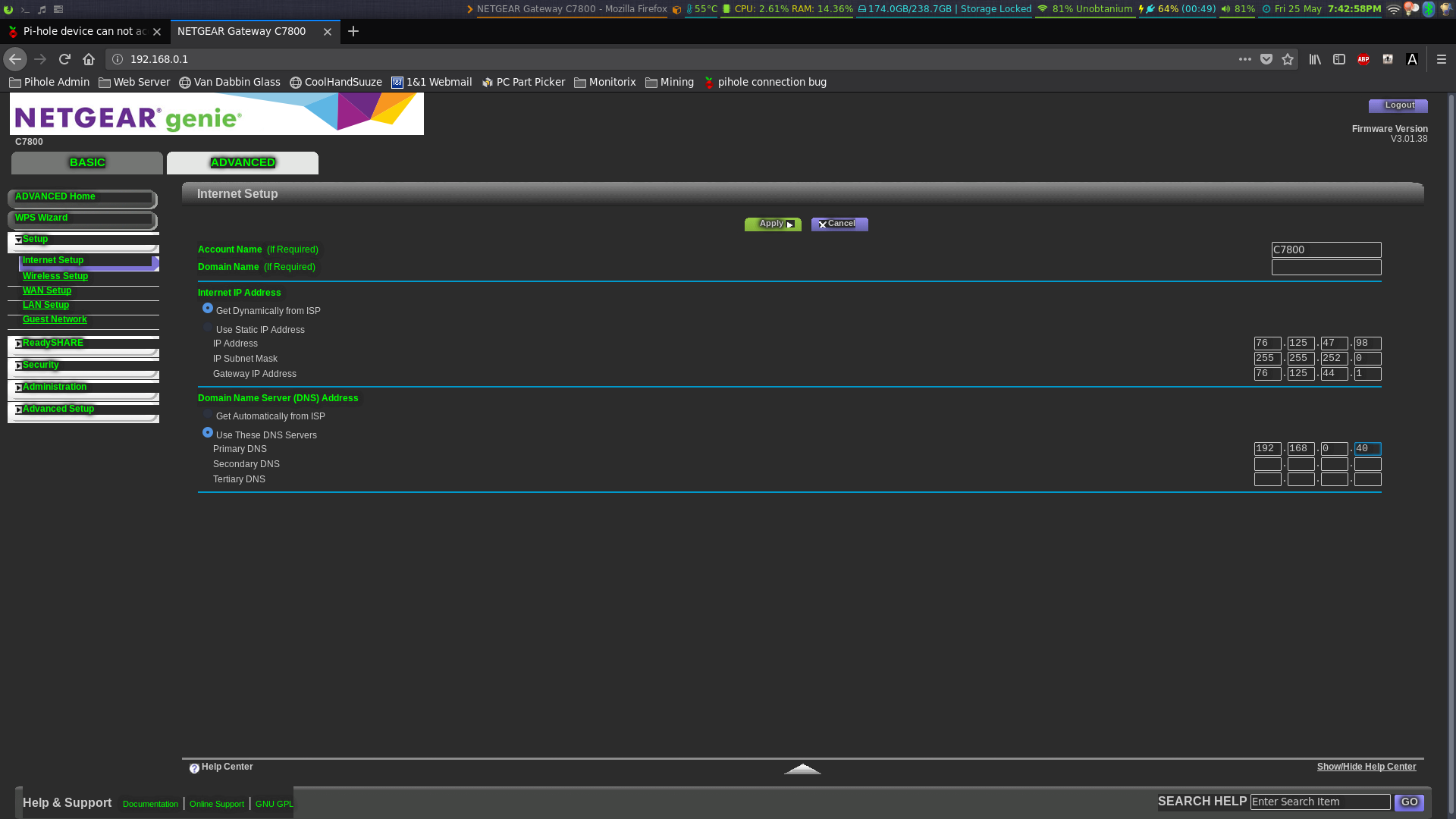

Can you send a screenshot of where you are setting it in your router?
Yeah, I think that's setting your WAN DNS servers. Try looking for DNS/DHCP settings under the LAN section.
Other then a category for Dynamic DNS Service thats the only option mentioning dns on the router settings.
Perhaps I need to use the pihole as the dhcp server. I'll give it a try later when I have time
