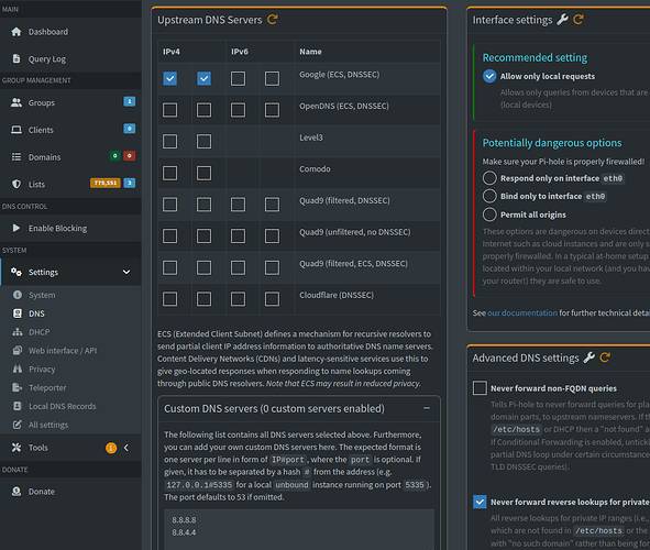

If I simply run the container, everything starts as from a Pihole container perspective just fine. However, it doesn’t seem as any queries are being blocked as normal nor are any queries being made.
However, if I change the DNS settings to one of the potentially dangerous options (Respond only… or Bind to...) it will start to log queries and log some as blocked. However, I’m not confident in this setting as I’ve never had to use this in the past.

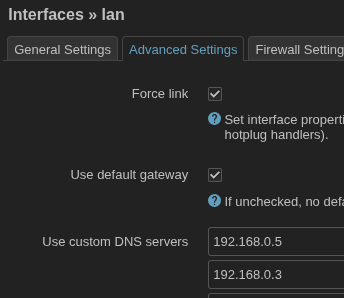

In the past, I’ve usually just added the custom Pihole IPs to the custom DNS fields under Interfaces → LAN →Advanced Settings

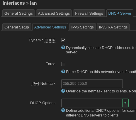

I’ve seen mention of DCHP-Options, but I’m not sure it helped, so I removed them.

https://tricorder.pi-hole.net/0qetXaMr/
This option is needed if you are running a container using brigde network mode.
From our README file - Tips and Tricks:
  • Docker's default network mode bridge isolates the container from the host's network. This is a more secure setting, but requires setting the Pi-hole DNS option for Interface listening behavior to "Listen on all interfaces, permit all origins".
Thanks for the reply - Permit all origins setting seems to have done the trick!
Just to clarify, it seems we only need provide the IP of the host within the router under custom DNS servers, yes?
Interfaces » lan » Advanced Settings » Use custom DNS servers:
I have since removed or cleared any settings, fields which were suggested in the links I used in the initial setup/troubleshooting:
  • Interfaces » lan » DHCP Server » DHCP-Options: has been left blank
