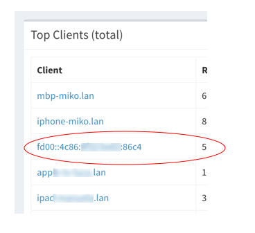

Blocking (IPv4 and IPv6) and DHCP are working well, however, in the Pi-hole dashboard clients are showing the correct hostname only for IPv4.
IPv6 names are not resolving.

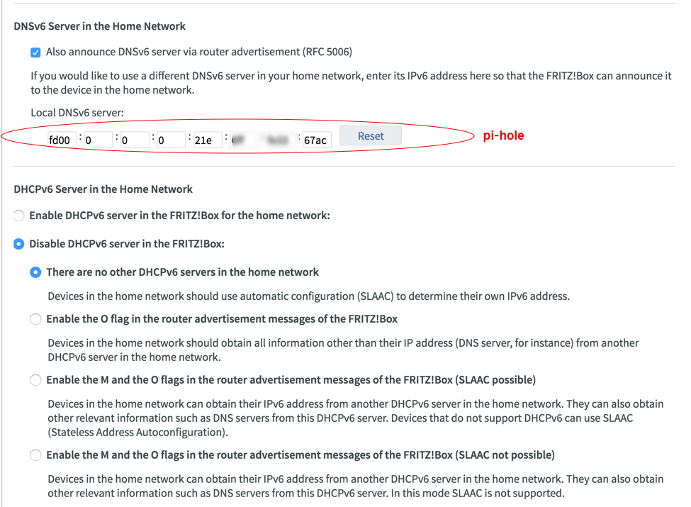

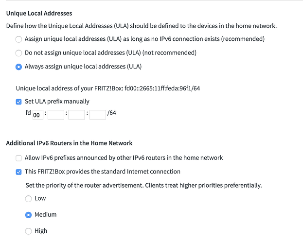

IPv6 Settings:

Pi-hole as DNS and DHCP

Clients are resolving hostnames only for IPv4.

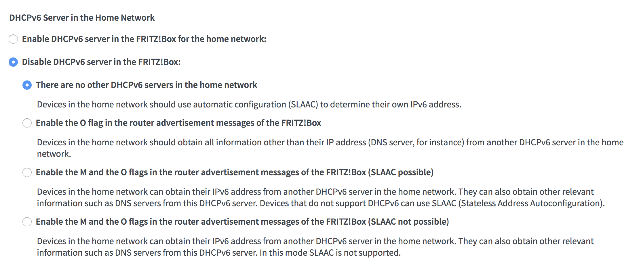

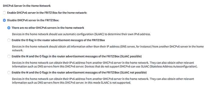

I have completely disabled the DHCPv6server on the fritzbox.

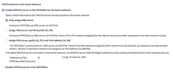

Or should I enable one of the options below?
Thank you for any suggestions :slight_smile:
I would select the option in the first picture (disable DCHPv6 in the FRITZIBox) for the SLAAC possible.
Hi, jfp,
That option is what I have been running. IPv6 and IPv4 are working great.
My only issue remaining is the Clients list showing hostname and IPv6 other than just hostnames...
Not a real drama but it would make identify users a little faster.

(fd00:1234:5678:1 is the ULA ipv6 address from my FRITZ!Box shown in the settings)
