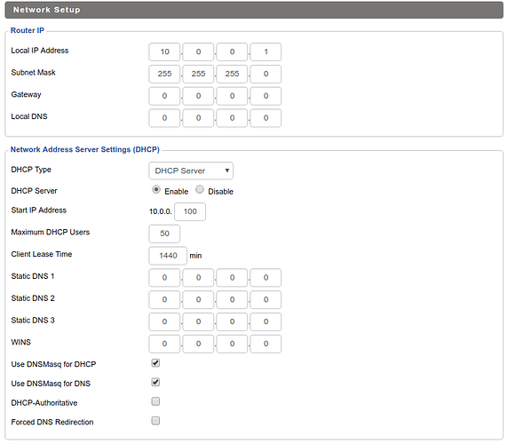

I use a cisco e900 router with DD-WRT v3.0-r39137M mega (10/03/19) and an Orange Pi One with ARMbian Strech.
IP Router 10.0.0.1
IP Pi-Hole 10.0.0.141

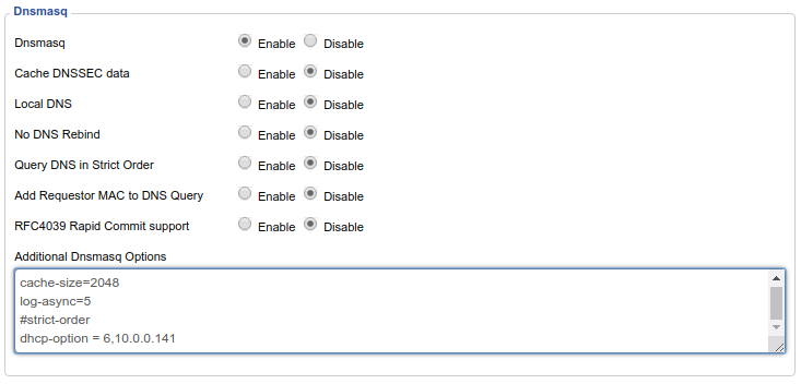

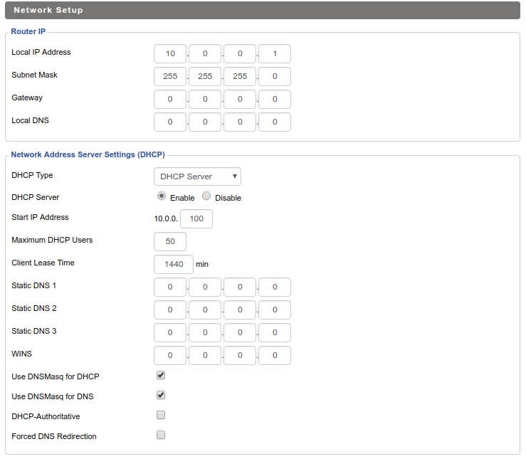

DD-WRT configurations
Dnsmasq
server=10.0.0.141
cache-size=2048
log-async=5
#strict-order
dhcp-option = 6,10.0.0.141

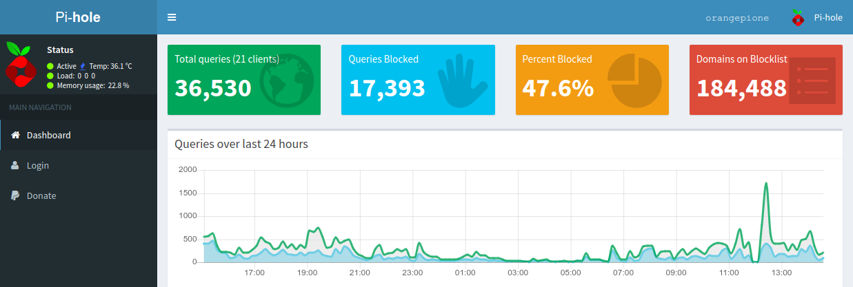

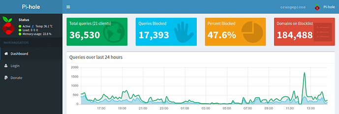

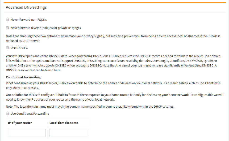

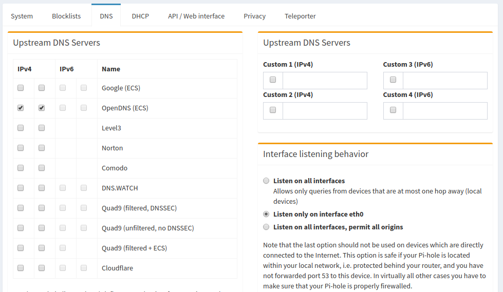

Configurations in my Pi-Hole

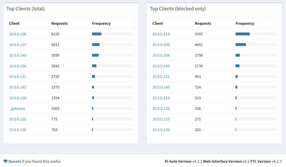

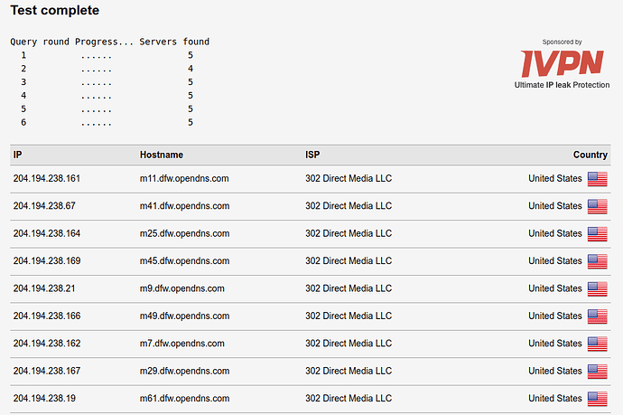

And this is the result in my Pi-Hole
