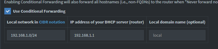

Conditional forwarding: pihole wants to know the hostname of an IP address, pihole sends a reverese DNS lookup (PTR record), DHCP server (router) replies with a hostname.
Pihole sends the PTR record to the router, the router doesnt reply with a hostname.
I tried setting up the local domain to 'lan' or 'local' and tried to disable "forced DNS direction" and didnt work. I am not sure what DDWRT setting would make the DHCP server reply to the request. Sorry if this is more suitable for DDWRT forums

Your nslookup results confirm that your router does not provide DNS replies.
For local host name lookups and private range IP reverse lookups, your router's DNS server should have replied correctly if it knew the answer, or NXDOMAIN if it didn't.
A time-out as you observe it may suggest inability of your router's DNS server to contact its upstream (though it shouldn't have forwarded any of your requests upstream if it had known the answer), or perhaps a DNS loop. You could have closed such a loop by using your router as one of your Pi-hole's upstreams, or by enabling Pi-hole's Conditional Forwarding to your router.
What solved the problem is to enable the DNSmasq ("use DNSmasq for DNS") on the dd-wrt. However, when that's enabled, the forced DNS direction doesn't work.
So, every month or so, I will enable DNSmasq on the router main page, let pihole get the hostnames for all clients, then disable "use DNSmasq for DNS". I'm happy having the list update once month. I don't have that many new clients anyway.
If that's the case, you could consider to add the respective Local DNS Records for your clients to Pi-hole. That's a one-time effort, provided your router would be configured to assign a fixed IP to each of your clients.
