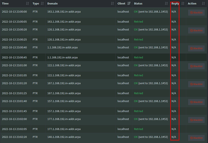

Conditional forwarding: pihole wants to know the hostname of an IP address, pihole sends a reverese DNS lookup (PTR record), DHCP server (router) replies with a hostname.
Pihole sends the PTR record to the router, the router doesnt reply with a hostname.
No replies (N/A):

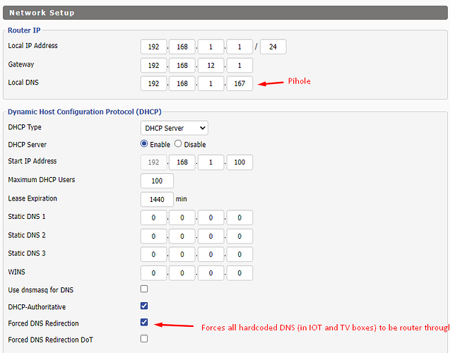

ddwrt settings:
to be routed through pihole*
I tried setting up the local domain to 'lan' or 'local' and tried to disable "forced DNS direction" and didnt work. I am not sure what DDWRT setting would make the DHCP server reply to the request. Sorry if this is more suitable for DDWRT forums
I don't use DDWRT, but have you tried to put the Pi-hole IP on the "Static DNS 1", under DHCP?

It would seem that your router doesn't supply an answer.
You may verify this by forcing a (reverse) lookup through your router at 192.168.1.1 , e.g.
nslookup 192.168.1.163 192.168.1.1
nslookup <some.host> 192.168.1.1
Substitute <some.host> by the expected hostname of your 192.168.1.163.
Please provide the full output of those statements, including the commands themselves, preferably as text.
rdwebdesign. I have tried putting piHole IP under static DNS but no avail. The only way I can get the hostnames to appear momentarily and the forwarded PTR (from pihole to router) to work is when I enable 'DNSmasq' in ddwrt. HOWEVER, when dnsmasq is enabled on the router, the router acts as the dns resolver and starts sending all other clients' requests to pihole under the router's IP. So, all my requests appear as if they came from the router.

Also consider that DDWRT has got a Forced DNS redirection option that could close a loop:
I found the solution. Following instructions from this thread, I set the following DNSmasq options on the ddwrt router:
server=piholeIP
cache-size=2048
log-async=5
#strict-order
dhcp-option = 6,PiholeIP
On the pihole, I kept these settings as usual
What solved the problem is to enable the DNSmasq ("use DNSmasq for DNS") on the dd-wrt. However, when that's enabled, the forced DNS direction doesn't work.
So, every month or so, I will enable DNSmasq on the router main page, let pihole get the hostnames for all clients, then disable "use DNSmasq for DNS". I'm happy having the list update once month. I don't have that many new clients anyway.
