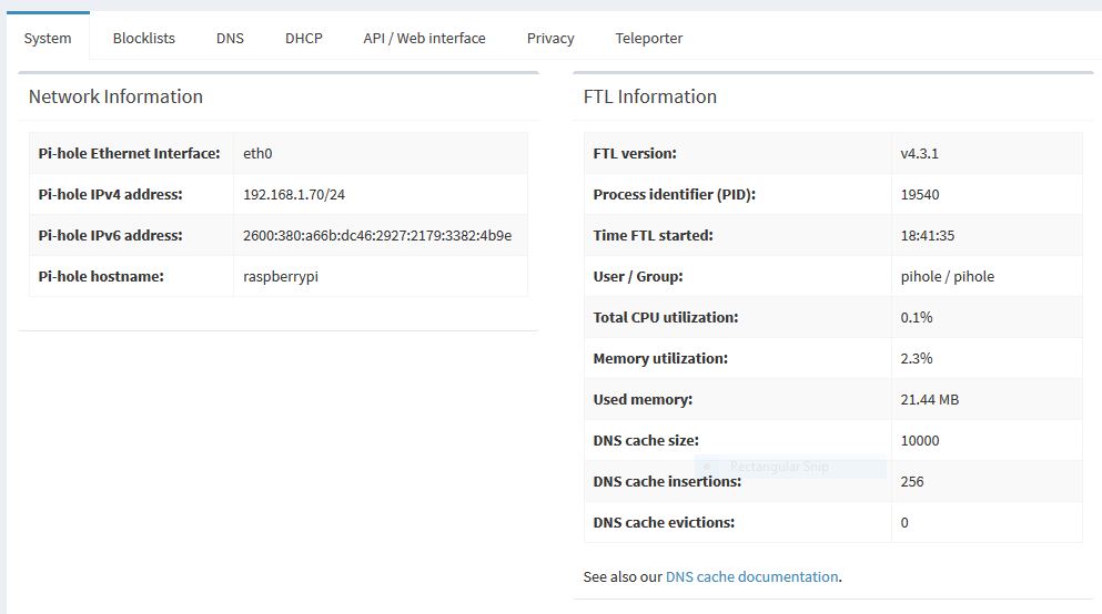

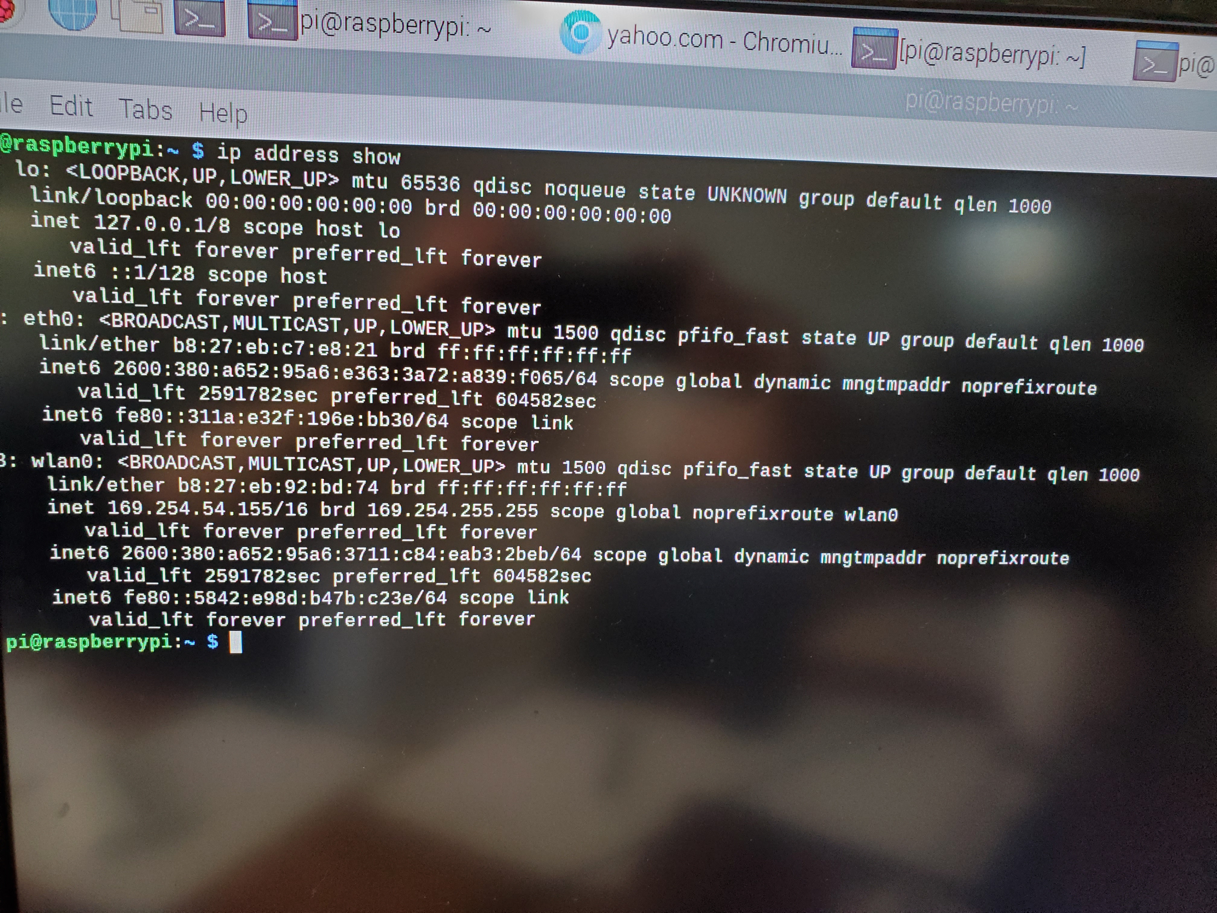

That shows your RPi to have IPv6 connectivity (deduced by a 2600:
prefix), but not IPv4 (by lack of 192.168.1.<x>

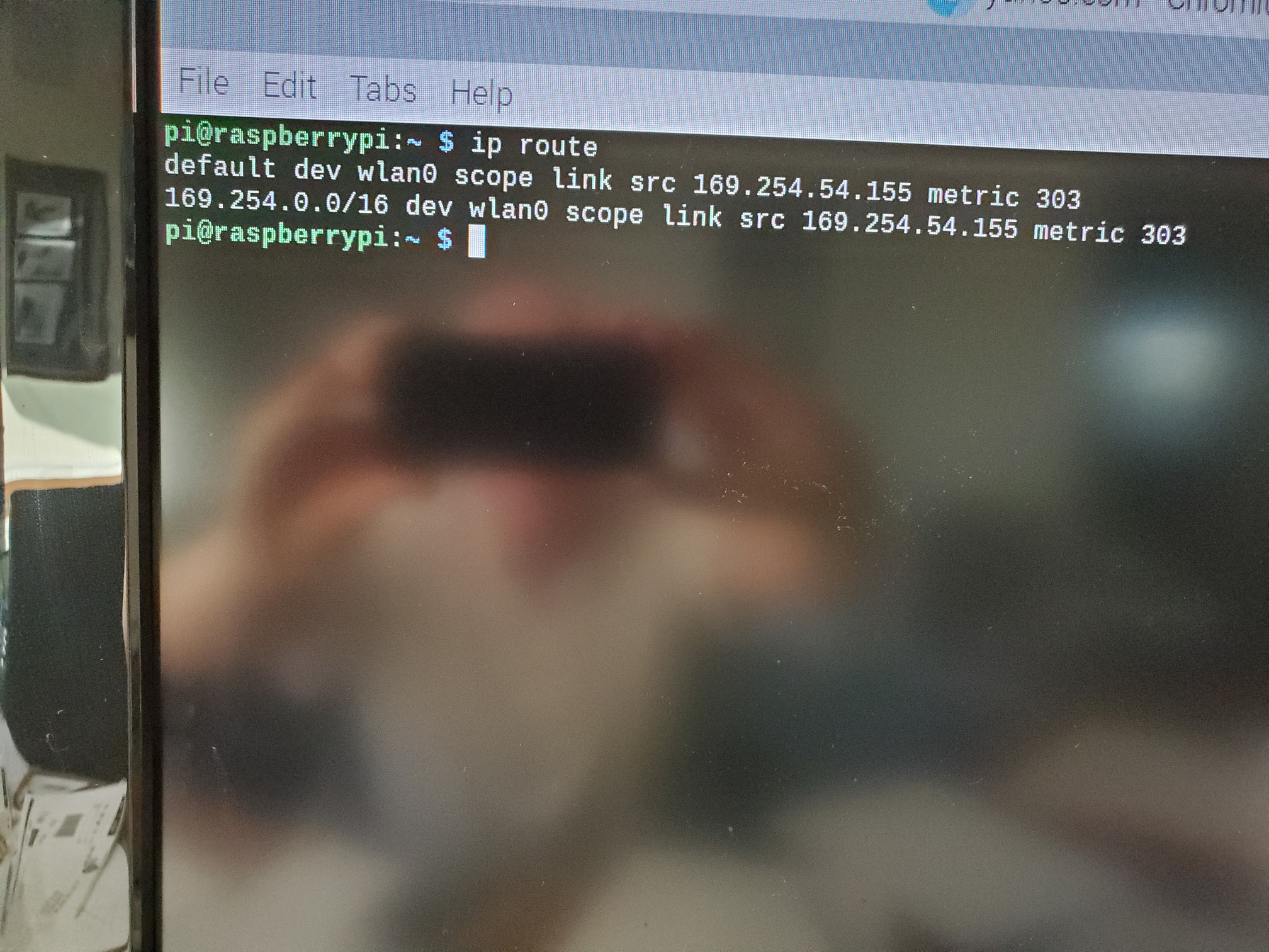

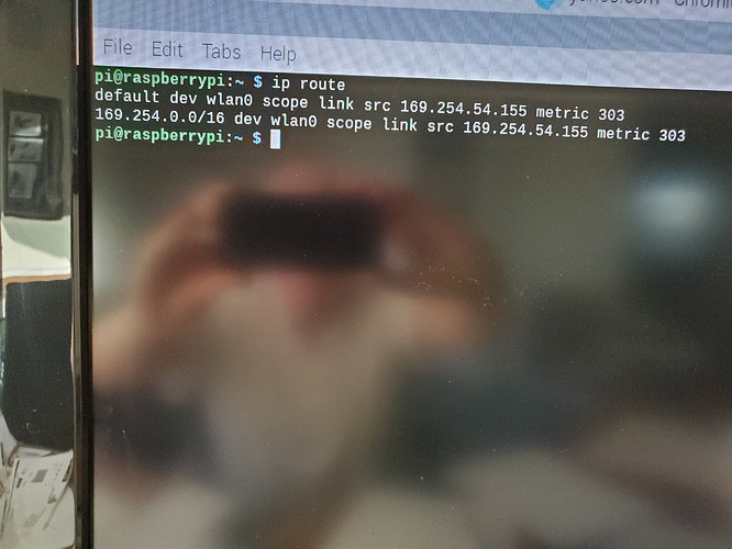

What is your RPi using as gateway?
We can find that out by executing:
ip route
Its output should contain a line starting with:
default via
What is the IP address that immediately follows after via
You have to reset your router.

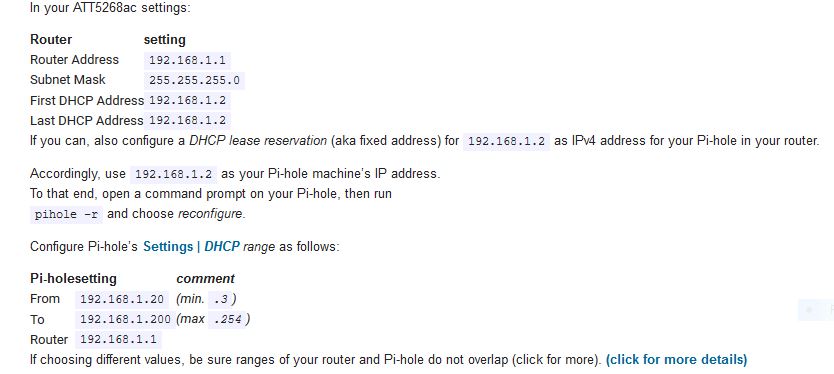

The recommendation for your single ATT router setup remain as before:
Restrict its DHCP range and have Pi-hole run as DHCP and DNS server.
But before you start a new attempt, please establish how you can set a DHCP lease reservation (aka reserved or fixed or static address assignment, or similar) on your ATT5268ac.
Then just configure an IP address via DHCP lease reservation for your Pi-hole - do not touch any other router setting yet.

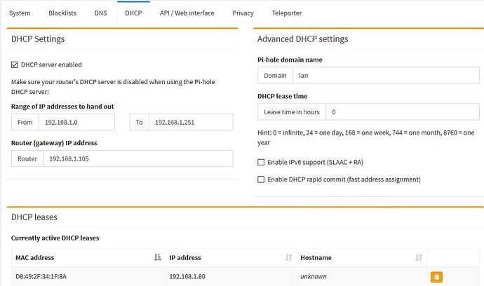

Have disconnected the 2nd router. I thought that it could be an alternative to the ATT router, since I'm not sure that it permits DHCP changes as needed for the PI-Hole. The last time we changed it, the ATT router failed . . . maybe coincidental, or problematic (See Below):
So, being "nervous" about possibly repeating the potential router failure, I thought that we'd try just changing the Gateway address (IPv4 Gateway) in my Desktop to the PI-Hole address and see if that connects to the PI-Hole (The documentation suggests this as an alternative when the router fails to permit the settings normally assumed by PI-Hole):
However, to do this, I need the PI-Hole IP address. Previously I'd use http://pi.hole/admin or 192.168.1.112/admin, for access, but it can't be found. It doesn't connect in any of my devices, or different OS. However, when activating the Raspberry Pi and mouse-over the internet I see two addresses ... 192.168.1.78 (lan0) for use with the router's network address (ATT6wQa4EC) and 168.254.54.155 (eth0). Does this help? Not sure what the 168.254.54.155 IP address relates to the network.

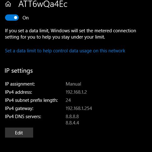

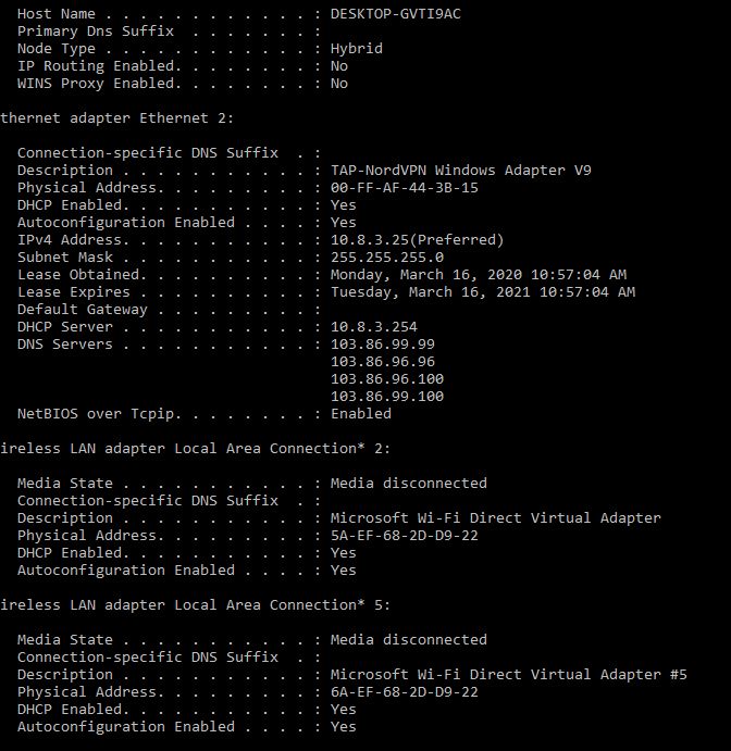

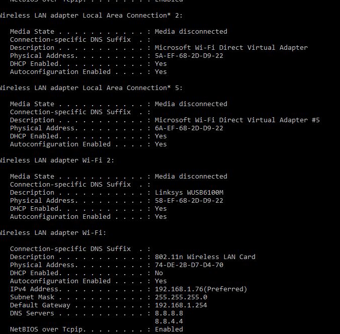

I'm suspicious that the PIH address has changed. I tried the ipconfig for info, but didn't help. Here's the ipconfig on my desktop:
Tried "ping -a pi-hole" with nothing found.
So, with your infinite wisdom, (1) does using the pihole address as the gateway make sense on an individual device? (2) how do I get the http://pi.hole/admin and/or pi.hole ip address?

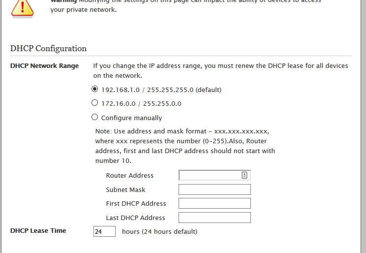

Ok. We're out of synch. I recited where there might be an opportunity to create a fixed address for the ATT5268ac
on the previous email, with a screen capture of were that might happen:
but also concern of whether it contributed to the subsequent router failure. If you'll remember, we tried that.
So, I suggested a link to the PIH directly from my desktop, changing the Gateway IP 192.168.1.254 to the PIH address, looking for your comments, but also don't have the PIH address and cannot seem to load the pi.hole/admin page, so I'm stuck.

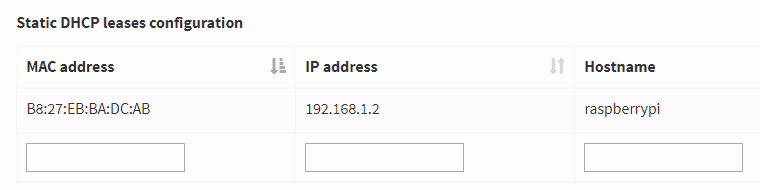

It likely did, as your WIndows PC seemed to have grabbed the singular DHCP lease from your router. Assigning a DHCP lease reservation for Pi-hole will avoid the latter.

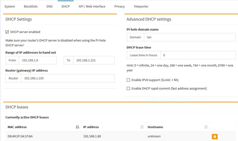

Those above screenshots of yours are showing DHCP range definition; they are not concerned with DHCP lease reservations / fixed or static IPaddress assignment at all.
Assigning your Pi-hole with a fixed IP address on your router would have to look similar to the equivalent section on Pi-hole's DHCP option pane:
You'd have to find the appropriate corresponding settings in your ATT5268ac router to configure a fixed IP address for your Pi-hole.

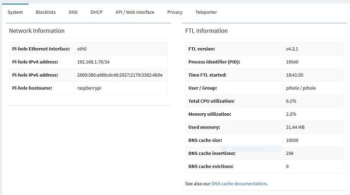

I've now successfully executed pihole reconfigure in RP and have:
Also have "Use as static network IP 192.168.1.70/24 and Gateway 192.168.1.254". And have "configure devices to
use PIH as DNS 192.168.70"

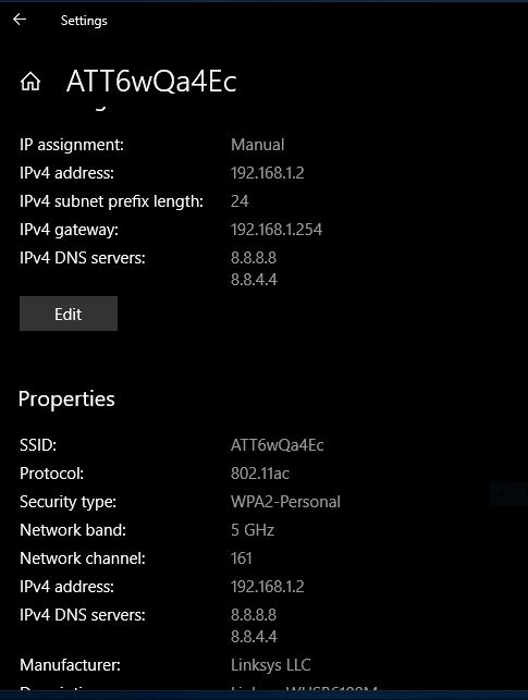

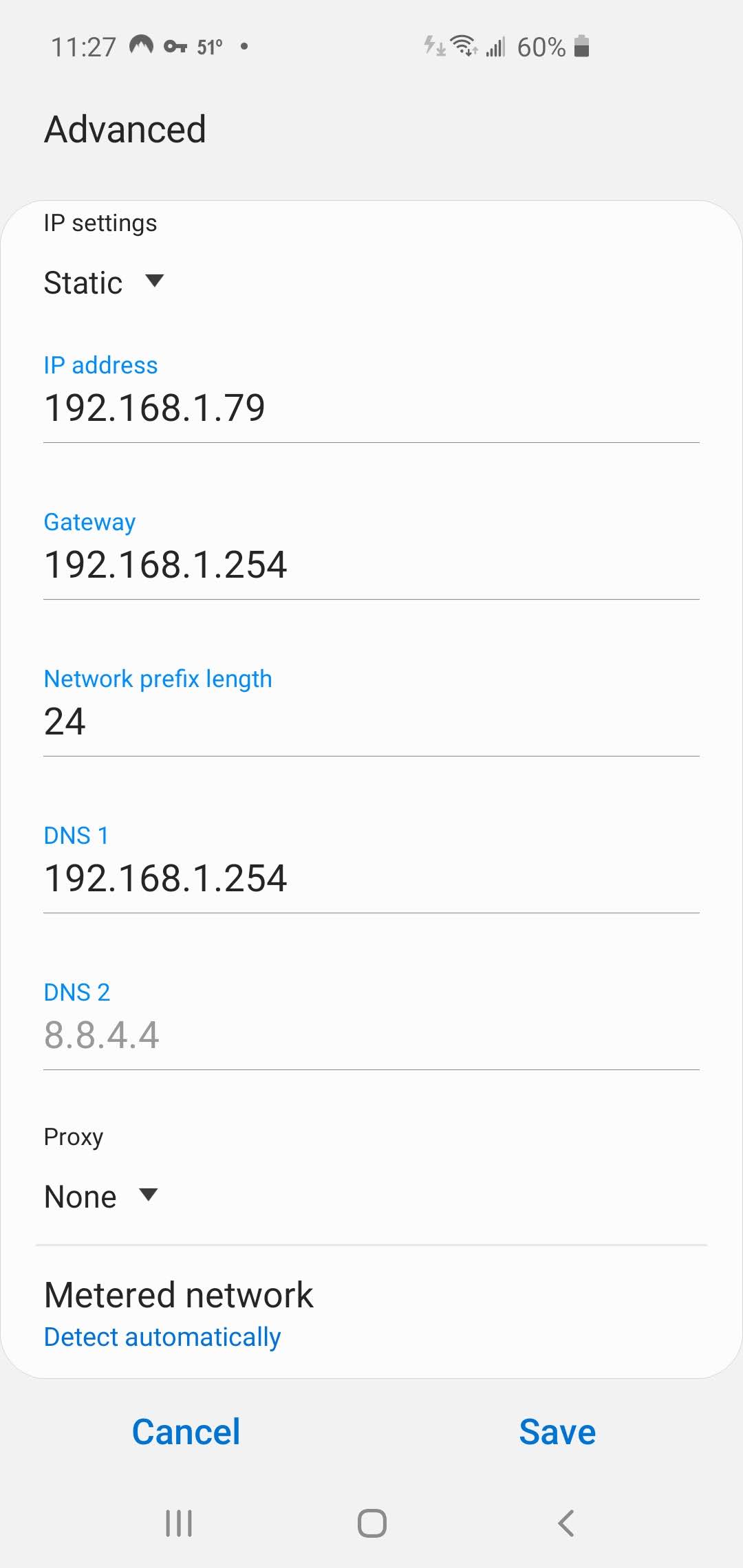

Yes, the PIH address is static. Why would it change if it's static? Next, is the DNS1 field the correct field to placing the PIH IP address? That would be in the DNS1 now 192.168.1.254 in the below screen shot from my cell phone?
It wouldn't, but your router may disagree with your Pi-hole taking it and refuse to forward traffic to it.
To avoid this, I would normally recommend to pick an IP address outside of your router's DHCP range for static IP addresses.
But I wouldn't touch it if it is working for you the way it is now.
Yes, those are the correct entries.
If your device allows, put Pi-hole in both slots.
Otherwise, it might bypass Pi-hole every now and then by using DNS2 as well.
