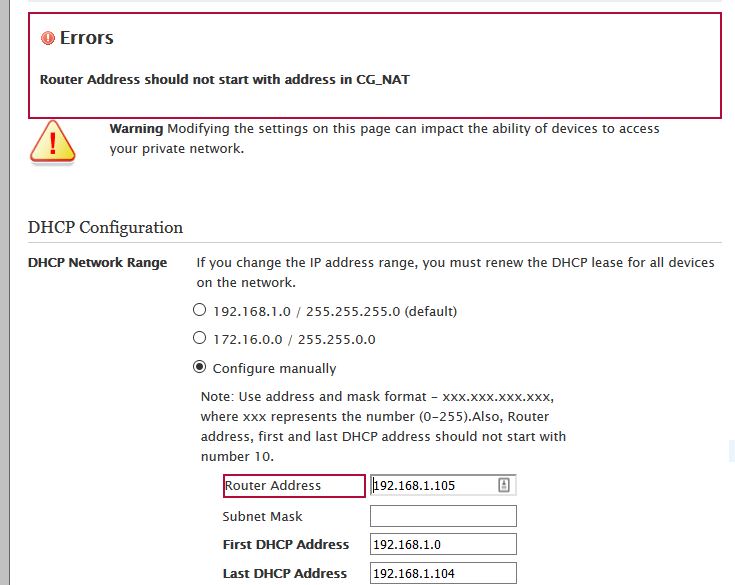

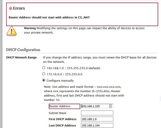

The Phole-admin now shows Router IP address 192.168.1.105, with an address range of 192.168.1.0 - 192.168.1.251, but no subnet mask. When attempting to create a static (manual) router address, I get a request for a subnet mask. When entering without a subnet mask I get an error "** Router Address should not start with address in CG_NAT**".
The entered router settings are:
Router Address 192.168.1.105
Subnet Mask
First DHCP Address 192.168.1.0
Last DHCP Address 192.168.1.251
What should the correct settings be? What would be the Subnet Mask?

I'm trying to configure my router (ATT5268ac) to the recommended PI-Hole settings to behave as a server. The installation of the PI-Hole yielded: IP Address 192.168.1.105, IP Address Range: 192.168.1.0 to 192.168.1.251, but no sub-mask. The DHCP settings in my router (ATT5268ac)
for changing it's address to Static/192.168.1.105 (PI-Hole source), requires (1) a router IP address, (2) a sub-mask address, and (3) the beginning and ending acceptable IP address ranges.
In order to accommodate the static settings and PI-Hole IP address as the default in the router, I accessed my router, tabbed to the DHCP setting section and entered the PI-Hole recommended IP address, beginning and ending IP address ranges, without the subnet mask, since I don't know what to enter. And, the error occurs, not accepting the proposed changed IP (PI-Hole) address.

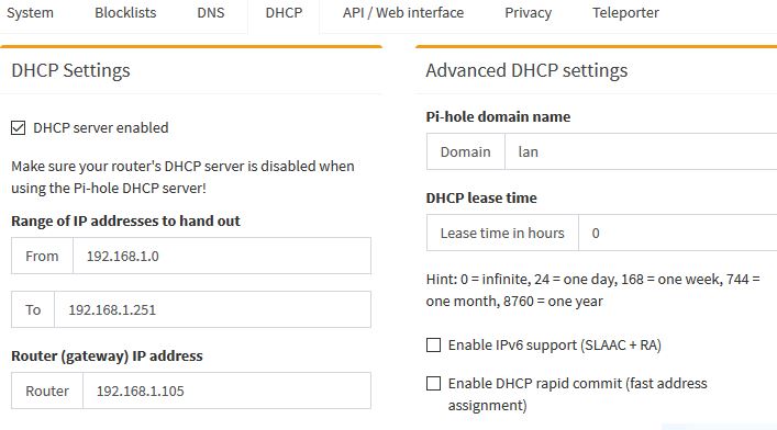

Here's the PI-Hole settings:
Here's the router change settings input section ( You'll note that I changed the "To" for the IP ending address range as a test to see if it would work in the attached image. The PI-Hole used 251 in the "To" ending address range - didn't work):
Thank you for the screenshots, that makes it a lot clearer.
As you have opted for using Pi-hole as DHCP server, am I correct to assume that your ATT5268ac router wouldn't allow configuring DNS?
When opting for Pi-hole as DHCP, it would be preferable that Pi-hole is the only DHCP server on your network.
Would you be able to disable DHCP completely on your router?

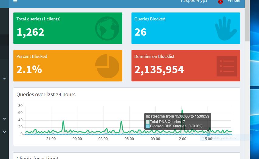

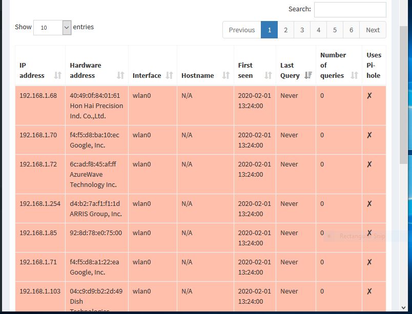

I don't know how to disable my router. However, I may be approaching this all wrong. All I'm trying to do is to insure that the PI-hole routes all of the device web access pass through it to block the ads, etc. I have 2 cell phones and two computers accessing the web via the router. Some of the traffic seems to be filtered via PI-Hole, based on the Admin page.
Here's the PIHole Admin Page (Note "1 Client"):

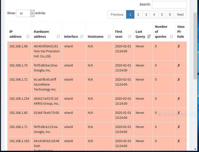

Here's the settings activity log, but note that the Number of queries is zero, although all of the devices have been active. The IP address for all devices are set to static.
Here's the other relevant PIHole page:

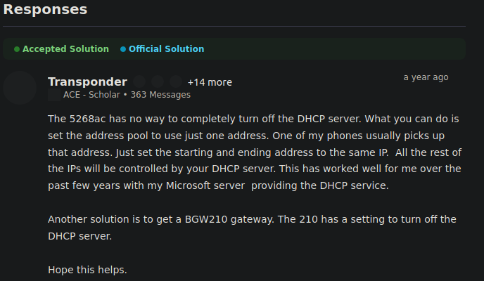

Did a quick search and found att-forum where the image below is taken from
From what i can tell from searching a bit, it seems like you cannot even change the DNS to a custom,
you can try the trick by setting DHCP range to a single ip address, otherwise your only option is to set your router to default settings and disable DHCP on pihole and individually set every device to use the pihole as the dns server. :slightly_frowning_face:

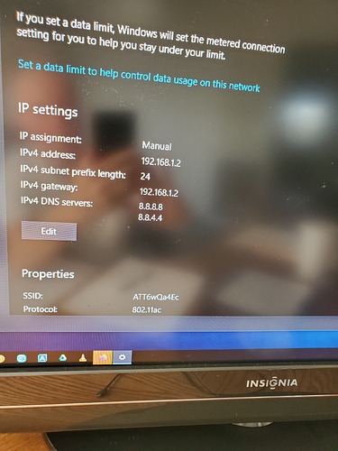

This being sent via cell phone data. Login on pc shows
What happened?
Your Windows device has grabbed the only available DHCP lease for 192.168.1.2 on your router's range.

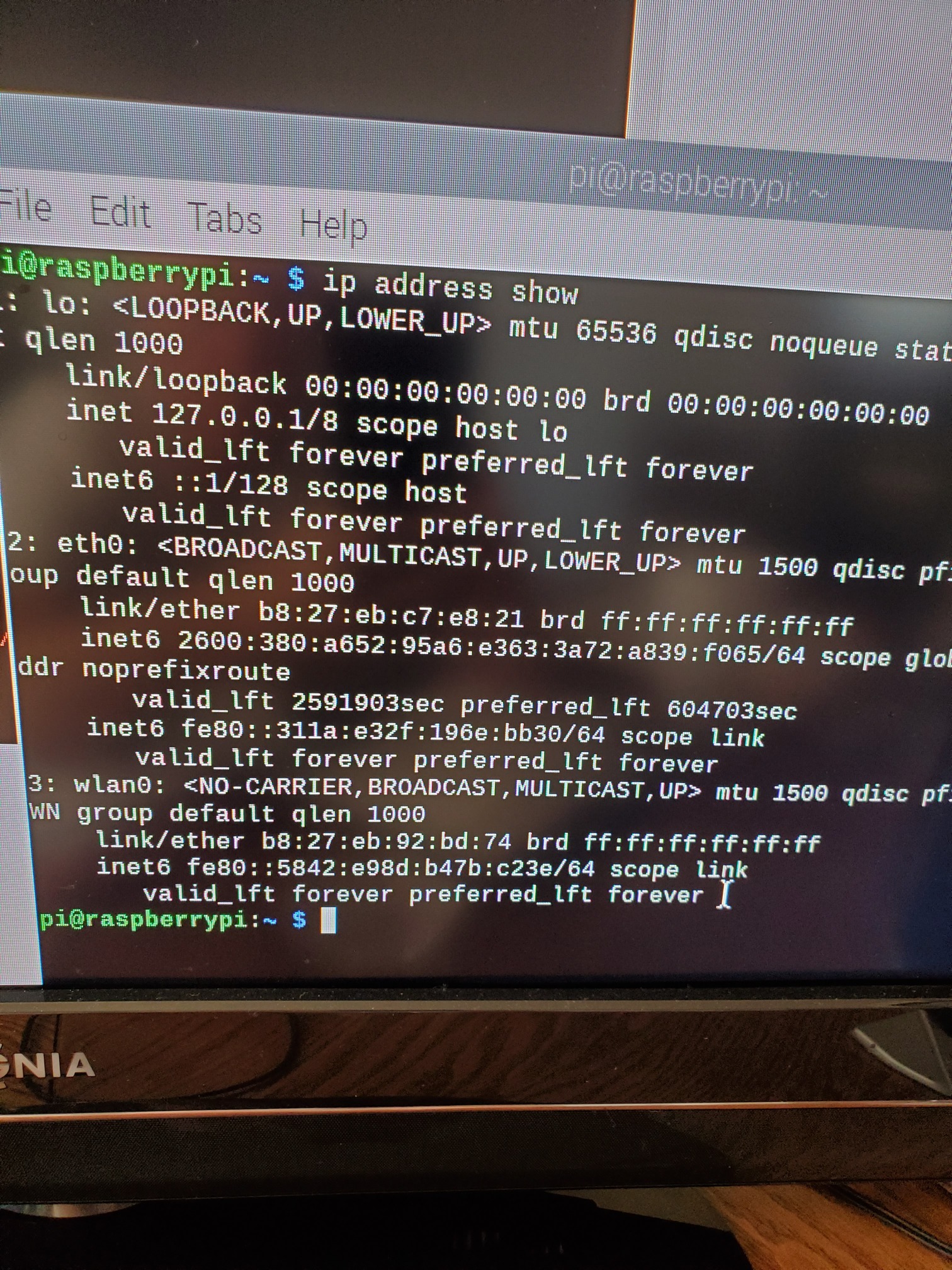

Run from your RPi, what's the output of
ip address show
Ip address show ...
