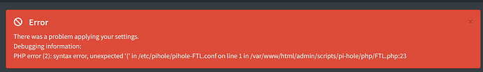

PHP ftl.conf error
Update went ok but atfer this in webadmin/setting I have this error...
Check the contents of your /etc/pihole/pihole-FTL.conf file.
It's complaining about a ( char on line one of pihole-FTL. I don't think it's a concatenation.
pihole-FTL.conf is ok... where is located setvars.conf?
What is the contents of pihole-FTL.conf, you really shouldn't have to put anything in there.
Actually, just run pihole -d and provide the URL token, we'll take a look.
The only thing that can be in that file is the actual configurations. You can't have comments. The file is not okay and everything but the last line needs to be removed.
It worked OK until today update with ANALYZE_ONLY_A_AND_AAAA and MAXDBDAYS uncommented
Remove the comments and it should work.
Yep. It worked! Thank you guys!
