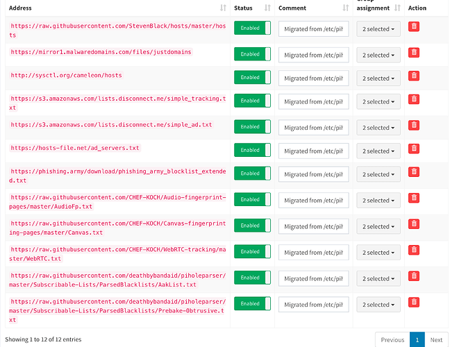

Here are my blocklists (adlists) -
(I can post this in text format if it helps)

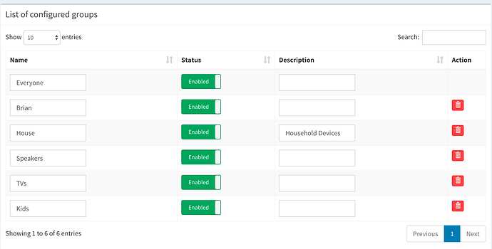

Groups:
- Mostly just for organization purposes, I'm really only using "Everyone" and "Brian" at the moment.

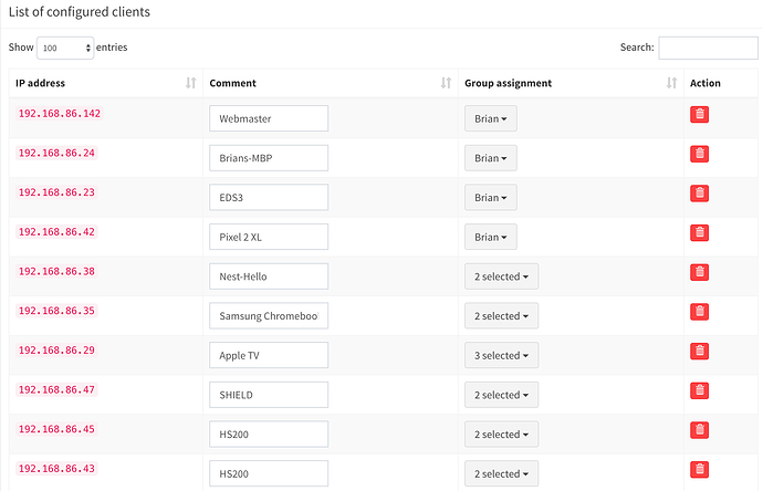

Clients:
- All clients are in "Everyone" except for the top 4, which are only in "Brian". I have 24 total clients, some just could grouped by device type (Example: Nest Hello could be in the "House" group)

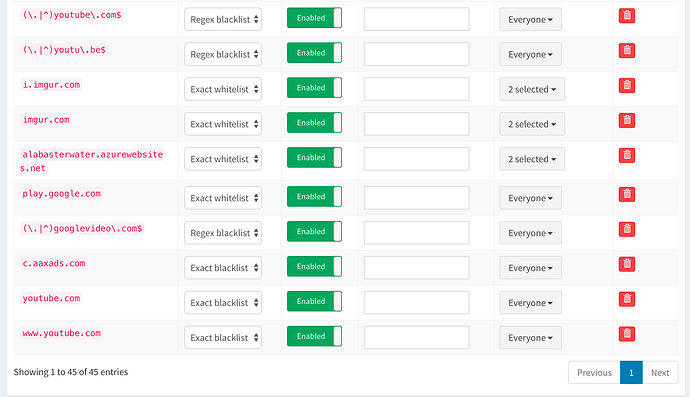

Domains: - This is the relevant portion of this list. Where it says "2 selected", I have "Everyone, Brian", the others are only applied to the "Everyone" group.

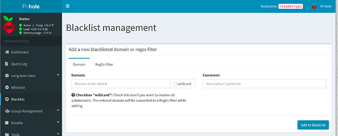

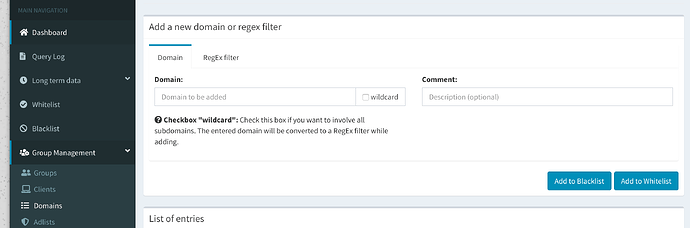

So, I added youtube.com to the blacklist from the Groups > Domains interface
Then, if I visit the main "Blacklist" page,
youtube.com shows up in the list, even though that's not where I added it.
There are no identifiers on this page showing that youtube.com is blocked only in certain groups, it just shows up as "blacklisted". If this list is applying to all requests "globally", then maybe this is where the problem lies. Otherwise, it's just a User Interface issue where it's not clear these domains have group policies applied to them. Ideally, this list is a global blacklist, that does apply to everything (sort of like your own personal adlist), and anything added from Groups > Domains does not show up in this list. Does that make sense?

That's expected. The blacklist is the same. Everywhere, this page is just the "legacy" interface if you want to call it like this. The group information is hidden to not overwhelm users not interested in the per-group features at all. Domains added through this interface are members of the default group (Everyone in your case).
Diagnosis by screenshots:
The client 192.168.86.1 is not known to Pi-hole:
so Pi-hole puts it into the Everyone group which is why www.youtube.com is to be blocked (see last row):
