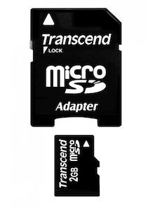

Are you using a SD card adapter to convert the little SD card to a larger size one for your reader?
If so, I'm wondering if the write-protect slider on the left hand side is in the lock position? I would expect this to cause any tools to report that the card was read-only, but it is feasible that a particular reader does not recognise this and so write operations appear to work but make no changes. Seems a long shot but worth checking.
I was actually looking for a tiny write-protection thing on the SD card thinking it might be something like that.
I've tried with two microsd readers, one being one where it's just a thumbdrive-looking thing, and the other is a USB-C SD and microSD card reader, so both just go directly to USB on the other end.
I did pop it into one of these to try formatting it in my camera, but that specifically has the write-protection off, as otherwise it'd be useless in a camera.
