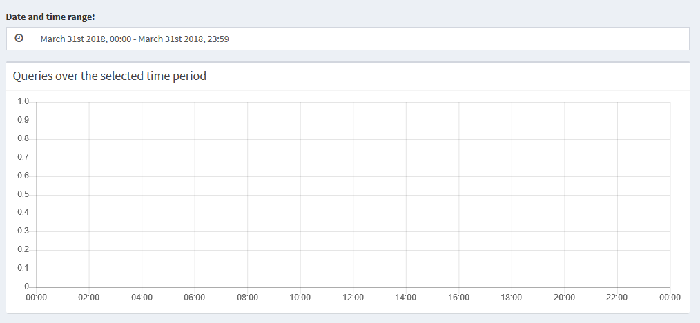

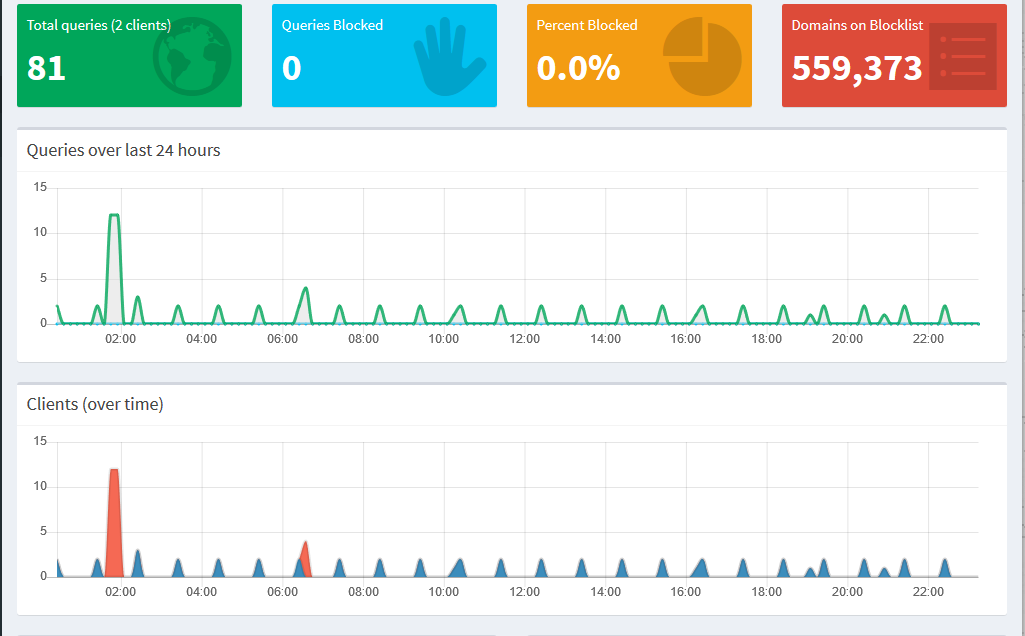

i am using a pihole for a while i recently updated to 3.3 and i have stopped it is not working any more. I have updated the dnsmasq as suggested but it is still the same. p
web ui is not updated not updated and I cannot see the ads are blocked. please see screenshot below

So according to your log (and screenshot), Pi-hole is working, but you don't seem to have any devices using it as their DNS server.

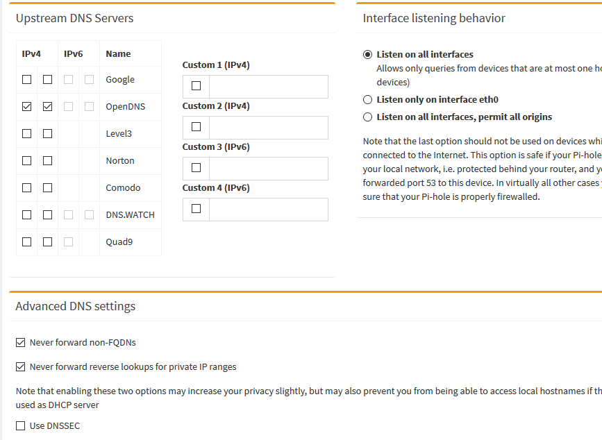

thank you for this but I do not think it is the problem as it was working fine before also all the settings are done properly. please see screens below.
when I tail the pihole.log. I can see entries coming to there as well.

I'm very confused now since your previous screenshot showed the Web interface working?
it is running but it is not updating the dashboard. I have flushed the logs and restarted the pi but no change. even after flushing it is showing the same as my screenshot also.

Which part of the graphs are not populating?
no graphs or statics are updating.
the data is still the same since yesterday and I have checked the logs they are actually populated.
Is it just the queries over time graph?
no, it is all the reports from web interface.
query log, top lists all is not updating.
